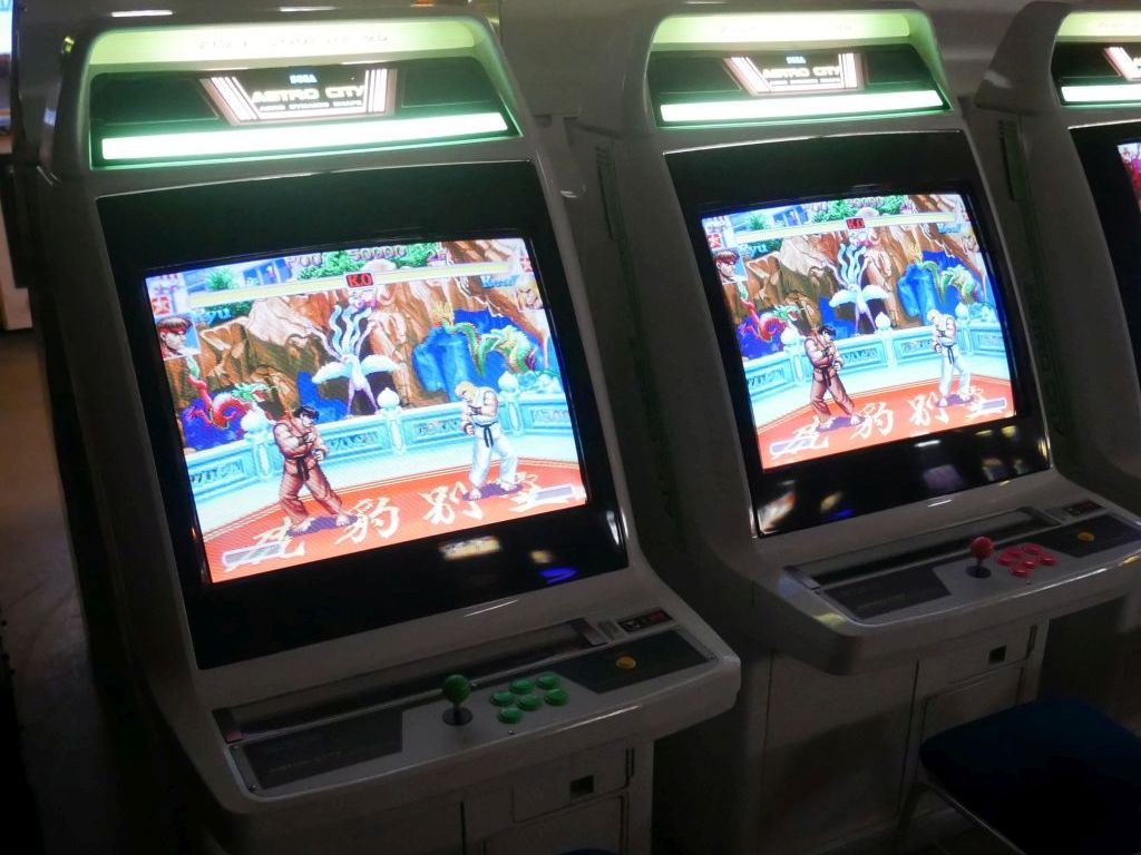

What cabs are you linking?
Nice. That's what I'm rocking as well. Astro City is easy. Just remove the PSU, turn it upside down, unplug the input connector that goes in to the power board, then put it back in. Everything else will work, it just won't put out DC voltage to the jamma connector.
Side by side Astros the best. I know head to head is the arcade hardcore way, but for friendly games it's nice to sit next to the people you're playing.
