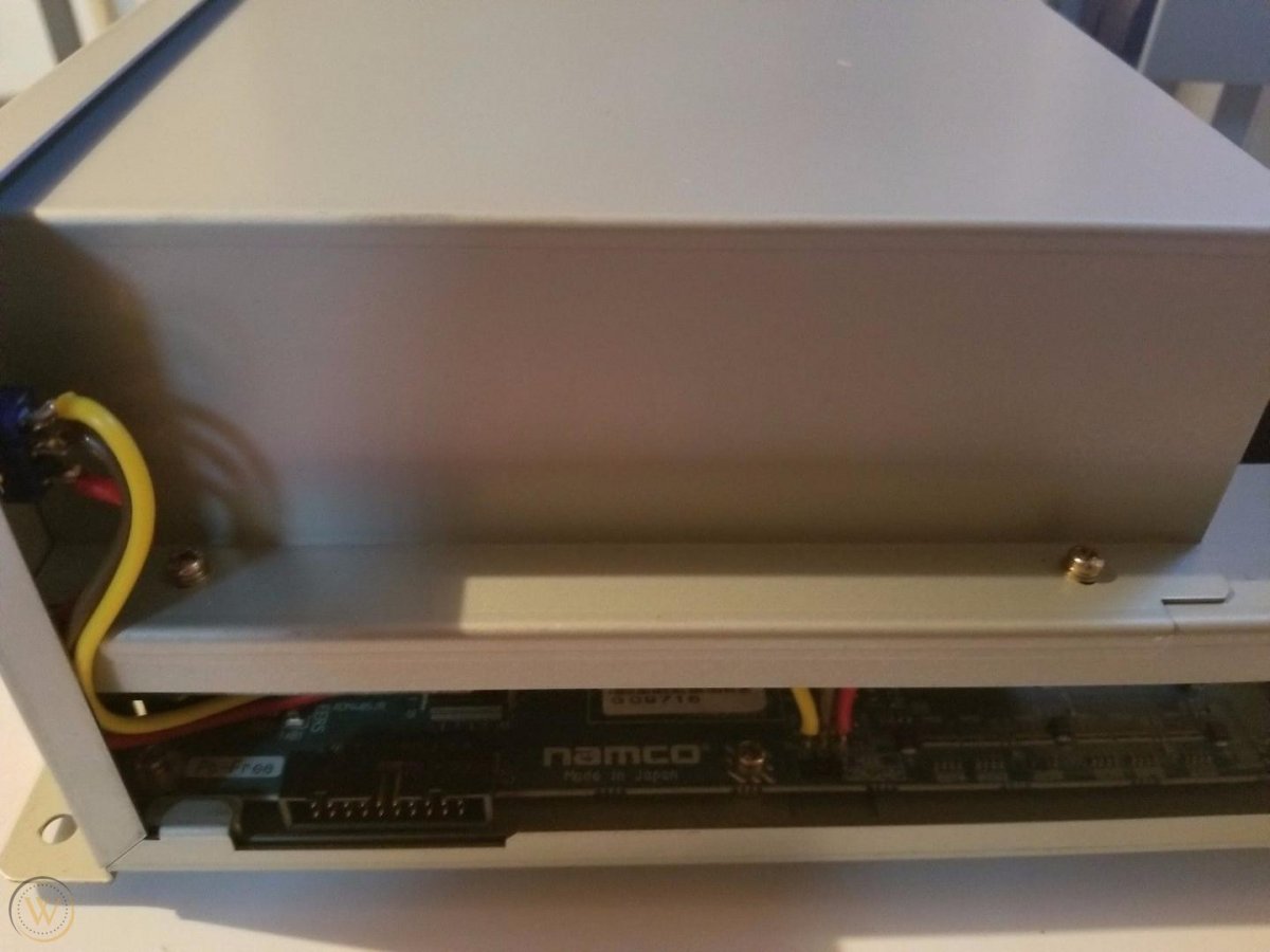

Has anyone here made a cable that goes from the 246/256 mode on the motherboard to a switch that they could flip to change the modes without having to open the unit? If so, where can I purchase one?
How do I do that? I have no soldering experience nor the equipment.You can wire up a switch like this so you don’t have to open up the system ever again.
Probably the easiest way is to get a 3 pin header and wire up a little 3 pin toggle switch, so that way you don’t solder the wires to the board.How do I do that? I have no soldering experience nor the equipment.
Do you know where I could find all the materials listed?Probably the easiest way is to get a 3 pin header and wire up a little 3 pin toggle switch, so that way you don’t solder the wires to the board.
I mean, it shouldn’t be to hard to find the parts online. But I can help you out.Do you know where I could find all the materials listed?
How much smaller should each piece be?I mean, it shouldn’t be to hard to find the parts online. But I can help you out.
Rocker toggle switch: https://www.ebay.com/itm/182710602493
Wire with pin sockets: https://www.ebay.com/itm/284221496341
Disconnect terminals(if you don’t want to solder the wires to the switch): https://www.ebay.com/itm/332320402390
Edit: you will need to find smaller disconnect terminals for the rocker switch. They can be found at your local hardware store or auto shop as well. Same thing with the rocker switch and wire if you want to start as soon as possible as opposed to waiting for the stuff to arrive.
These should work:https://www.ebay.com/itm/222428290533How much smaller should each piece be?
Would these suffice to go with your most recent link?These should work:https://www.ebay.com/itm/222428290533
Yes, these will workWould these suffice to go with your most recent link?

Oh, that’s a pretty neat idea, it should be fairly easy to execute.My personal goal is to not have it right up against the unit. I want it to be extended out like a cable so I can press it from several feet away from the cabinet. The video you showed me is pretty sweet, though. I do have the Ethernet port on mine.
Do I need anything to be longer from the list or am I free to get what we discussed already?Oh, that’s a pretty neat idea, it should be fairly easy to execute.
You might want to get longer cable, I think an Ethernet cable should work If you split the ends and connect them to the other cable.Do I need anything to be longer from the list or am I free to get what we discussed already?
I'm confused on why I would need to go that route. Can you explain more?You might want to get longer cable, I think an Ethernet cable should work If you split the ends and connect them to the other cable.
I’m just saying that only if you want to extend the cable some more, tbh, I really have no idea what you are trying to achieve at this point. I would also like to know some more.I'm confused on why I would need to go that route. Can you explain more?
Ah my bad. Hmmm...let me try to re-phrase and see if that helps. I'd like to put a toggle switch in place for the 246/256 mode so that I can switch between them but at a distance.I’m just saying that only if you want to extend the cable some more, tbh, I really have no idea what you are trying to achieve at this point. I would also like to know some more.
how long exactly?Ah my bad. Hmmm...let me try to re-phrase and see if that helps. I'd like to put a toggle switch in place for the 246/256 mode so that I can switch between them but at a distance.
6 to 10 feethow long exactly?
