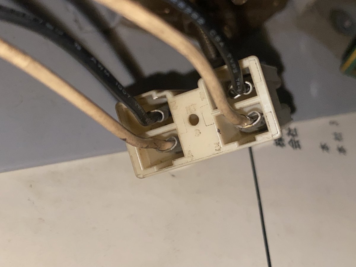

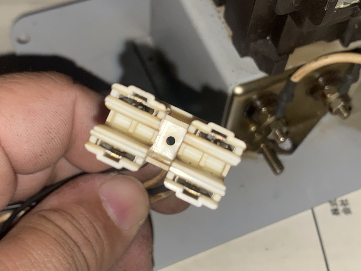

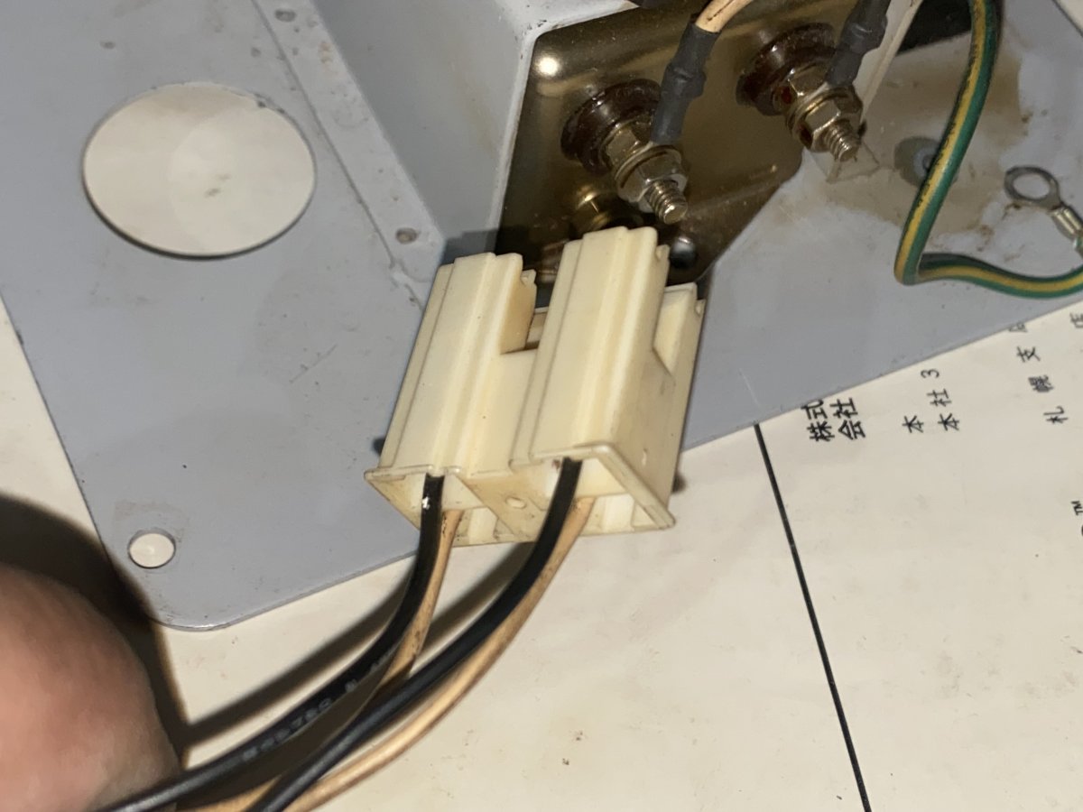

Hello, Does anybody know what’s the name of this kind of part? I could use some of these connectors. Thanks!

I don't think I've seen the 4-piece housing anywhere, but it's just four .250" (6.35mm) female spade connectors.
