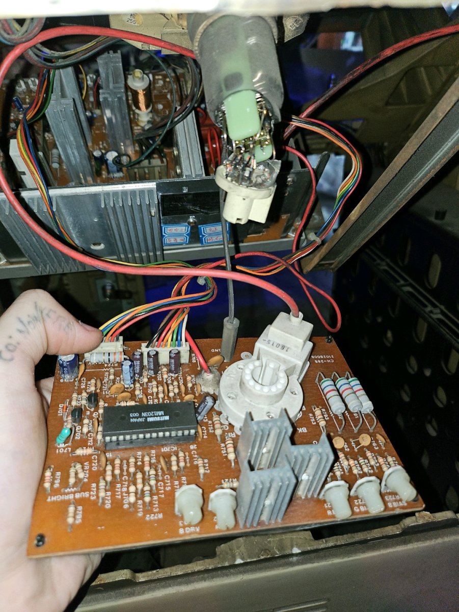

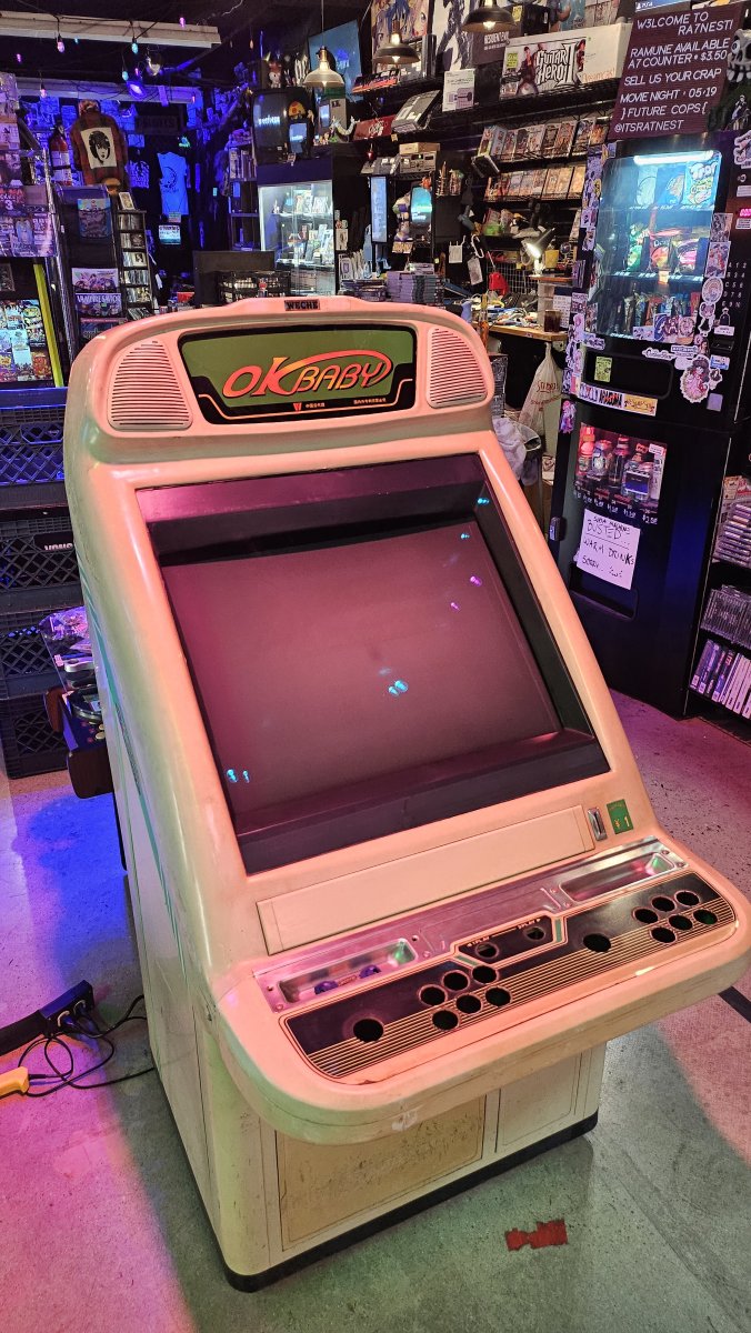

Howdy. Just picked up an OK Baby for dirt cheap only expecting to do some plastic welding on the body but seems like I have a bigger issue to resolve. REALLY do not want to have to replace the whole monitor. Looking for applicable replacements for the tube on this guy because all else seems... okay.
Very nice 29" flat panel when all is said and done...
Thanks in advance, y'all!

Oof. A quick glance on AP posts and google shows that the chassis is probably a clone of the Wei-Ya universal chassis, so a complete replacement is probably the best route if possible. Otherwise, it's a case of rolling the dice with random 27" TV tubes you can find and hoping the chassis and yoke is OK with it.
Alternatively, you can replace it with a Unico ULM26 LCD screen. They are somewhat derided for scaling issues and some initial snafus in terms of claimed resolution, but they perform decently in terms of lag and sync capability (15-31khz compatible). I can bring mine into the shop for you to try if you want to take a look (I know Rat Nest when I see it!). It's light enough that it would make rotation pretty easy too.

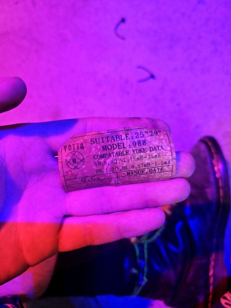

The yoke specs definitely align with some consumer TV tubes. That's an option.
Lh 0.97-1.5mH
Lv 15-25mH

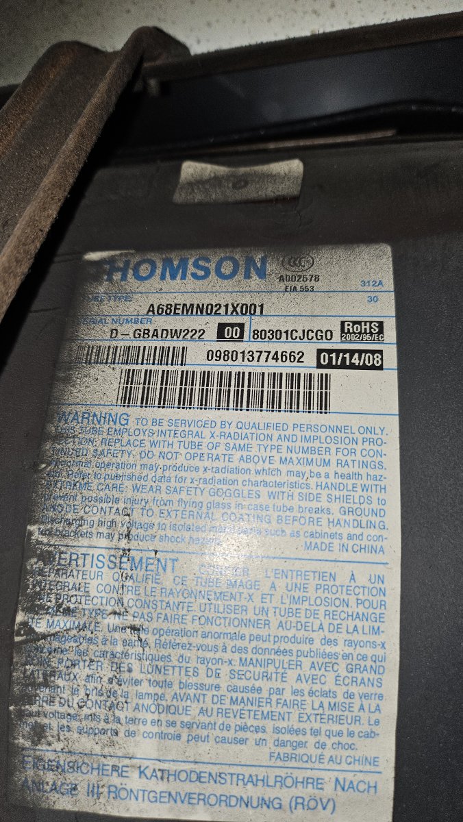

so i had a feeling this may not be the original monitor in here... first time seeing this... homson? is this normal for an ok baby? i mean regardless, just hoping it's far more of a common tube to replace.
the person i got it from also told me it wasn't shpposed to have a broken monitor so they're also trying to help. thankfully...
Lh 0.97-1.5mH
Lv 15-25mH
hopefully these still line up with the monitor in here...

lmfao i just realized it says "THOMSON" not Homson smh
These originally came with either Ducksan or Hantarex monitors afaik, and curved--not flat. Someone swapped the monitor for sure.
It's a clone/rebranding of the common Wei-ya universal chassis. The sticker you found says the acceptable ranges for the yoke's resistance and inductance. Assuming the chassis works, I would advise picking up a meter which can measure inductance (I use this one) and checking the yoke of some random 27" TVs. Luckily, these universal chassis are designed to work with the range found on typical consumer TV yokes, and do not require low-inductance yokes like the Nanaos etc.
