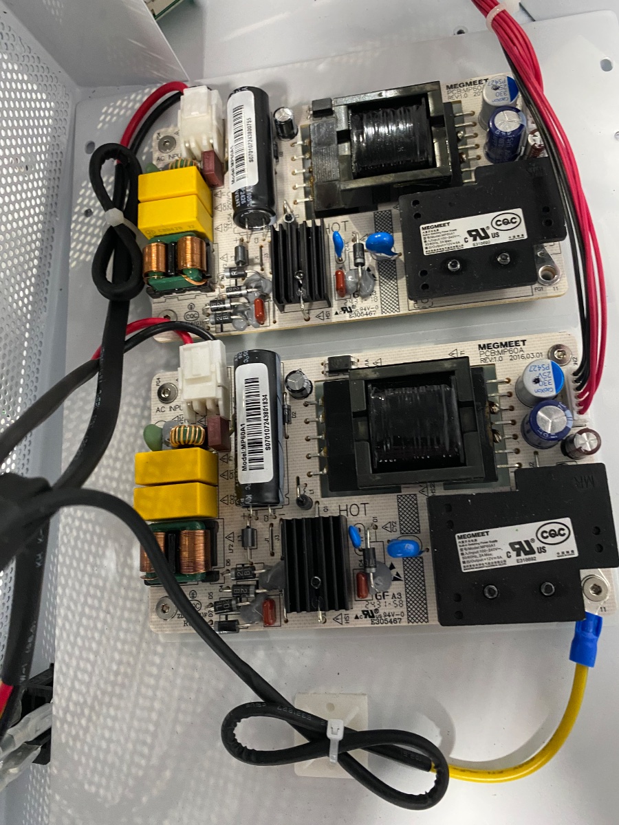

From what I have found though there is a catch… the PSU is not UL/CE certified or seem to be adjustable in anyway for +5v rail.

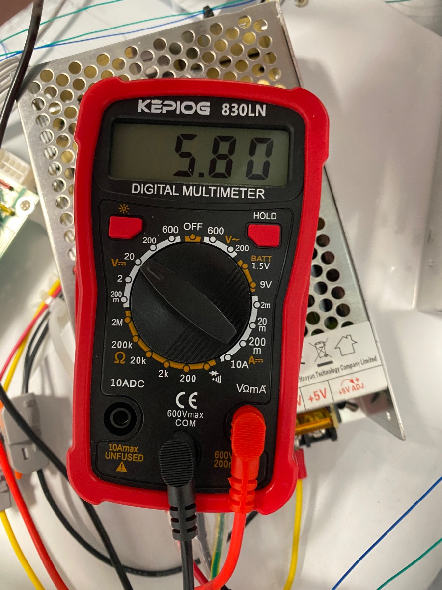

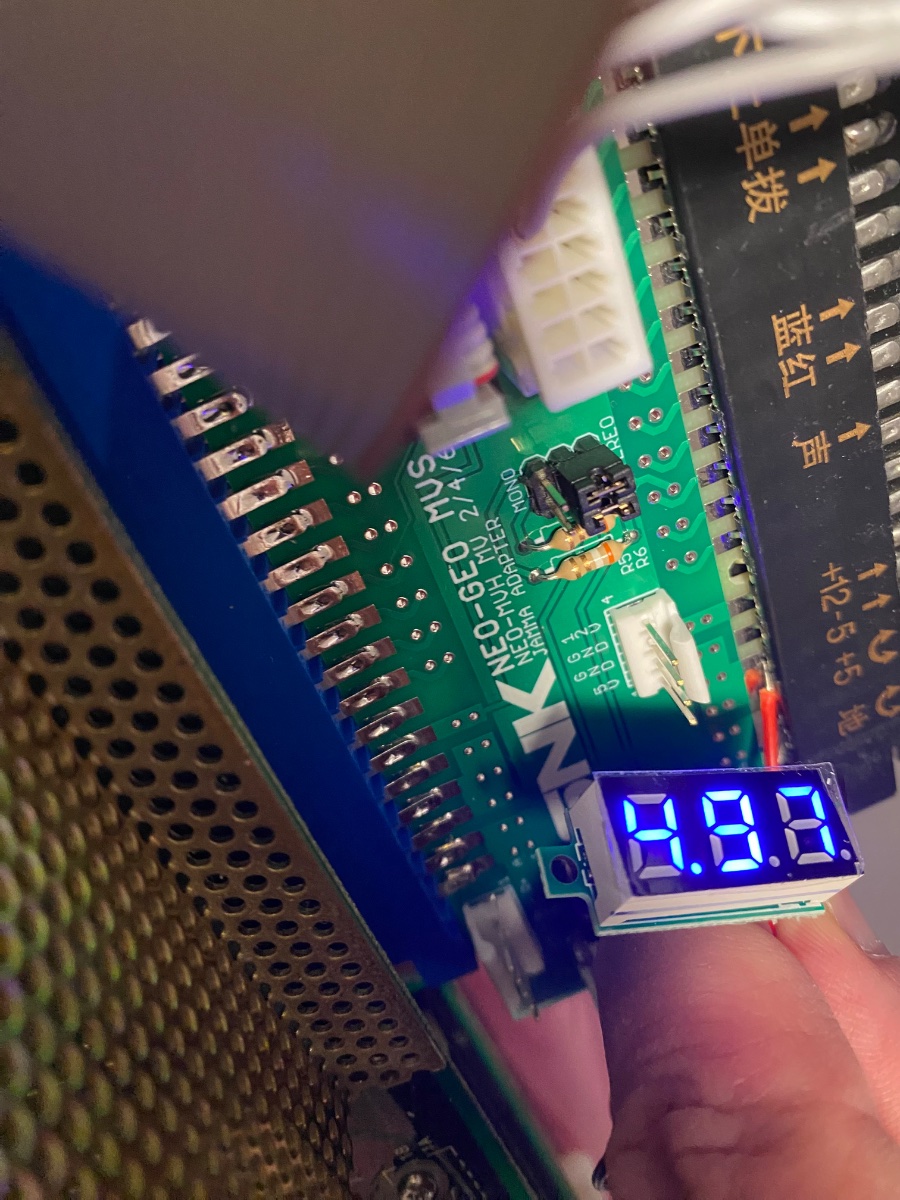

In working with ack he suggested a do some readings with a meter. With Dogyuun attached to the harness I had 5.22 going in and 5.13 at the board. With my MV6 attached I was at 4.03 going in and 3.83 at the board. I expected a dip for the MV6 I did not expect Dogyuun to be sitting so high in the tolerance window…

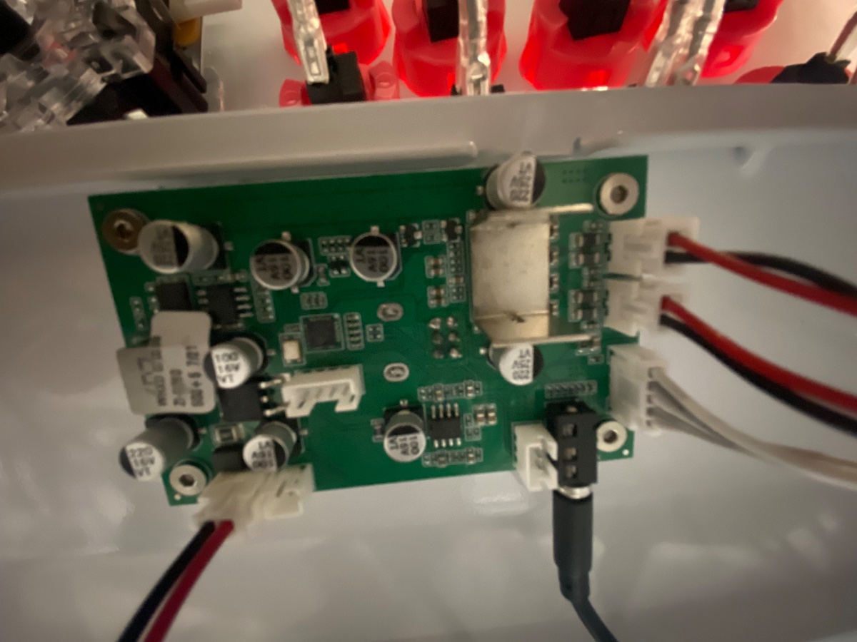

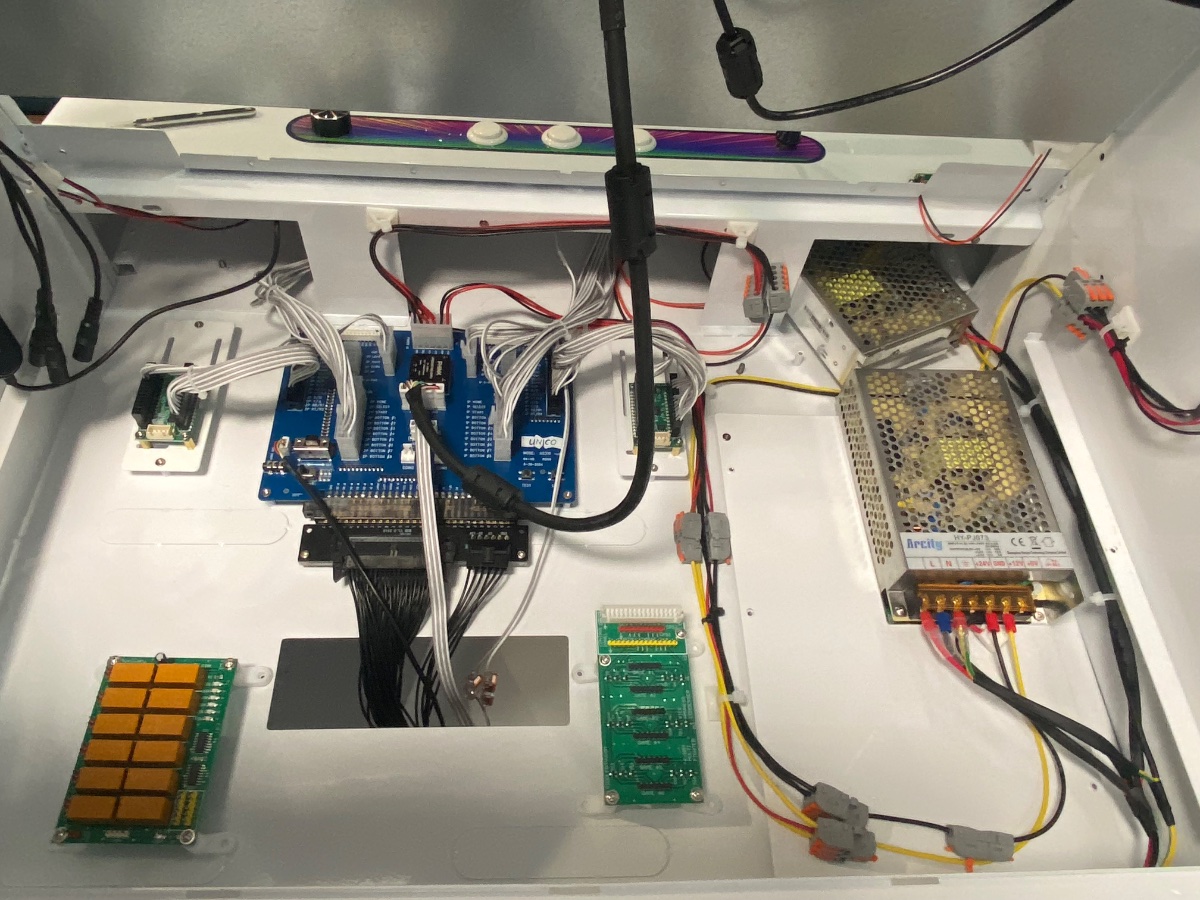

What is a boy to do? I decided to photograph and begin tracing out all of the cable runs in the cab. Most of the connections are JST. My thought process was to repurpose the existing amp, control board and install a proper PSU and wire a breakout board as needed.

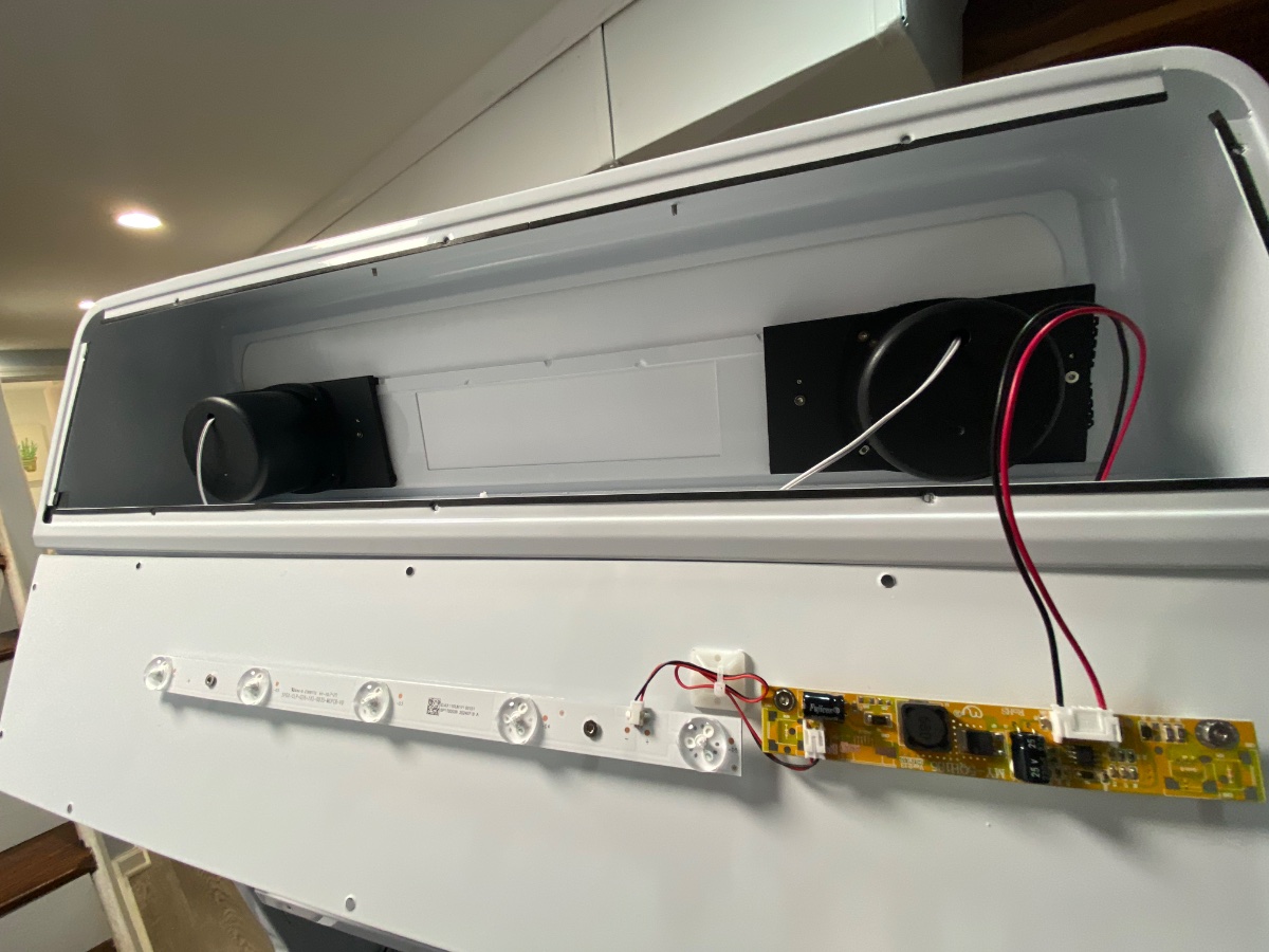

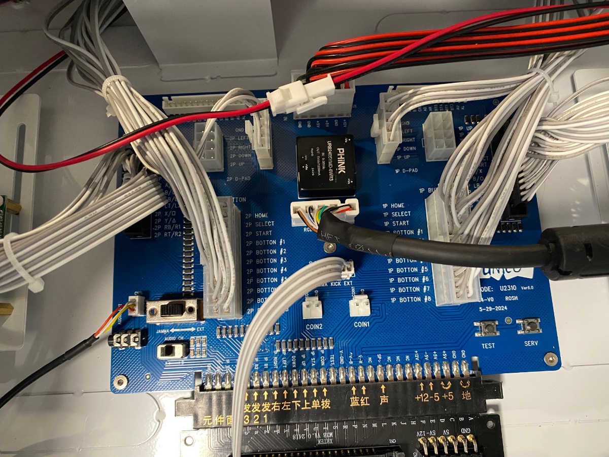

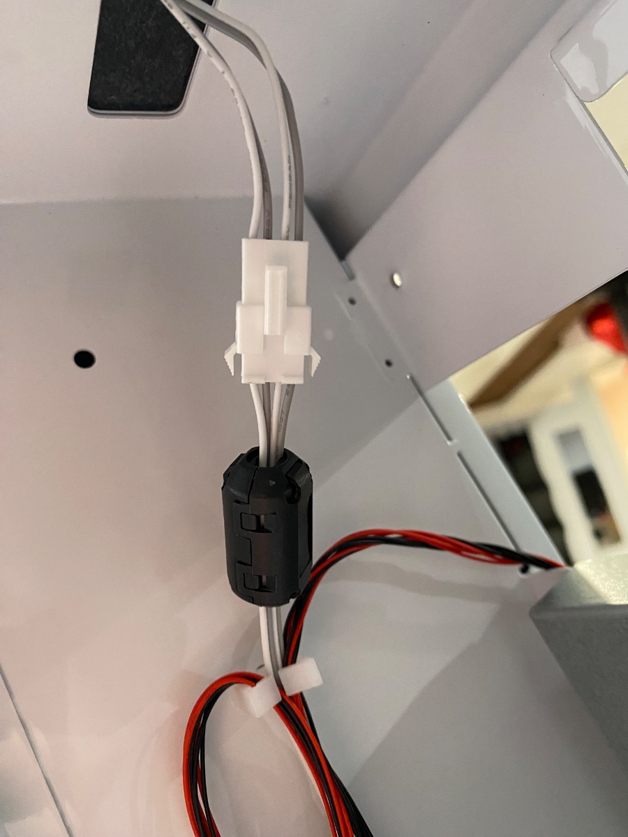

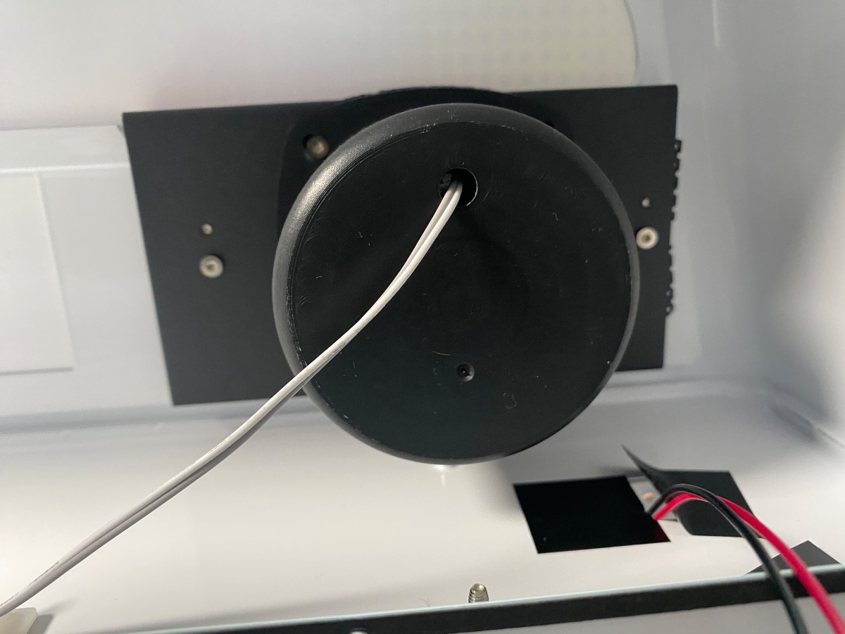

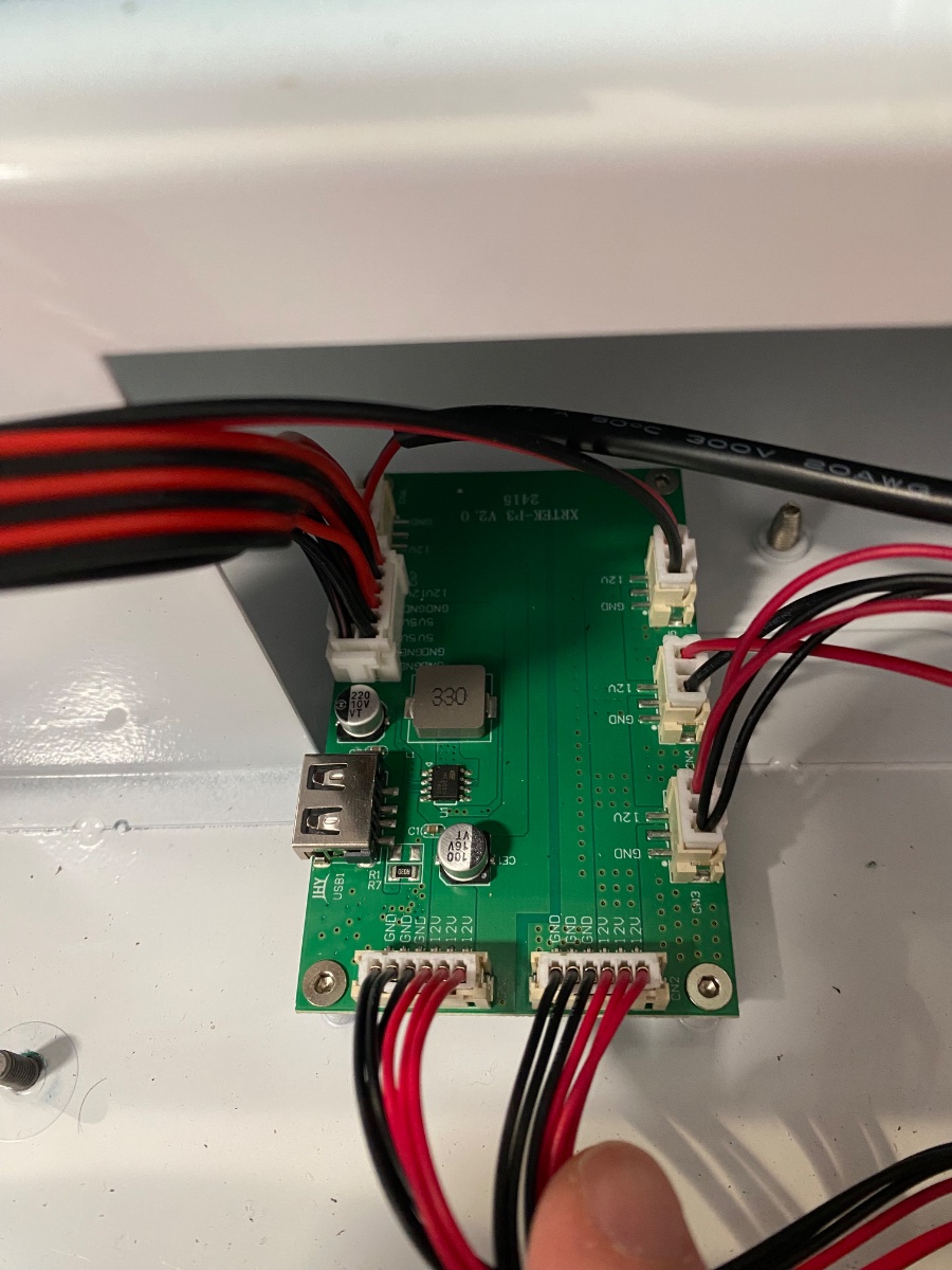

Photos attached of the NovaBlast wiring. From the external power cable plug > the the PSU > to the breakout board > to the control board > (off breakout) to amp > two connecting cables up to speakers > (off breakout) to LED board for marquee.
Will work on a diagram to upload as well.

I don't do much with cabinets so take this with a grain of salt.
You are going to need to tweak 5V on the arcade power supply depending on which arcade board is connected. If the arcade power supply is also powering the unico you risk sending to much voltage at the unico side if your 5V adjustment is off (or if you power it without an arcade board connected).
If it was me I would have the arcade power supply dedicated to powering the arcade board. It looks like there is a jamma extension cable with a 40 pin (?) connector for data pins and 6 pin (?) connector for power/ground. I would disconnect unico side of the power connector and wire it up to the arcade power supply, then only have a ground connection from the arcade power supply to the ground pin on the unico side so they have a common ground.
this is very sound advice.
a lot of modern cabs like Vewlix have a dedicated PSU for the cab and a second PSU for the game board for these exact reasons.

Appreciate you weighing in lol especially for the call out of the LCD PSUs. Clearly not what was advertised.

I did purchase a PSU with a 5V potentiometer. Its output is 5V/10A and 12V/12V. I wired the 12 pin connected on the Unico board which is feeding power to the Jamma harness to the 5V, 12V, and ground respectively. I also wired the speakers, and the display to 12V and Ground last night. Ack has been kind enough to be going back and forth with me in DM and I understand now breaking out the power supply for Jamma and other components should be done.
Do want to ask with the potentiometer only adjusting 5V and the Jamma being the only thing that is taking the 5V should I have any concern of potential damage to the 12V components?
