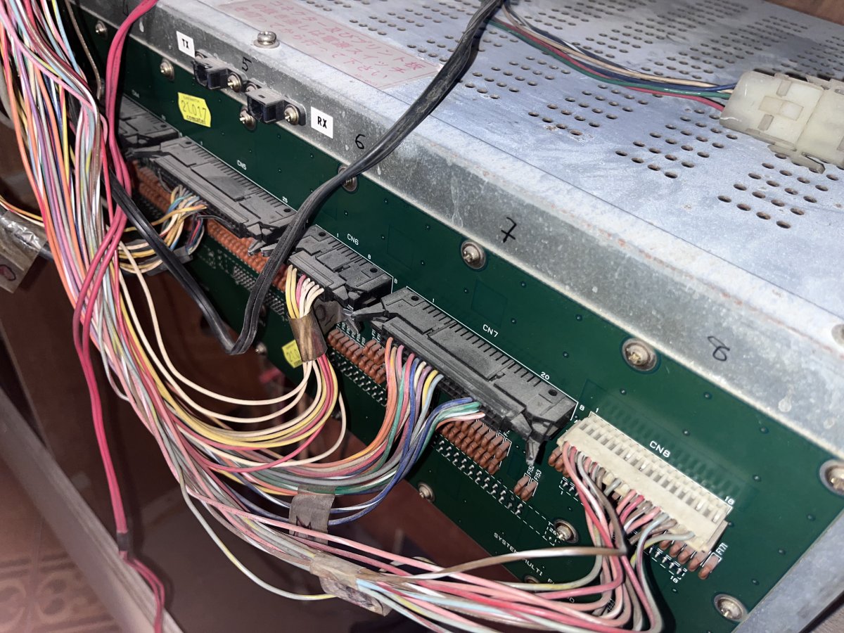

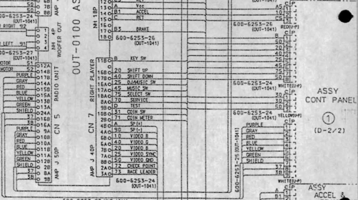

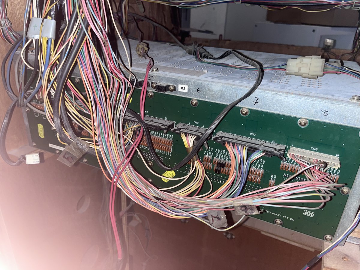

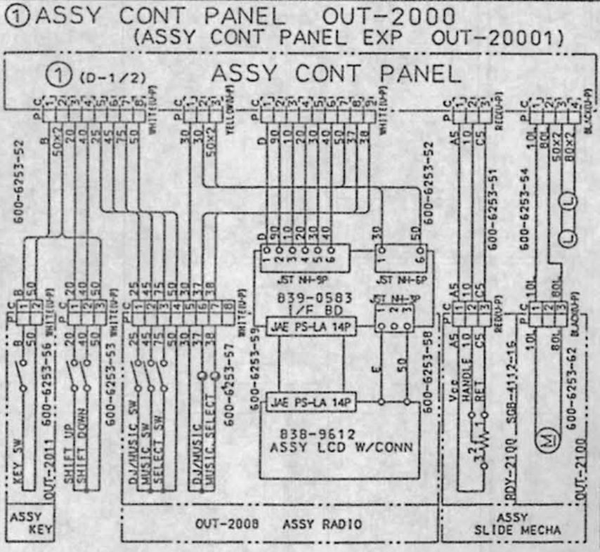

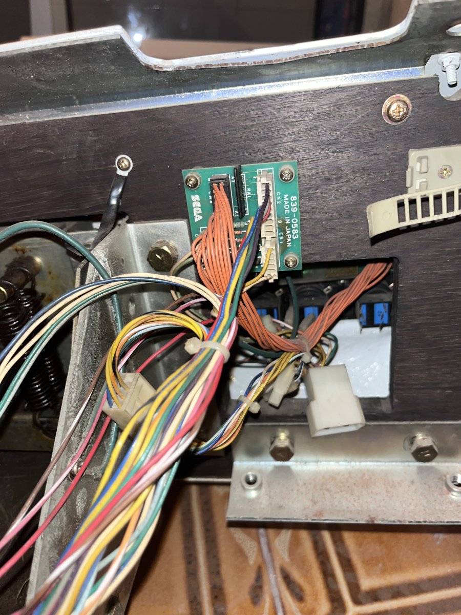

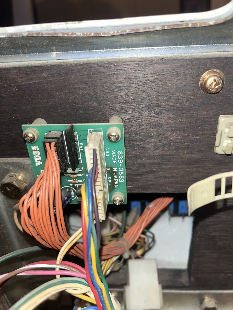

I have the PCB, the Radio Control with Display and the PCB without any wires. I had a look at the schematics but I don't know how the 14 Pin display connector is being accessed by the Main PCB.
So if anyone could help me figure it out who owns one of these machines I would be very thankful! I'll build a small Radiobox out of it and put it on my Rad Mobile Deluxe whenever Rad Mobile gets old ;)

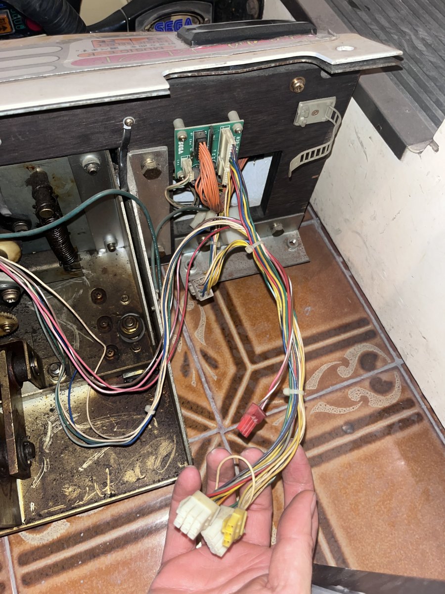

Thanks mate. That should help me figure it out. Can I get a close up of connector 5? I need the cable colors! Too bad I cannot find the necessary parts to build the orange cable. Gotta try that with a JTAG header then. Again, thank you Galileo! <3
BTW: If anyone needs this - I have the Outrunners Main PCB running in my Rad Mobile DX cab and it's almost plug and play (directly connected to the Jamma edge). You have to disconnect the J Pin on the jamma connector from Rad Mobile, and cut the K trace on the Outrunners PCB and jump it to ground. These two connectors are used as outputs (Race Leader and Checkpoint Lights) by Outrunners but are the Audio mute (hence connected to ground) and Coinmeter 2 on the Rad Mobile side of things. Unfortunately due to the nature of how Outrunners works you'll only get mono sound through the speakers once you hit start.(sometimes you can hear player 2 crash and drift on the second speaker...) If I am wrong correct me on this. I used the 4 pin woofer connector as the Rad Mobile cab has a 4 pin connector.
I have the board but I am missing the cables. I already traced all the connections with the schematics yesterday - I just want to make sure. I am running the whole thing without the filterboard so there are some differences. I connected to the DIN 50 Pin connector that drives the outputs but couldn't get anything on the radio lcd. Maybe the dupont connections I am using right now don't have contact or I am missing something.
