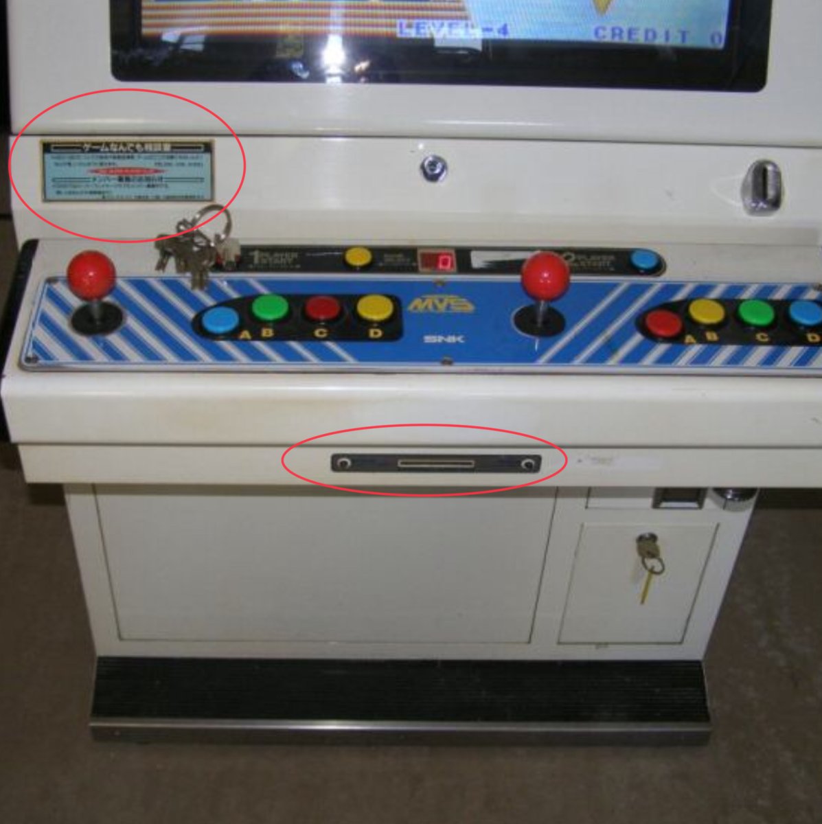

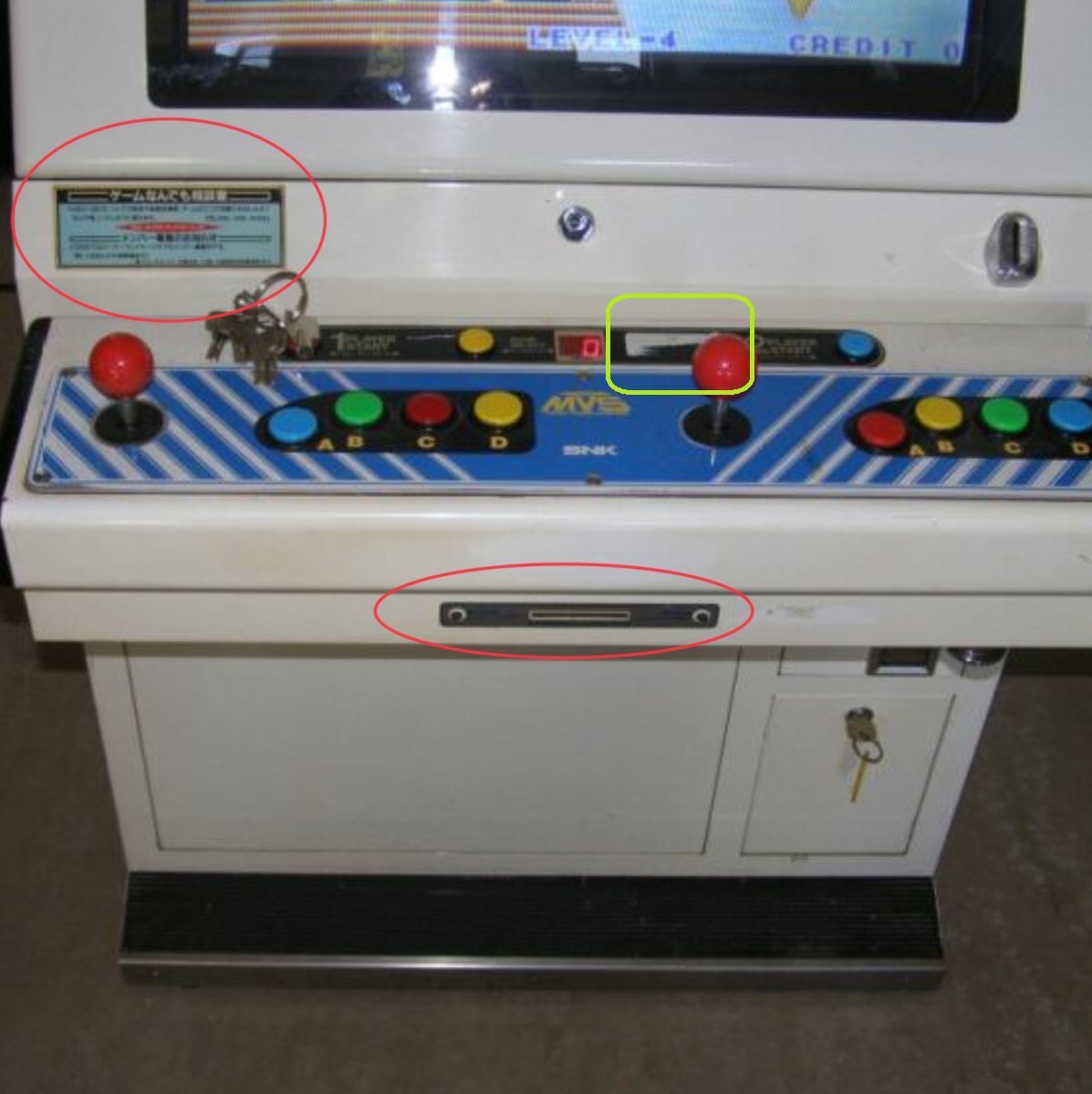

Hello BuddyC:
I know this is an old thread, but for the last 2 stickers, I was able to figure out where the small one goes, while still looking where does the second one (the one with the finger) would actually fit.
I have attached a photo for the smaller sticker as where it is supposed to be. I have highlighted it in green.

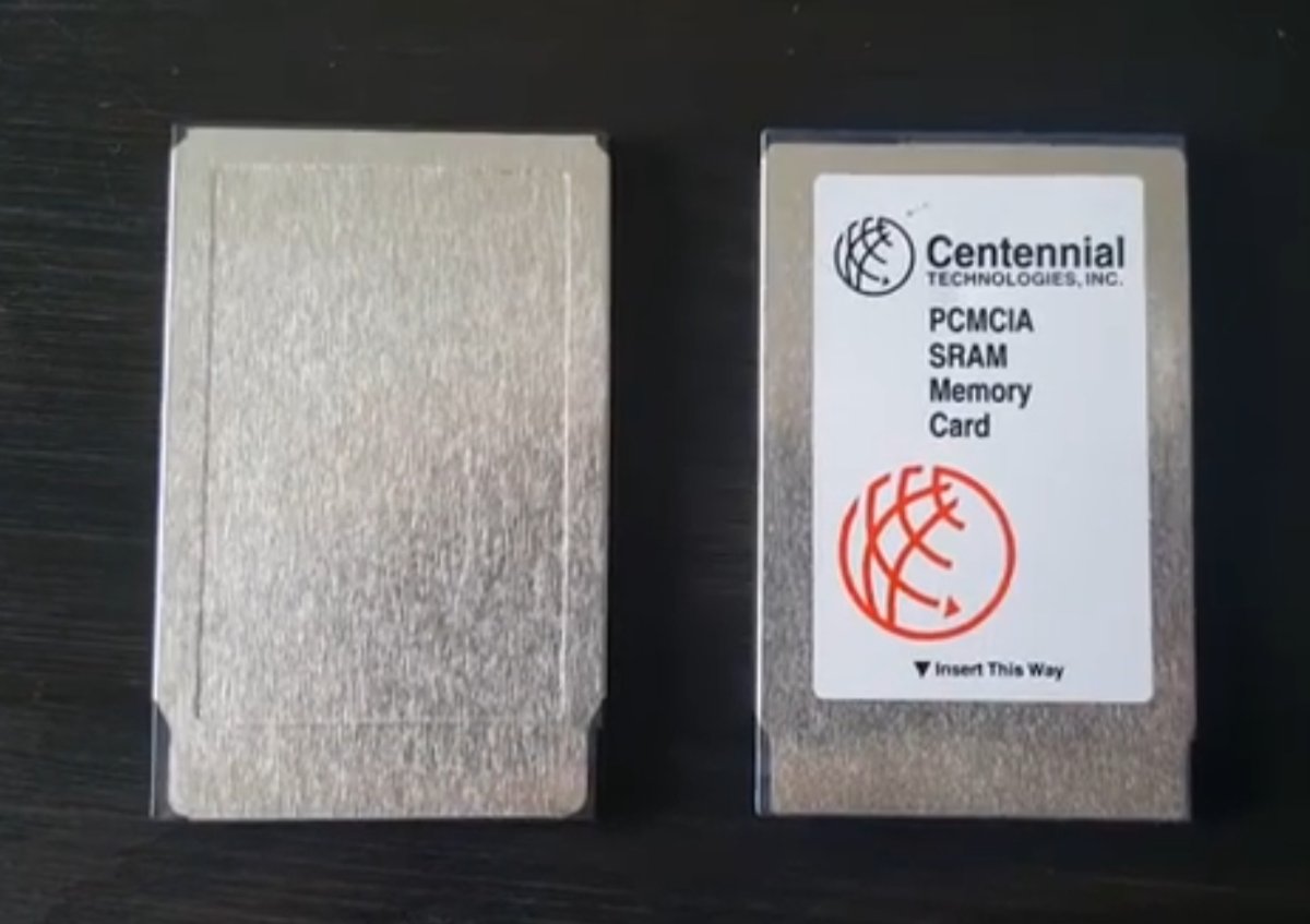

No, non-SNK JEIDA SRAM memory cards.
Sorry I must've posted without completing my sentence 😅.
Here are a couple of examples I have, which work with Neo Geo. These JEIDA SRAM cards were commonly used with laptops and sewing machines at the time.
Yes I remember those! I've seen other ones which seem to utilize SD cards, I haven't tried them, and not sure if it will though.
Only SRAM PCMCIA/JEIDA cards are compatible with Neo Geo. If you want something with modern memory you'll have to get the new SaveMasta or JGO cards.
