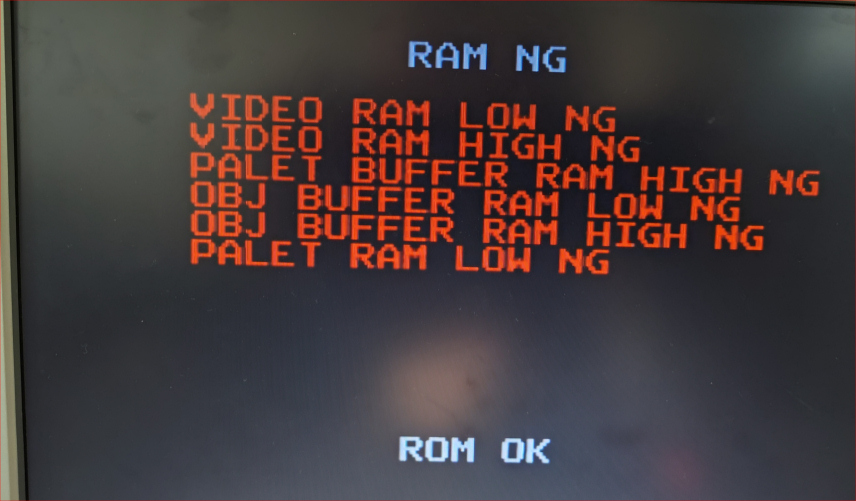

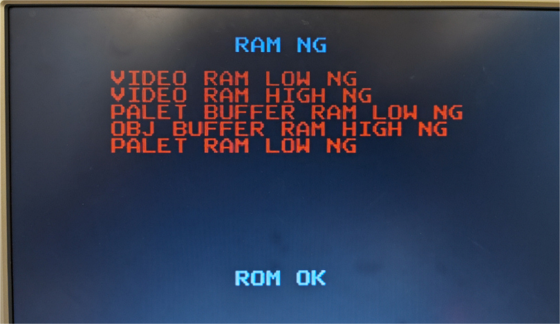

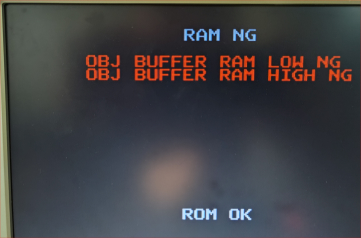

Which now brings me to the RAM errors. Sometimes when I boot the game, it boots fine and it says RAM OK, other times, I get an ever changing series of RAM errors.

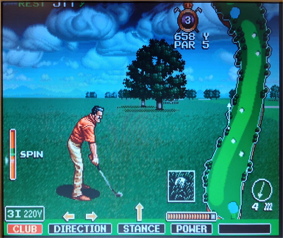

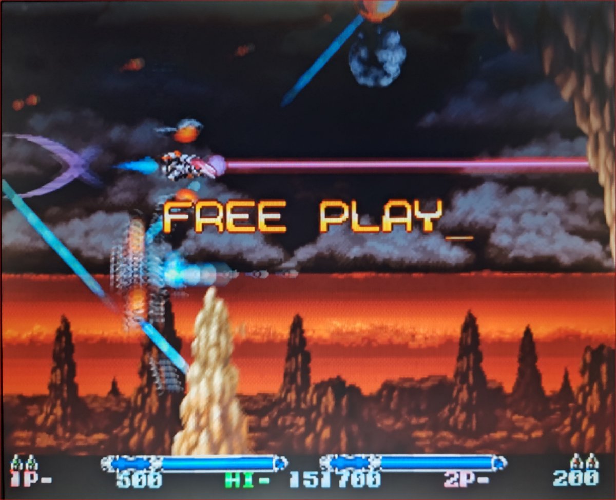

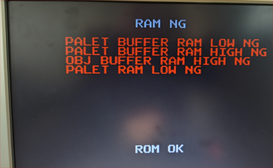

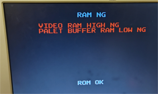

Here are some examples of the RAM errors that seem to change on each boot. Sometimes I get RAM OK and it just boots fine (although the graphical corruption below still is exhibited when the RAM tests as good):

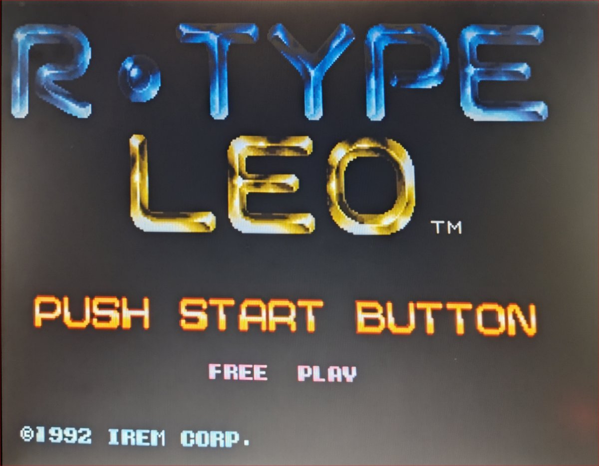

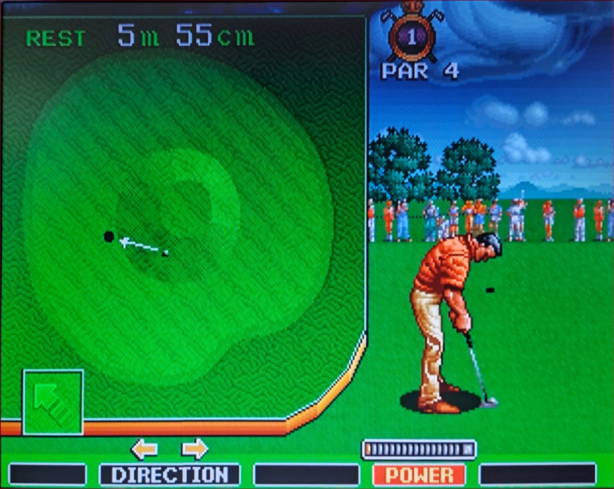

The game looks great overall, even with the RAM errors:

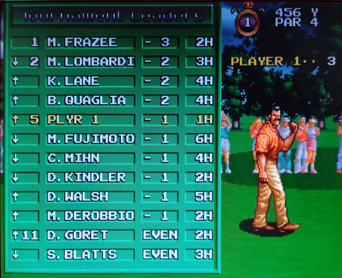

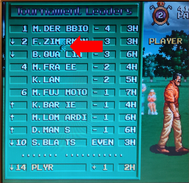

But there is clearly some corruption with the layering and either the row across the green being corrupt/transparent or the column down the leader board being corrupt and/or missing:

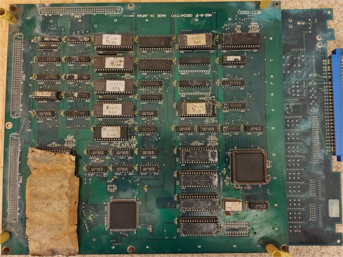

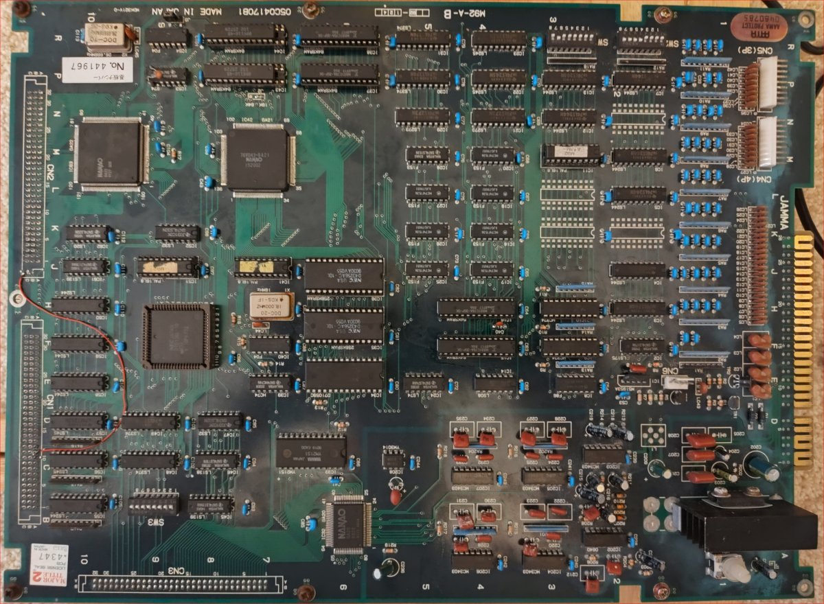

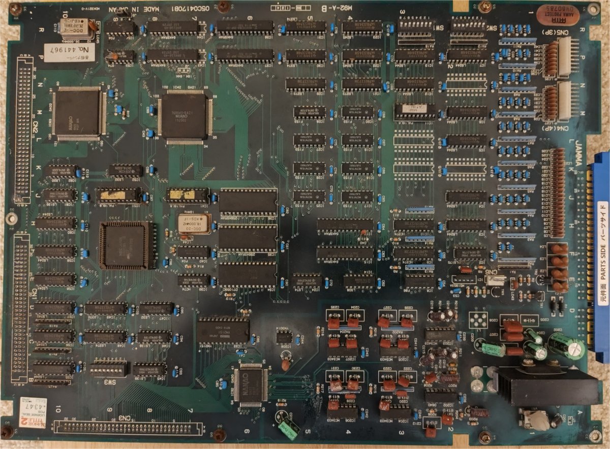

Here's what the board ended up looking like after the initial cleaning (pre-recapping). It's dirty/rough, but the components are not rusted or corroded (the only rust seems to be on the support post screws). It may be on the verge of starting some light corrosion, but the solder on the custom chips is silver and shiny like it was brand new. I'm really perplexed about why some of it looks good and other places more rough. I'm not sure of how it was stored. All I know is that it was hilariously dirty, the green lacquer of the board wipes off green a bit in spots near the JAMMA edge connector with any moist wiping (water, isopropyl, etc.), and the bottom board seemed a quite bit rougher than the top board. The boards came assembled and screwed together tight. I had to break the rust on the support post screws, so I don't think the board interconnect pins were exposed. This thing seems to have been left bolted together for a very long time:

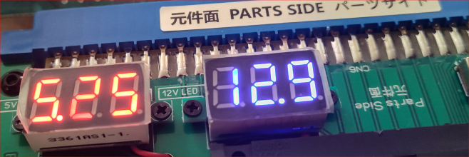

Check your voltages for 5.0V. If the board isn’t receiving sufficient power from the power supply then it will definitely cause random RAM errors. Those boards tend to draw more power than your average board too in my experience.
Thanks for that information. I did get cued in to a potential voltage issue as my test bench setupp in my mini-electronics shop in my garage is powered by a PicoATX power supply with a 19V laptop adapter. It works for the majority of games (although no -5V), but it wasn't enough to get the M92 board to boot.

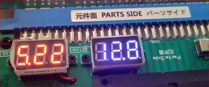

I have an AxunWorks supergun box and I drove the voltage as high as I was comfortable with at 5.25 volts to be within the recommendations in the Major Title II jamma manual and I still get various RAM errors:

5.22V is way too high. Dial it down to 5.0V and retest. I never exceed 5.15V on any board if it all possible.
Agreed. I was just testing to ensure that it wasn't a power supply issue due to my picoatx powered setup clearly being insufficient. The manual allows for a tolerance of 5V+/-5% and 12V+/-10% (although I know that doesn't speak to amperage). I'm pretty sure I'm not suffering from voltage drop causing the RAM issues.

Got my crap capture setup out and Youtube compressed the video to hell, but it demonstrates the consistency of the errors I'm seeing. It also demonstrated the board auto-rebooting after failing the ram test the first time.
It seems like the board has problem on a cold boot. It generates the craziest errors/graphical corruption during the POST routine during first boot. After that, it seems to work better. I've been racking my brain about what chips on the board may need to "charge up" to start working correctly, but I got nothing.

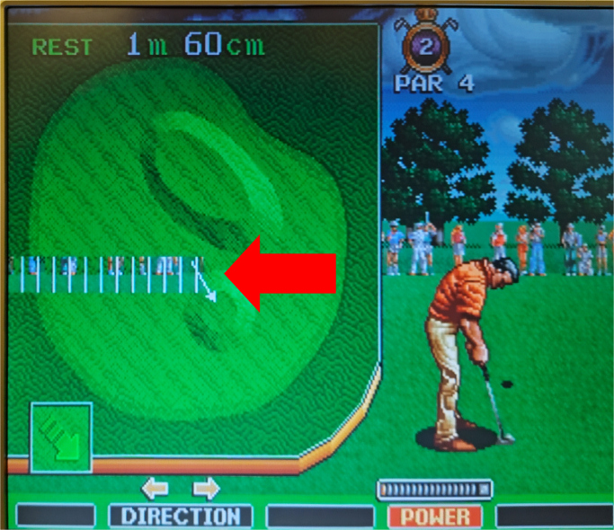

While the RAM errors change each time, the in game results are the same:
  1. Leaderboard loses a column when moving left and that column has artifacts after a hole (1:50 and again at about 3 minutes in the video)
  2. The putting green is messed up on the rows that have tiles for the ball and the hole (about 2:30 in the video).

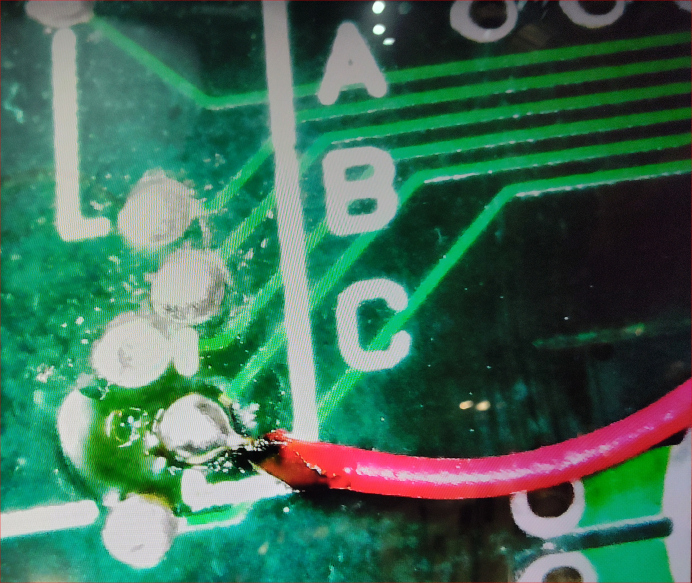

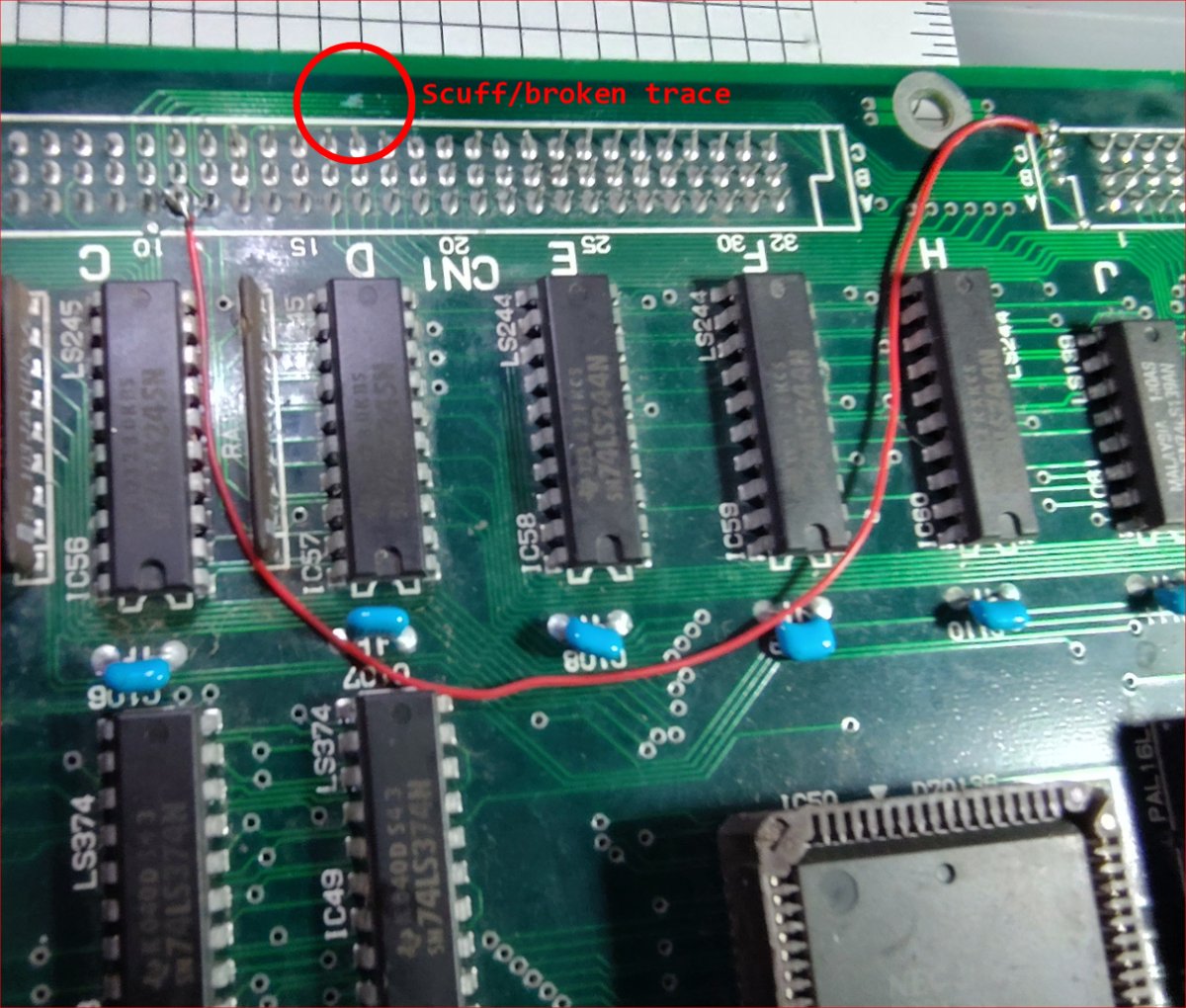

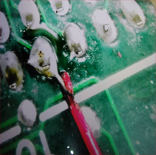

It was a broken trace on the A board just above one of the interboard connectors.
Thank you for everyone who provided ideas/guidance with my issue!
Here's some photos of the fix. Hopefully it can save someone else some headaches. The scuff with the broken trace looked originally like dirt on the PCB (as it was VERY dirty), but I started scrubbing things down with a very soft toothbrush and some isopropyl alcohol as I was thinking maybe something was being bridged by something that was conductive. After cleaning/straightening the pins on the top of the connector, I noticed how bad that scuff was once the dirt/rust was cleared and a few quick tests with the multimeter made it pretty apparent that there was a connectivity issue.
Trace issue/fix:
Fixed graphics:
