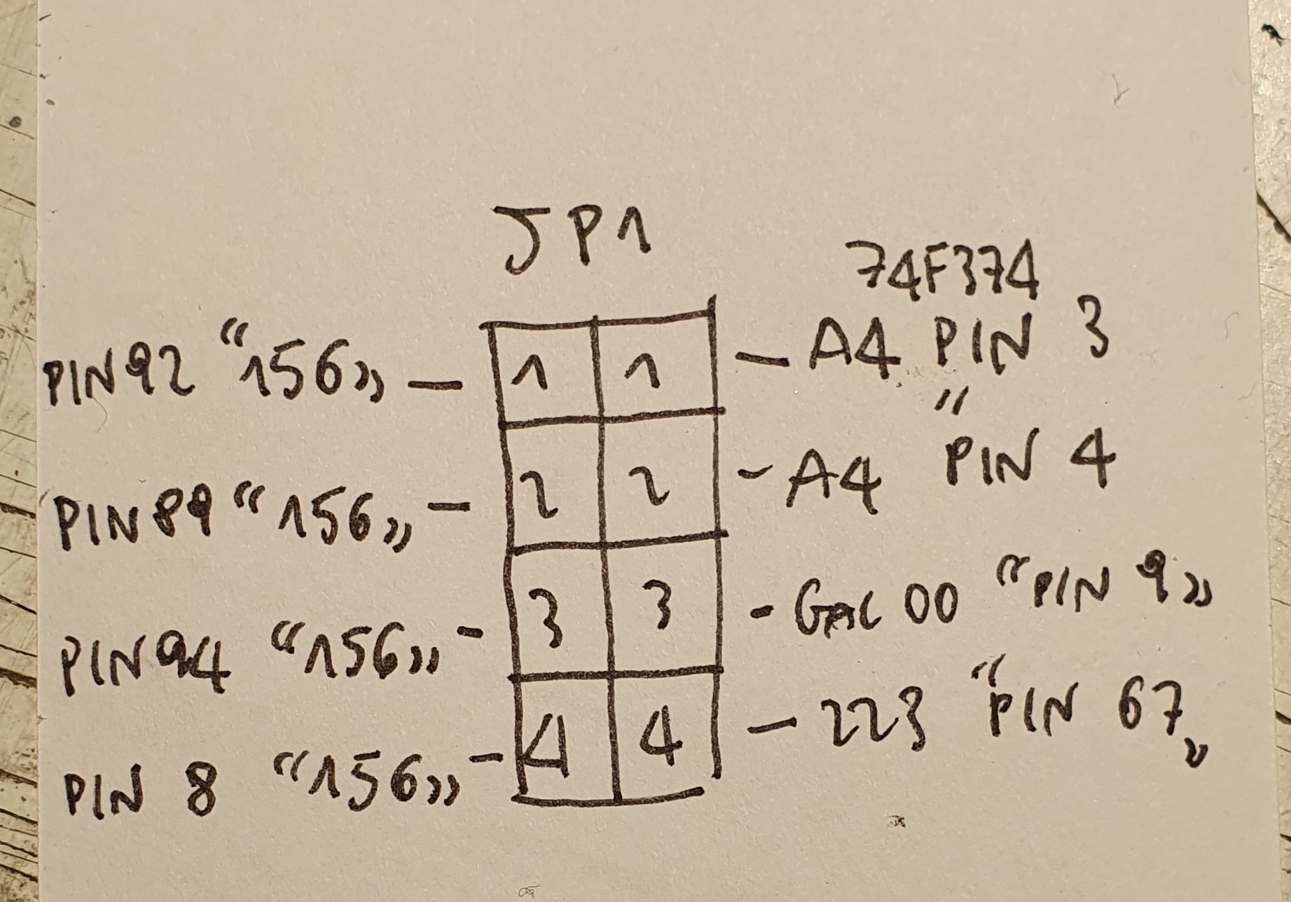

As far, very simple work done involving eeproms and gals (also added 74ls74 at H10). Unfortunatly i don't have any Charlie Ninja/Osman/Gonta to check deeper but i hope in your help.
Right know the game is kind working underneath, but the graphic is all messed up.

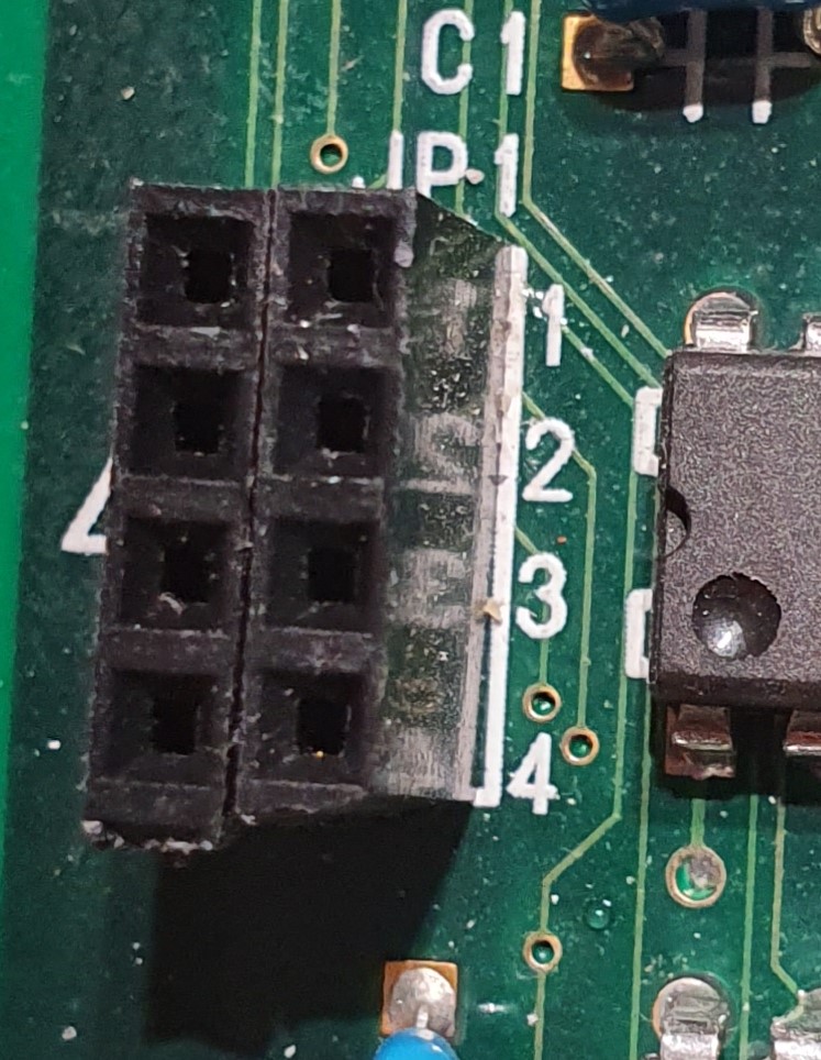

There is a Jumper section right above the 156 to figure out with the "real" board, i wasn't able to find any information about the 156 custom/cpu (are there any schematics of these boards?)
I've note down where the connections go throught, they originally match like 1+1,2+2,3+3,4+4 and i tryed to swap them around with no real luck, can someone confirm these locations are correct?
