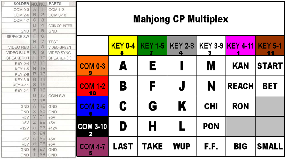

Anyone know how to wire up a mahjong panel to the MVS as I fancy giving them a try once I've got my hands on the multi and I can't find the webpage with the dip-switch settings and connections - I found one ages ago but either it doesn't exist anymore or my google-fu is not strong today.
I know you can use the AES controller plugged into P1 DB-15 with hard-dip #3 on but I want to wire up a Sega mahjong panel that just has a 12-pin plug on the end....
I've seen this diagram floating around... but I honestly don't know what it's compatible with nor have I ever tried to use it.

The key to making Mahjong panels happy on Naomi is to use a 838-13683-93 JAMMA to JVS I/O board, and make use of the CN3 connector in tandem with the JAMMA header to wire up the matrix.
So as to not bother folks that can't handle "text wall" explanations, the verbose details can be found here: http://www.arcadehustle.com/mahjong.html

Currently trying to wire a mahjong panel for use with Shangri-La on Naomi. The link from the previous post is down, does anyone have info on mahjong pinouts for the sega jvs IOs?
