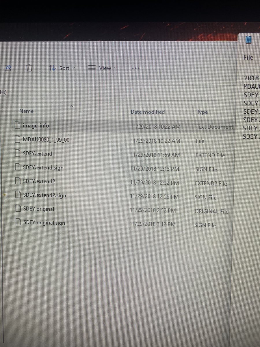

Good morning, I own my own maimai cab and something happened to game install. I trying to get the file from the usb drive it came with to install but nothing happens. I’ve attached some photos for reference. Any assistance would be appreciated.

Photos for reference is there another place to plug the usb in to be read?

I think your problem is you have an SDEY keychip, which is for Maimai FINALE. The keychip for Maimai Milk is SDDZ.

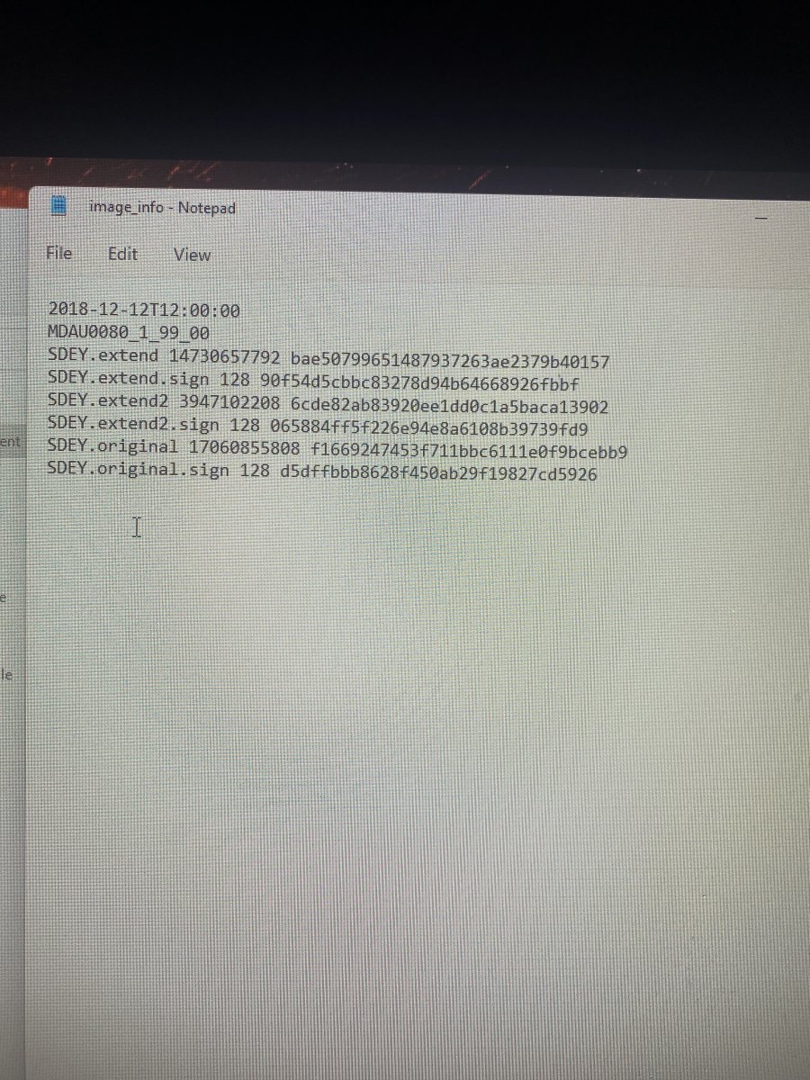

The Junkdrive says Milk but text files inside are labeled SDEY Finale on it.
Only other thing I can think to check is that the USB drive is labelled "SEGA_INS"
Progress that’s crazy that renaming fixed it so far…will keep you posted. If you live in San Diego I owe you lmao.

Yeah, the installer checks the name of the usb.
