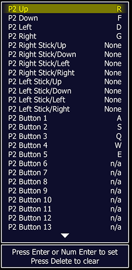

well since no one else had the answer I found a way to test the mapping so here it is for anyone else who needs it:
P1 (Mame Defaults)
Start -> 1
Coin -> 5
U -> up arrow
D -> down arrow
L -> left arrow
R -> right arrow
B1 -> Left Ctrl
B2 -> Left Alt
B3 -> Space
B4 -> Left Shift
B5 -> Z
B6 -> X
P2 (Mame Defaults up through button 5)
Start -> 2
Coin -> 6
U -> R
D -> F
L -> D
R -> G
B1 -> A
B2 -> S
B3 -> Q
B4 -> W
B5 -> E
B6 -> D
So it appears that player 2 button 6 is mapped to player 2 left joystick. @Dreygor how are you running any 6-button 2-player games like this?

No I meant MAME standard .. as in the normal PC MAME.
Is the link I posted for the default key mapping not for normal PC MAME?
Looks like mine is set up as listed below. I am showing I and K are buttons 5 and 6 on player 2
I don't know what your personal CJVS file is mapped to but the one linked to in this thread certainly does not have "I" and "K" mapped to player 2 buttons 5 and 6.
the CJVS file provided in the first post maps P2 button 5 and 6 to "E" and "D".
But if you have an alternative version that uses I and K that you can share that would certainly solve the problem.
