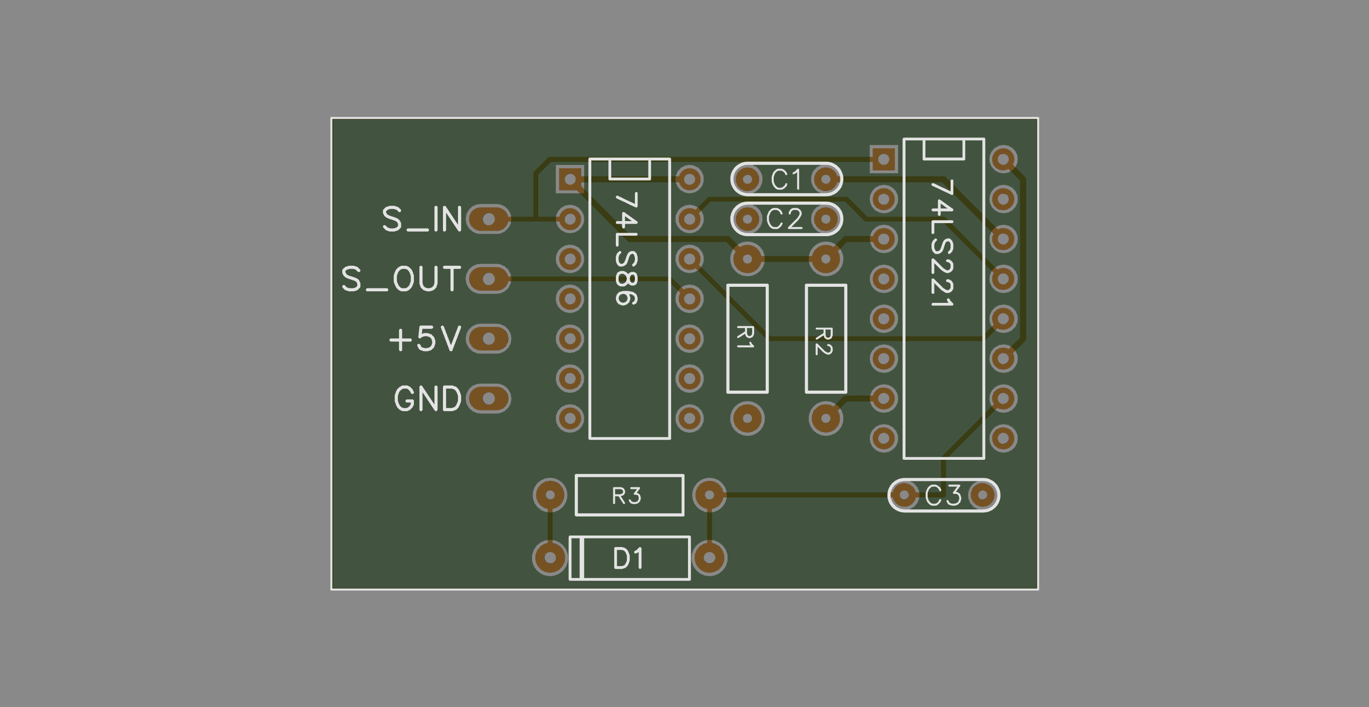

I would like to build Martin Jones's Sync Pulse Generator so that I can solder it in-line on my JAMMA harness. Seems the Sanwa PFX monitor in my NNC is not compatible with sync on some of my PCB's (mainly, the Taito F3). I am at a complete loss as to how to approach this since I have no engineering skills to speak of. This will probably be a longer than usual journey as I complete this but I would appreciate the help.
Firstly, the final product shows two IC's plus various components. Also, the same is shown over jammaarcade.net. However, the bill of materials lists out 4 IC's, which I believe are sub-"modules" in the same IC's?:
  • IC1B is a monostable which triggers on every sync pulse, generating a pulse 4.7 microseconds long. These become the new horizontal sync pulses.
  • IC2B combined with D1, R3 and C3 form a sync separator which triggers the monostable in IC1C only on sync pulses which are longer than about 40 microseconds.
  • IC1C is a monostable which generates vertical sync pulses about 200 microseconds long.
  • IC2E combines the new horizontal and vertical sync pulses into a new sync signal.
So as for the 1st questions:
  1. IC1B and IC1C are simply the same IC, a 74LS221, correct?
  2. IC2B and IC2E are simply the same IC as well, a 74L86, correct?
That is all for now. Will ask further questions as I try to make sense of the schematic myself. Thanks!

I made the post on JAMMArcade and build this device.There are only two ICs (74LS221 ans 74LS86), the four simbols on schematics are for the different gates of same IC (two per IC) :)

Your assumptions are correct. There's two ICs, IC1 and IC2. Guessing he spread them over two parts to simplify drawing the schematic?
Also note that R1 is meant to be 6.8K and not 680R. He mentions this mistake in a comment at the end.
I'll whip up a PCB for this if you like? I'll supply the necessary files, you can then order the PCBs and make life easy for yourself.
Awesome, thanks so much @Frank_fjs! Doesn't need to have the switches like the eBay seller has done it. Martin Jones says it doesn't impact sync of non-impacted games so it will be wired in-line to my JAMMA harness going into the NNC as a permanent component. Let me know details as to whether you plan on making the components SMD or through-hole. I can start to build out a parts list on Digikey.
Thanks again!
Thanks caius. I know that is your site. I was thinking of paging you. But the question seemed too low-level to reach out to you yet. I'll get there though. It's starting to make more sense now. Silly question here though, do you think the schematic could have been composed better?
Schematics are good as they are.But Keep in mind this SYNC pulser is not the panacea for all issues hence some boards will still be probematic..
I'd be inclined to use through hole, but can certainly utilise SMD if that's your preference?
Through-hole is fine and easier for everyone. I am sure I won't be the only one ordering the PCB's from Osh Park.

I have the Sanwa PFX (KW0606A) connected via the high-impedence 6-pin header. Don't put too much into it though. It is a rather small corner case. Martin Jone's Sync Pulse Generator will solve the problem I am having for my setup.
For fun & science, you could try to connect it via the low impedance and see if it syncs - from the data I have, it should.
