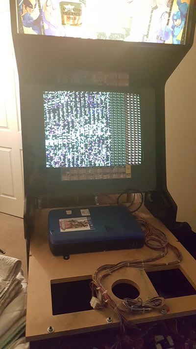

This will probably fix it actually.Silly question, but did you completely reformat the SD Micro Card then copy over the entire updated directory? I've noticed that others here who have had issues with the games hadn't reformatted and fully copied over the entire card contents. They just updated one file or moved a file over. For this kit, you are required to completely reformat the card, then copy over the entire directory contents if you've modified/updated anything.
