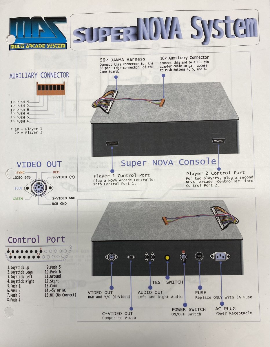

D DJLC Professional Joined Jul 21, 2015 Messages 249 Reaction score 73 Location Saint Louis, Missouri Apr 18, 2025 #1 Anyone have this handy? I want to make adapters to the standard DB15.
Neodogg Grand Master Joined Aug 17, 2015 Messages 554 Reaction score 704 Location Cincinnati, OH Apr 20, 2025 #2 When I made my adapter I just found GND and then touched wires to different pins while in the CPS2 Test menu input…I’ll look for my manual… Last edited: Apr 21, 2025
Neodogg Grand Master Joined Aug 17, 2015 Messages 554 Reaction score 704 Location Cincinnati, OH Apr 20, 2025 #3 Found it:
D DJLC Professional Joined Jul 21, 2015 Messages 249 Reaction score 73 Location Saint Louis, Missouri Apr 21, 2025 #4 Thanks!
