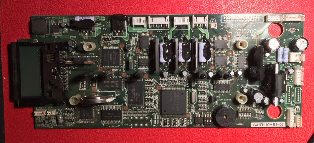

SANWA CR-S31R-10HS3 Card Reader/Writer PCB:

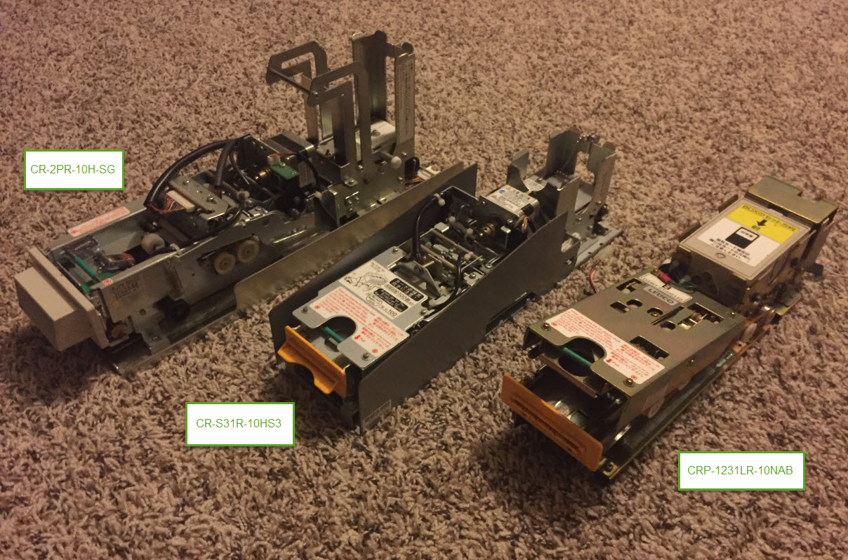

There is a similar card reader/writer with model: CRP-1231LR-10NAB that looks to be off of a Maximum Tune 1/2 cabinet in the US.
The Card Reader/Writer for Initial D Arcade Stage 4/5/6/7/8: CR-2PR-10H-SG only looks similar in design and layout but not in functionality. This card reader uses a different card altogether from the other two.
Both the CR-S31R-10HS3 and CR-2PR-10H-SG have a slot for a Compact Flash card. I don't know too much about either one but sources online lead me to believe this is the gateway to updating the firmware and other such functionality whereas the CRP-1231LR-10NAB has a ROM chip(?)

Cards from ID1-3 and DOC aren't 100% compatible with WMMT. These cards don't allow for erasing the thermal printing whereas WMMT's cards do. So if one of these cards gets used, you end up with a very smeared mess as it tries to erase and reprint. The data does save correctly, though. At least that was my experience in the rightmost reader in your pic.
You are correct. The same behavior happens on the WMMT3 card reader. I found this out the hard way, using an ID2 card in WMMT, the card gets printed all black but the data saves properly.
