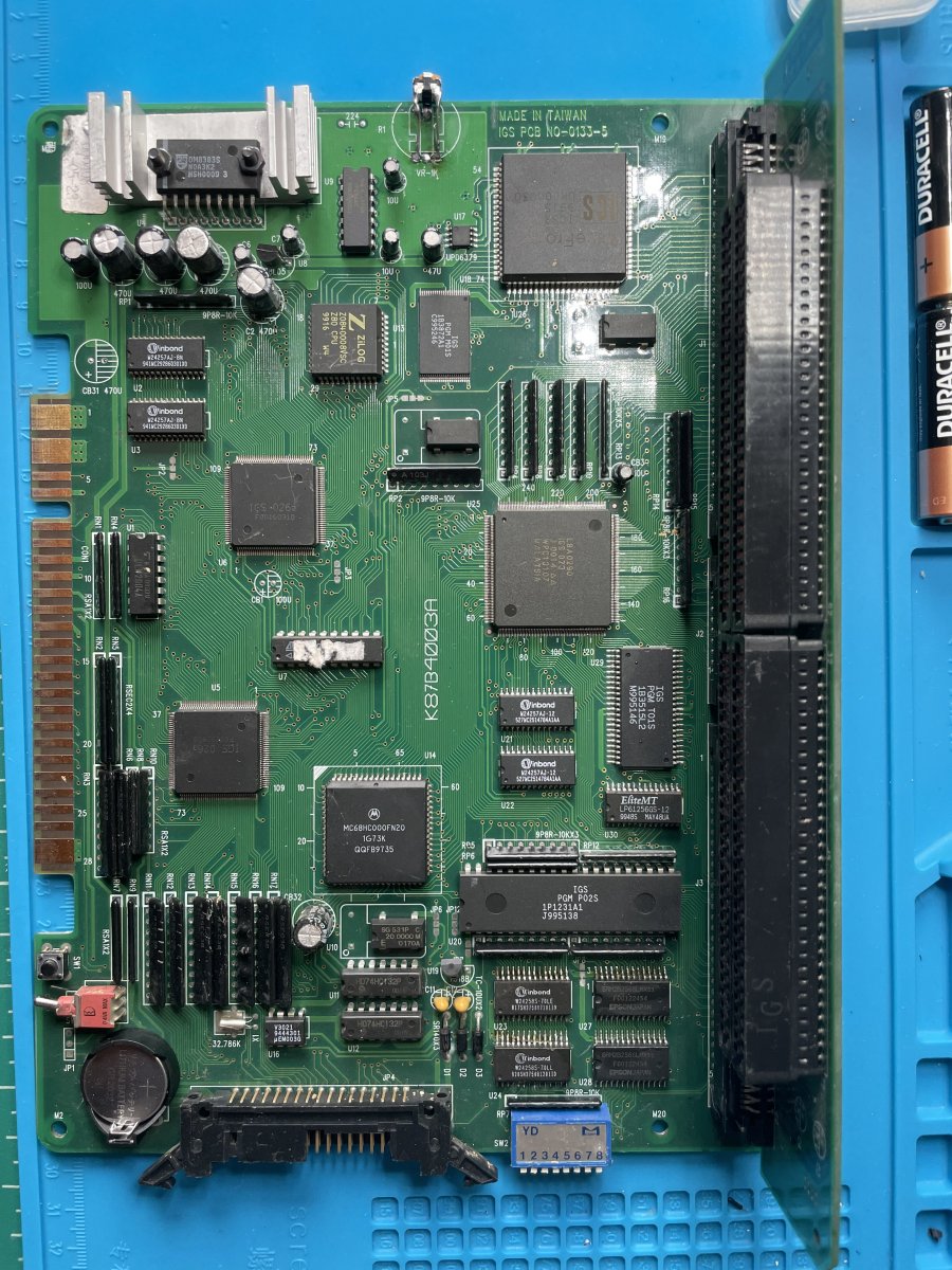

Hello, I'm the guy who replied to you on FB. I think.
Anyways... What kind of power supply are you using? Are you using a Supergun? Did you check the voltage at the JAMMA edge with the board on? With a proper multimeter?
Can we get some pictures of the actual PGM PCB? The top side please, you'll have to disassemble it but it's easy I promise.

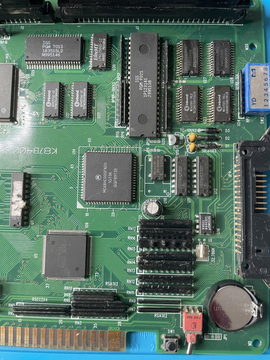

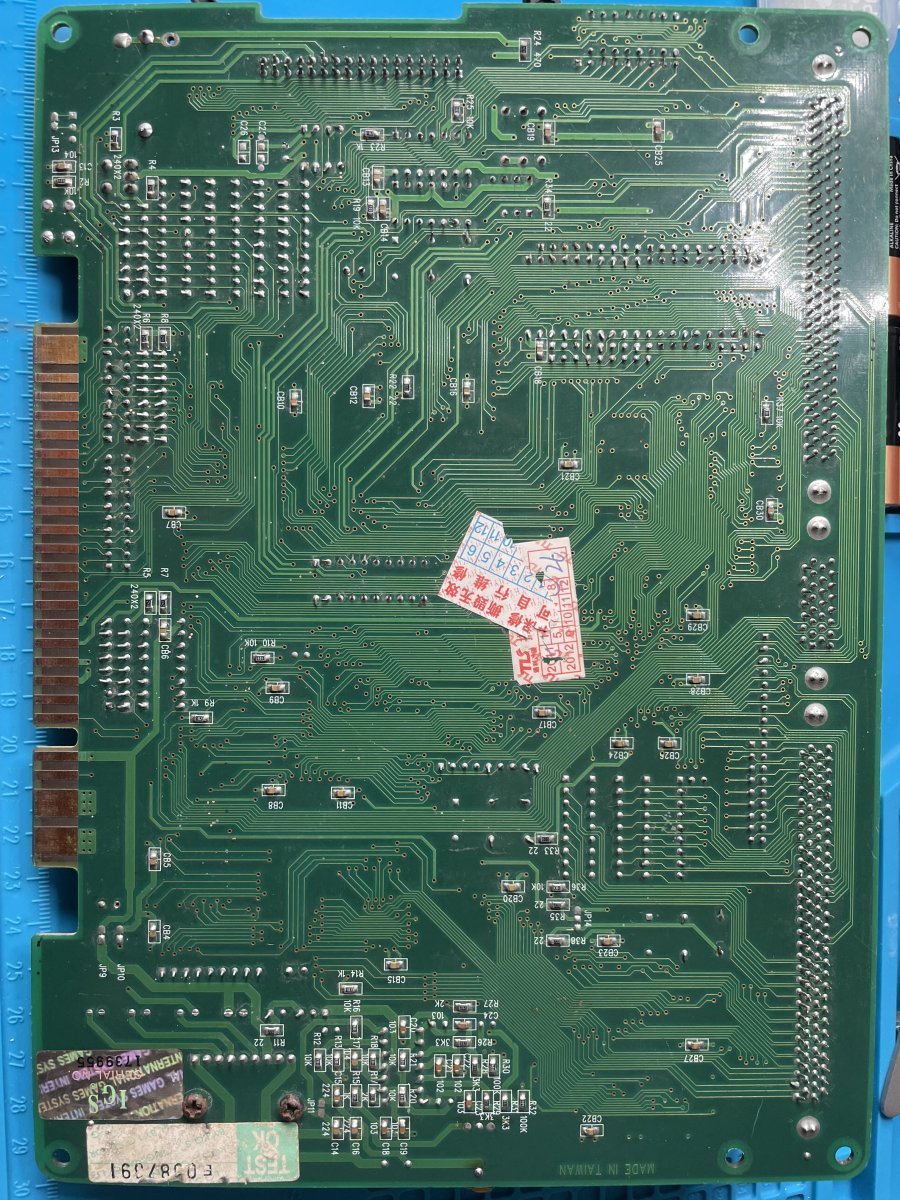

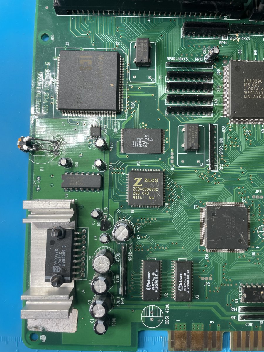

3 - On the topic of pictures of the board, your wish is my command :) - Please see attached photos. Let me know if you need me to Zoom in anywhere

The 4 RAM chips next to the dipswitch look like they have some dodgy soldering... Seems like an old rework. The dark grey is usually a sign of cold solder joints (repair rule #275 guys!)
If you know how to do it you can try to resolder them. Use fresh solder if you don't have flux. Make sure you don't bridge any pins and tell us how it goes.
Good luck!
