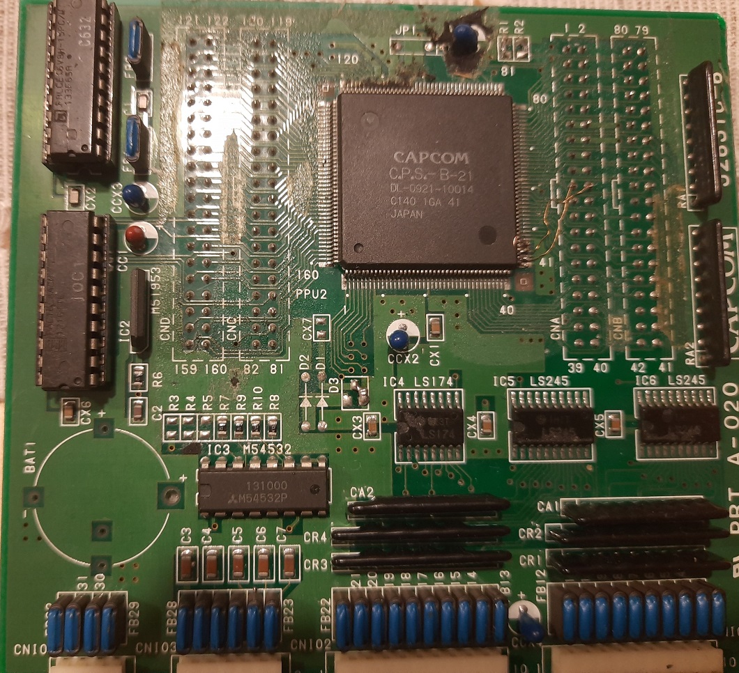

Mercs (US version) lines / jailbars on background and sprite layers

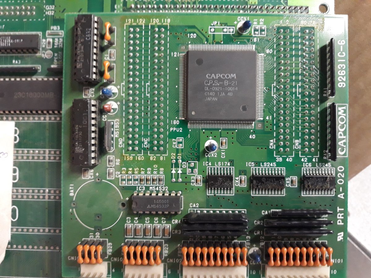

that PCB cannot keep keys, as it's a 92631C-6 and it has the pins for programming the keys hardwired to VCC. You would need to mod it, which is something I don't recommend. See pictures below of original like yours without the black foam and of one converted.
