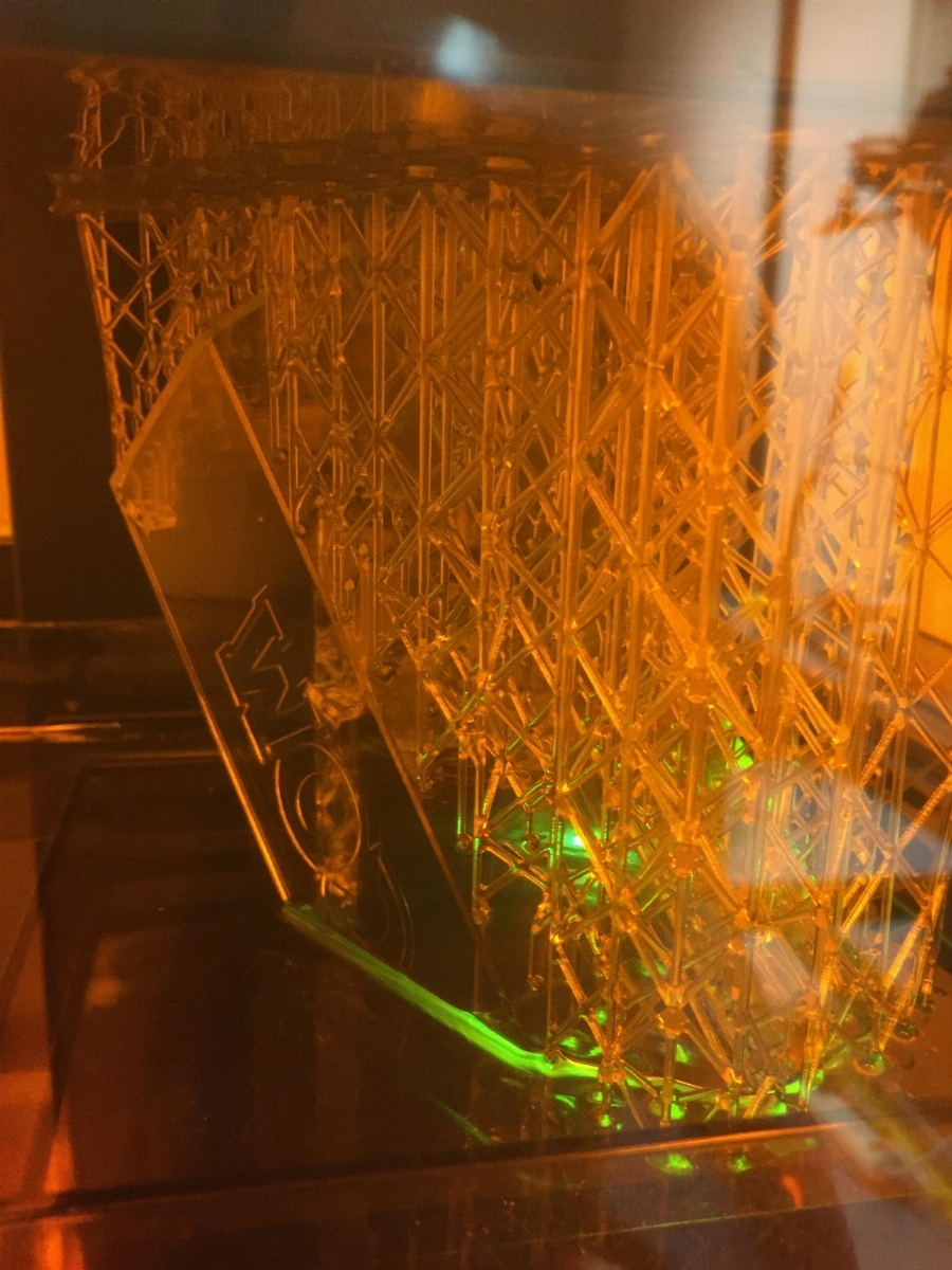

In Preparation to preorder a life size one from @hursit I began to make this tiny Beauty. The body was SLA printed and I Used a Raspberry Pi and a 2.2 in LCD for the electronics.
After Everything was sanded and painted and I began to fit in the electronics.
The Front glass was also SLA printed and then sanded and covered with clearcoat before I placed on the window tinting film.
Here is the finished version. There are a couple of things I will change for any future iterations but I am happy with the results for now.
