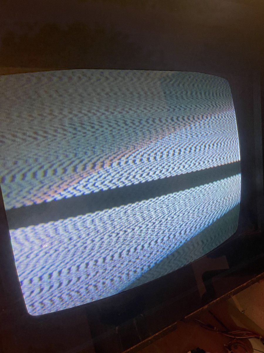

I just set up the Mistercade and connected it to my Neo Geo MVS cab using the JNX adapter. When I turned it on the screen displays in a rolling pattern. I've been using an Arpicade on this cabinet through this same adapter and it's worked perfectly, so I don't think it's an issue outside of a configuration problem with the mister of some kind. I used the 15Khz ini file as instructed, but perhaps I made a mistake with that? Is there a way to confirm the video settings are correct?
I get that same rolling screen issue when I run the Mistercade inside one of my Sigma cocktails.
I get rolling visual noise and power drops on my Q25.
Plays perfectly on my Astro City.
Seems like the Mistercade is picky about PSUs and maybe certain monitors?
*Try adjusting the v hold or h hold on your monitor and see if that fixes the rolling image.
I tried the v hold and it did reduce the rolling but the screen is still garbled. I also tried plugging it into a Namco Exceleena candy cab here and I get the exact same issue. That Namco is pretty reliable and newer hardware so I think it's most likely an issue with the Mistercade, whether it is configuration or hardware.
I actually ordered a second Mistercade and it looks like it is scheduled to arrive today, so I can also swap hardware and see if it's something specific to this unit.
Please update us! Hate to say it but I would love to know if there might be "faulty" Mistercades out. 😬
