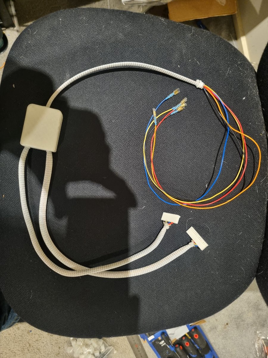

MK1/MK2 kick harnesses with condenser.
Big_P Big_p
May 2, 2024
370
513
Australia
I am putting an MK1/MK2 kick harness together for someone already so I thought I would see if there was any interest here. Basically someone has asked for a kick harness that they can use in their MK cab that has MK1 and MK2 boards in it with a JAMMA switch. Nothing fancy it will be a perf board in a 3d printed box that holds 8 1N4148 switching diodes. Comming out of one side of the box will be 2 cables one with a 12p MK1 connector and the other with a 15P MK2 connector, both approx 50cm long. Comming out of the other side of the box will be the LP LK wires for P1 and P2 with female spade connectors, this side will be approx 75cm long. Ill post picks once I have one made up, but if you are at all interested let me know so I can order extra connectors before then.
This should allow MK1 and MK2 in a single cab with something like the riddledtv JAMMA switch. Condenser uses 1n4148 high speed switching diodes as used by JAMMA nation and @Mitsurugi-w in their condensers. Hope the guy likes it.
