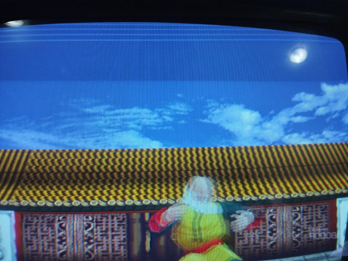

Model 2 video card going bad?
I noticed that the roof at this stage of the Virtua Fighter 2 looks strange.
The textures in the middle of the roof look like they were messed up.
I looked for videos on YouTube of this game on a real machine and saw that the roof is rendered correctly and not like this.
Could anyone else who has this game send a photo of what the roof of this stage looks like?
It's a very small detail that I don't know how to complain to the person who did the repairs, it would be useful to have proof that it's not supposed to be like this.
I haven't seen anything bad like that on the other screens so far, I'm playing more to see if something strange like that appears on other objects.
Here's mine:
Have you tried running the memory check in the test menu?
Here's mine:
Yes, it show all good
If I pay attention I see parts with messy textures but not as much as that roof.
Most of the game looks fine, only those who pay attention to detail see these defects.
Thinking a lot about whether it's worth sending it back for repair.
Good point. Likely an issue on the video board then.
After a visual inspection of the board that came from the repair I found this, a short circuit, in the large IC near the edge, poor service, with a crappy 4x magnifying glass I found this short, how could someone who has an electronics laboratory not seen this and had the PCB there twice.
