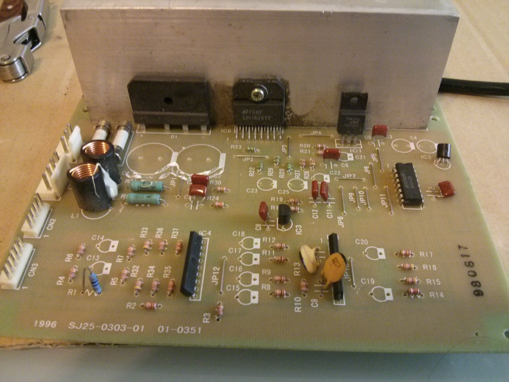

However, on taking a look at it one of the resistors was broken in half. No problem, I swapped it from the other amp and gave it a try.
Hooking it up, I get much louder sound albeit a bit lower than what I'd call normal - however, there is still a buzz to the audio at any normal levels.
Would recapping the model 3 amp fix the buzz? Anyone know what could cause that issue?

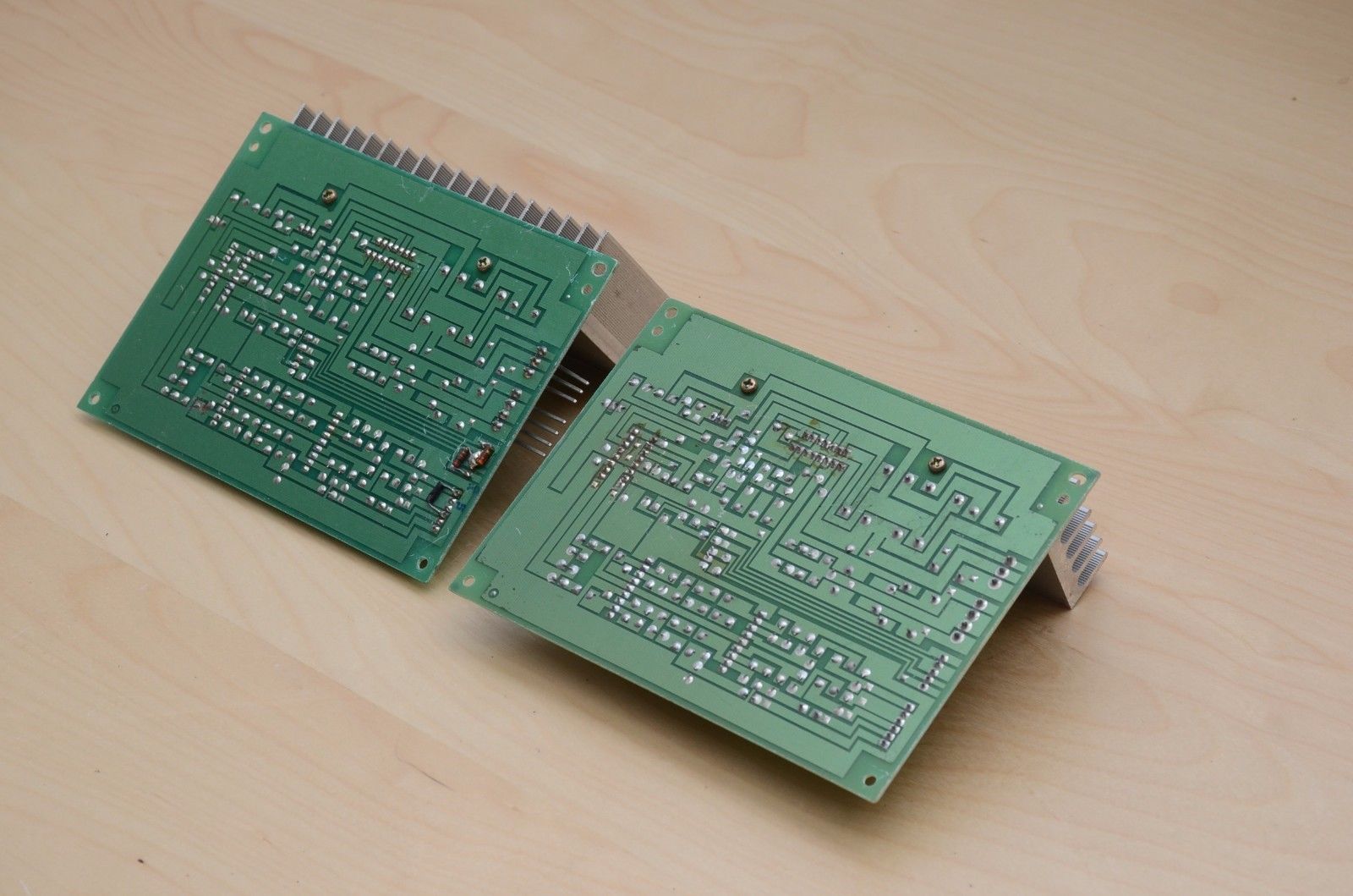

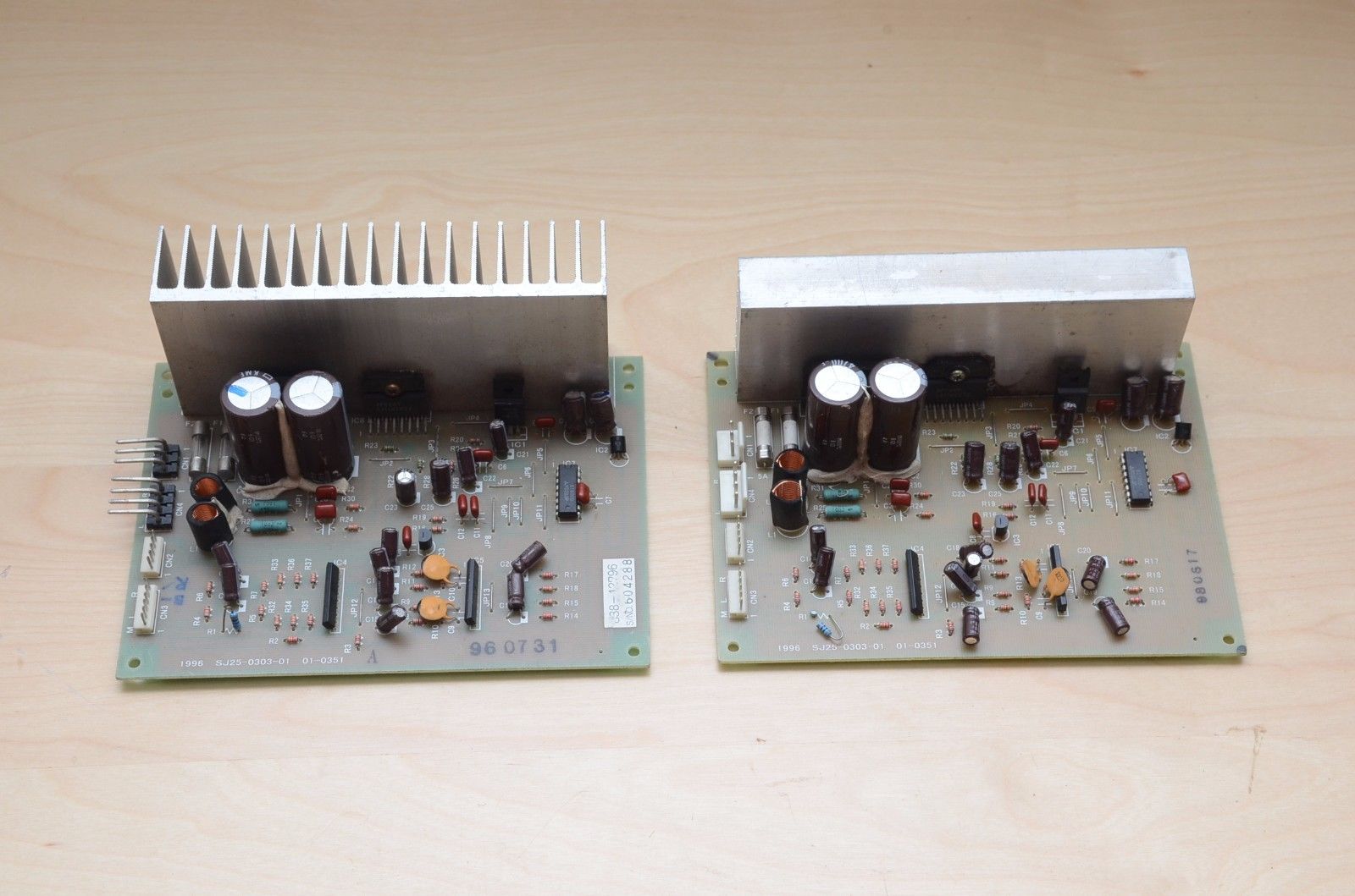

On the left you can see the right angle connectors I'm talking about. Anyone know the part # for the ones on the right? (The 3 and 4 pin headers)
On the left you can see the mods I'm talking about re: CN3 and CN2. I'd be curious if anyone knows what they would do. I'm not using this one right now, but I'm thinking of giving it a try.
The pinout for them can be found here: https://wiki.arcadeotaku.com/w/Sega_Blast_City_PSU
My guess is that maybe they bypass the volume pot and force mono for some reason?

I usually just take a meter to an intact one (resistor) and go with that measurement if the colors aren't absolutely clear. Resistors are usually better tolerance than caps to begin with and retain them.
My multimeter gave me a reading of 10 ohms for R1 on the amp I took out, so I guess I'm on the right track there. How would I know the right wattage or tolerance to choose though for replacements? My basic multimeter doesn't seem to give me that information, or maybe I just am not adept enough with it.
can't go wrong with tolerance... Lower percent the better of course.
Wattage wise for most resistors 1/4 watt is fine, but for power supplies you can need more like 1/2 watt or higher. As silly as it seems size is a good indicator, higher wattage resistors will be larger. Think of this like voltage rating for caps... Going larger wattage is ok, but not smaller.

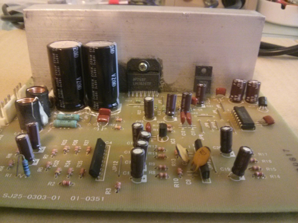

So I received the replacement caps today and replaced all of the electrolytics on my Model 3 sound amp.... Sounds fantastic now and plenty loud!
Mad thanks to @skate323k137 for sharing the Digikey part numbers for the caps. :D
