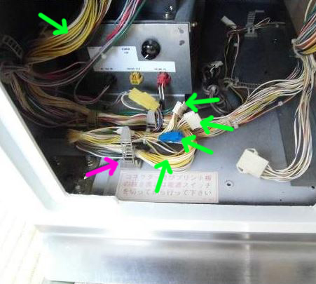

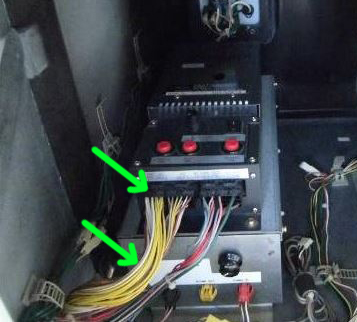

Hello there,
Maybe it's a better place to post this :
I wonder why a few NAC do have four connectors wired instead of three on the PSU.
On these pics, the 12 posi fourth connector is wired with several yellow wires (maybe some are +5v since they are yellow). What's their purpose ? There are some JVS NH connectors hooked to this extra harness. Maybe these are for Sega Model 3 ?
If yes, which harness should I use to run a model 3 ?

Thanks ! Correct as you say. So, refering to your pinout and the model 2 shemas - these wires ends with : 1 x JST 10NH (containing 5 x GND + 5 x 5V) and 1 x 2 posi AMPUP blue (containing 1 x 5V + 1 x 12V).
But on my pic, it seems that these wires ends with two different JST NH conns (and a 2 posi AMP UP blue as well).
So, no way to play a VF3 on any NAC ? Maybe VF3 / Model 3 was developped for Blast or Astro2 ?
