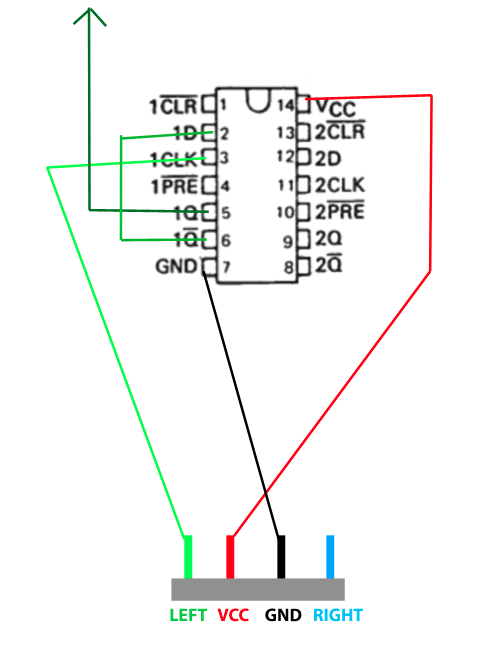

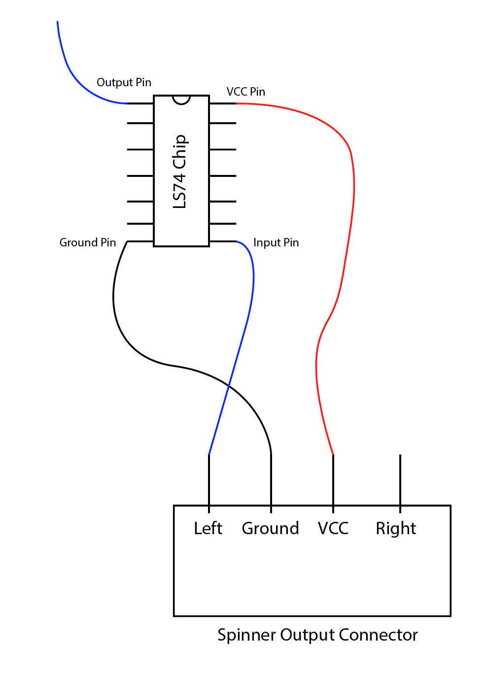

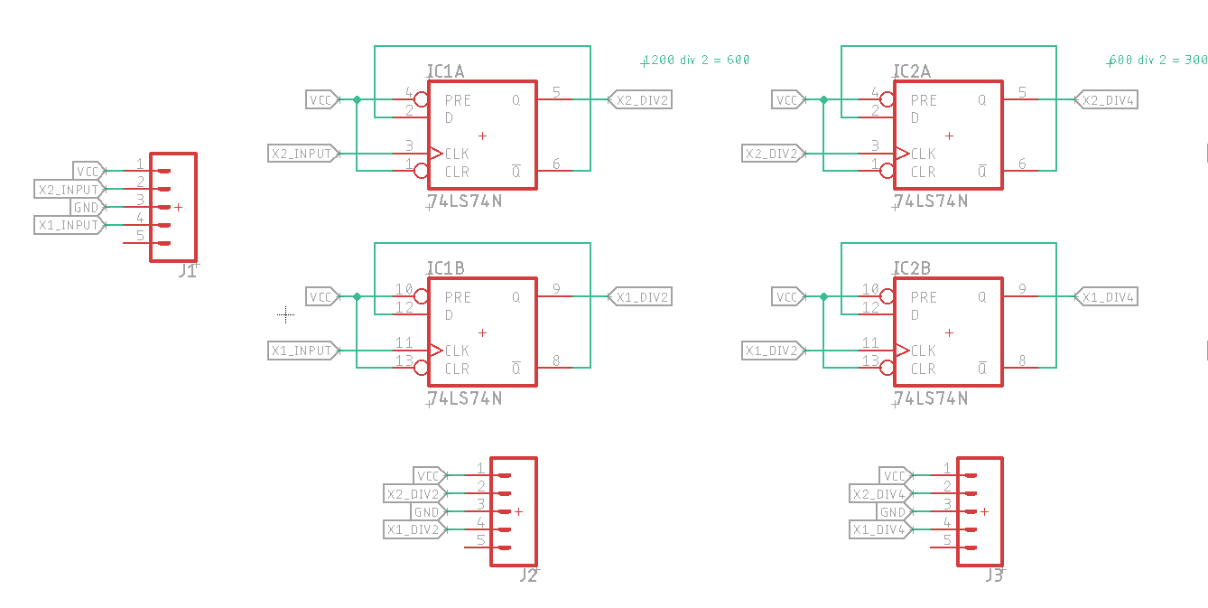

On this thread, you talked about changing the sensitivity of a Taito Spinner using D Flip-Flop.
So I made a mockup of this solution based on the work of @brizzo.
SpinTrak => D Flip-Flop => USB Adaptator
I chose this test mode because I said to myself that if the signal is well processed by the adapter, then everything is fine.
Besides, I was confronted with a strange behavior, the most embarrassing was the fact that the change of direction was not well identified.
With a D Flip-Flop, we divide the time by 2. So I said to myself that there must be a "synchro" problem.

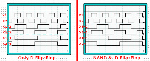

So I scribbled a number of paper to come up with something interesting using NAND
With a little simulation software, here are the two results as well as the diagram.
I don't have a NAD available to make a mockup, but I wanted to share my little work with you if that helps.

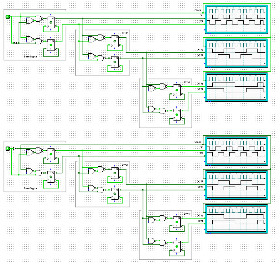

Thats interesting. it seems like a more apt approach. I'd be interesting to see how it ouputs with randomized pulse patterns to simulate actual use. The logic could maybe even be reduced to a single GAL.

My approach to signals is just based on the principle of "making the wave".
I don't know yet what that can give, the basic result with the little simulator also seems interesting to me.
I receive NAND this week, I will only have to test this mockup

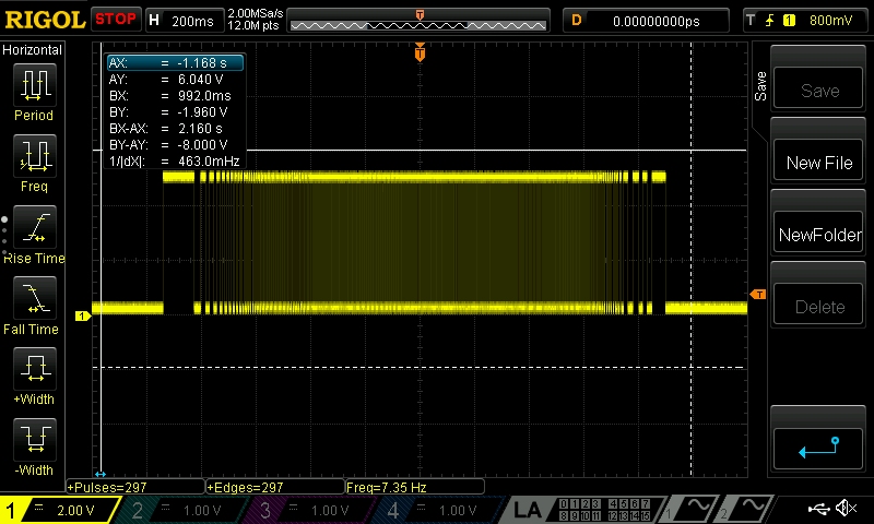

this thing has only 300 pulses per revolution.........:S
Between the commercial presentation and the reality, there is a ditch .. 🤨
If I allow myself to extrapolate, 300 pulses makes 600 transitions, on two wires ... 1200 transitions.
Maybe that's it ? What do you think ?

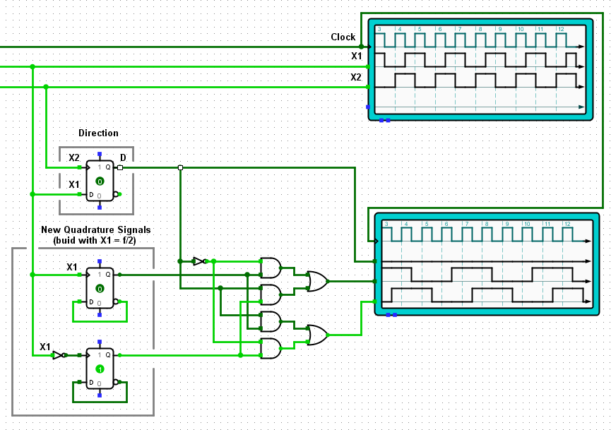

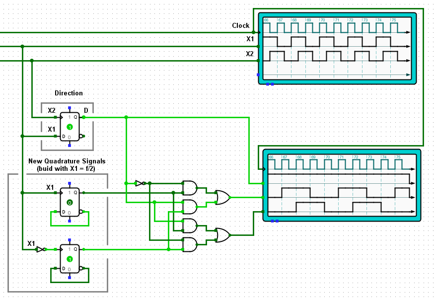

Hello,
I recovered some logic gate and tested the previously posted treatment.
It does not work, the direction of rotation cannot be managed with this assembly. :S
So I restarted with a different logic...
At the Spinner output we have a quadrature signal with a direction according to the progress of a signal compared to the other.
So I followed the principle of the diagram used by @brizzo to basically retrieve the sens.
From there, I used one signal put on clock D Bascule to recreate a new quadrature signal.
This has the effect of dividing the frequency by 2.
So I had the sens and a new quadrature signal (div 2) that I organized with a few AND and OR gates
For me, it works great with the Spinner and its USB adapter.
Now I don't have an oscilloscope to check the assembly on a test board
Thank you @AstroX, since you measured 300 pulses, I will limit myself to dividing the frequency by two.
I don't know if it helps to redivide by two (f/div4)
If it does indeed only read 300 ppr then I think you are correct in how the came to the marketing number.
no need to divide at all, if it's 300 ppr then it's already slower than the Taito spinner at 486 ppr
I think if you want success you have to STOP thinking about this as a wave form and start thinking about it as a 2-directional counter.
you need convert the wave to a pulse counter, divide the count, then convert back into a wave.
