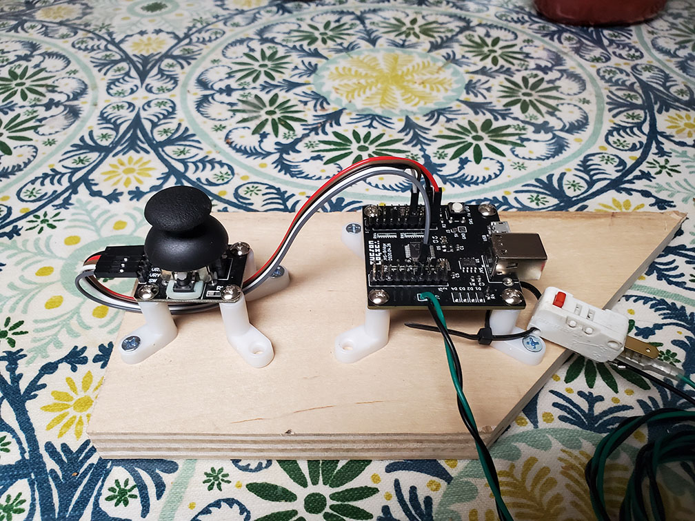

So with this I used a Sony PS2 Joystick Module I had left over from a hardware project where I had to navigate a UI, to enter in offsets to analog values for a Arduino project.
I had purchased a tuscon logic JVS board, and flashed it with their analog firmware. Which is 90% of what you need, once you have that it gets pretty simple.
Connect Ground to Ground, 5V to VCC and then Joystick X, Y to pin 13&14 and I connected the push button to P1 Start, and it WORKED! I had to calibrate, and swap the {axis}wires until it "felt" natural. The Thing Zip-Tied is the coin button.
Here's some pictures, feel free to ask questions.
