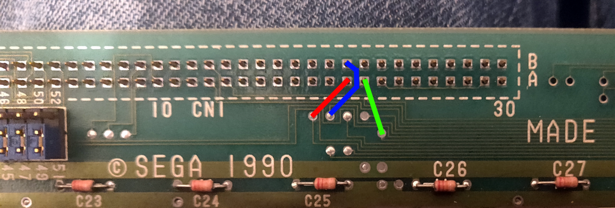

In the previous post an user said that these points needed to be wired to fix the issue. Could you try it?
I tried it just now. At first glance it appears to solve the issues, but not all of them. There's still sprite corruptions, both in the demo and in normal gameplay.
But this should be purely a software issue, much like it was with Moonwalker. I still think it can be solved without any hardwiring on the ROM board.
Oh, What a pity!
Hmmm... I'll retract what I said last time. Somehow the sprite corruptions I saw after making the mod worked themselves out. I'm not sure if it was because I pulled the romboard out to check something, or something else, but the game seems to be playing now without any visible glitches. Perhaps it will work great for you. :)

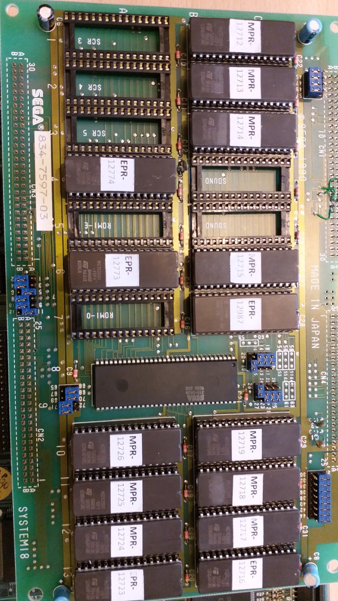

Hi could you post a photo of your ROM board layout please, having no luck here.
Edit: All sorted forgot to do the three wire mod .
Edit Edit: I can confirm this runs fine here is a photo of my ROM board. This maybe of use to others.😀

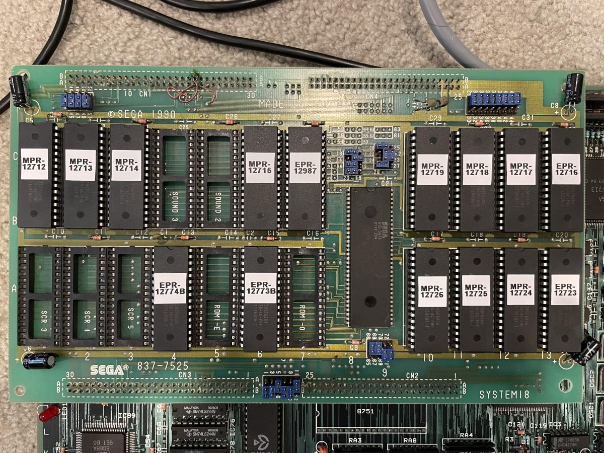

Sorry about taking long to post my picture. Excuse my not so neat wire mod.
I'm posting this in case someone uses Flash ROMs (39SF020) instead of EPROMs, there's a slight difference in the jumper configuration.
26/25 is needed because pin 31 needs to have voltage. Otherwise no samples will play.
14/13 and 20/19 get inverted on mine because the flash has JEDEC pinout.
I hope this helps someone.

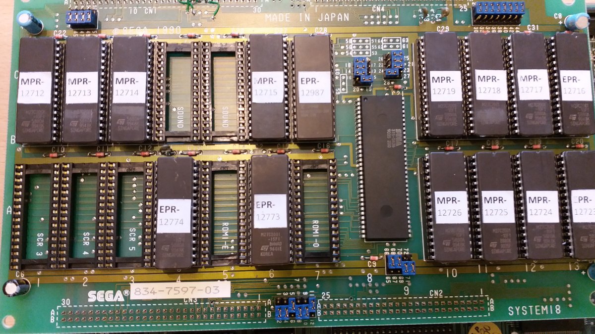

@Gamesmonkey Your rom stickers look so cool. How do I get those? 😅
Ha ha, I made a template in Microsoft Word and cut out by hand.😂
My wire mod is not the best either. 😀
