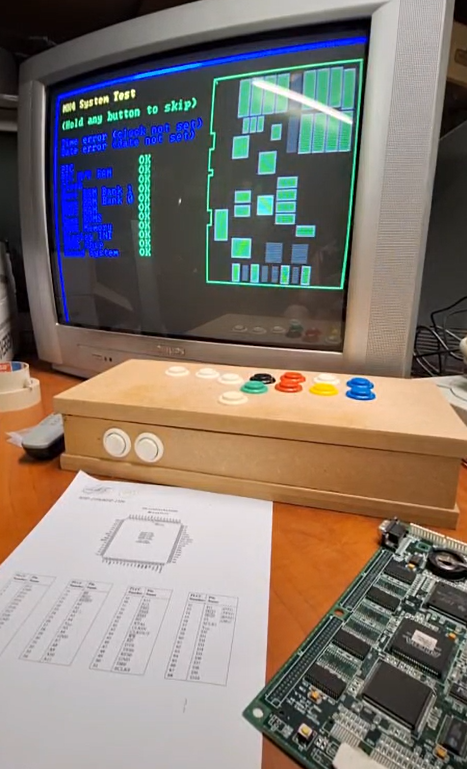

Hi all, got a MK4 board that reports "Error 0A - Sound System Error - SRAM Failure" on boot, after that it plays fine, without sound.

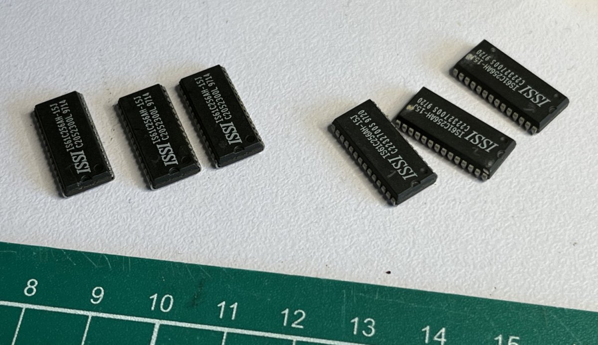

This gave me a bit more confidence to go try replacing the SRAM chips. Unfortunately I didn't have any spare ones in the parts bin, so I had to remove them from the other working MK4 board (will have to put them back later). Also the error doesn't point out which chip is bad, so will have to replace all of them (3).
Both MK4 boards have ISSI IS61C256AH-15J (32K x 8 SRAM, 28 PIN SOJ)

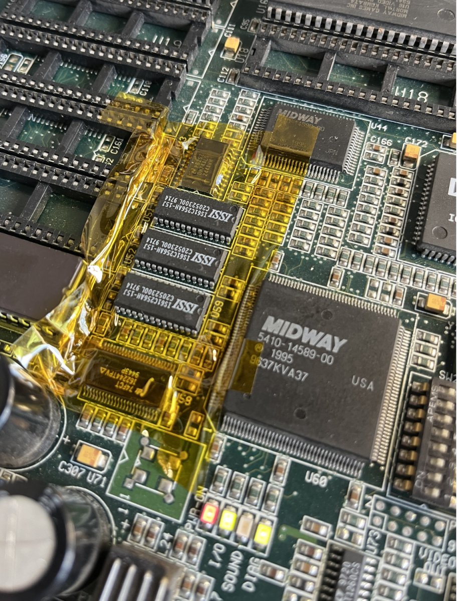

Began by marking the ICs from each board with a pencil to not mix them up, then masked the area out with Kapton tape, and then turned on the hot air station and removed them all.

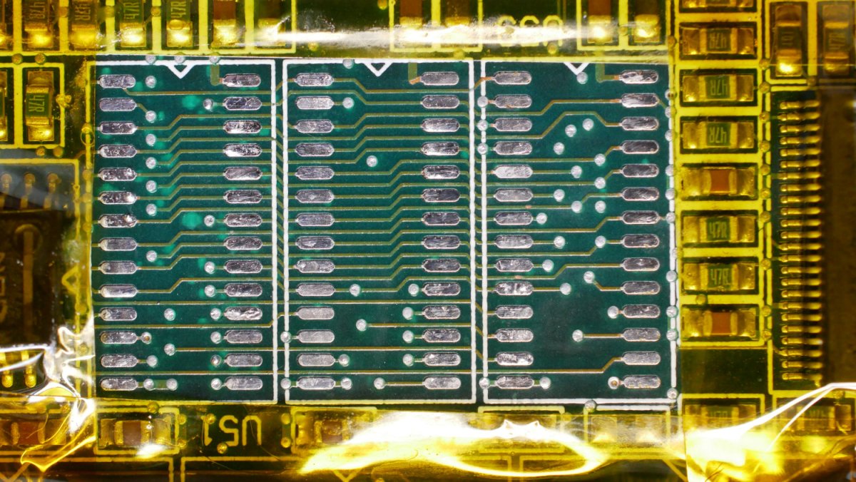

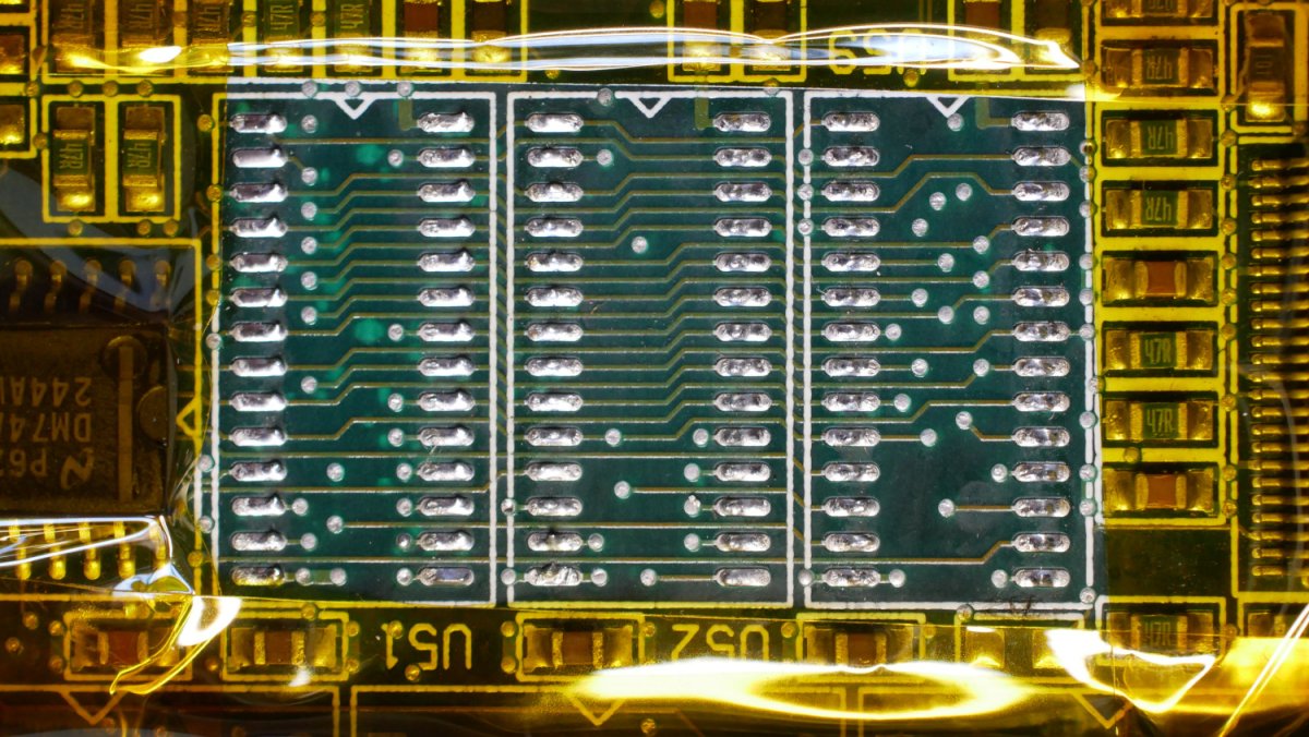

After taking all them out, on the destination board: cleaned the pads with solder wick, applied soldering paste, positioned the ICs, and soldered them with hot air.

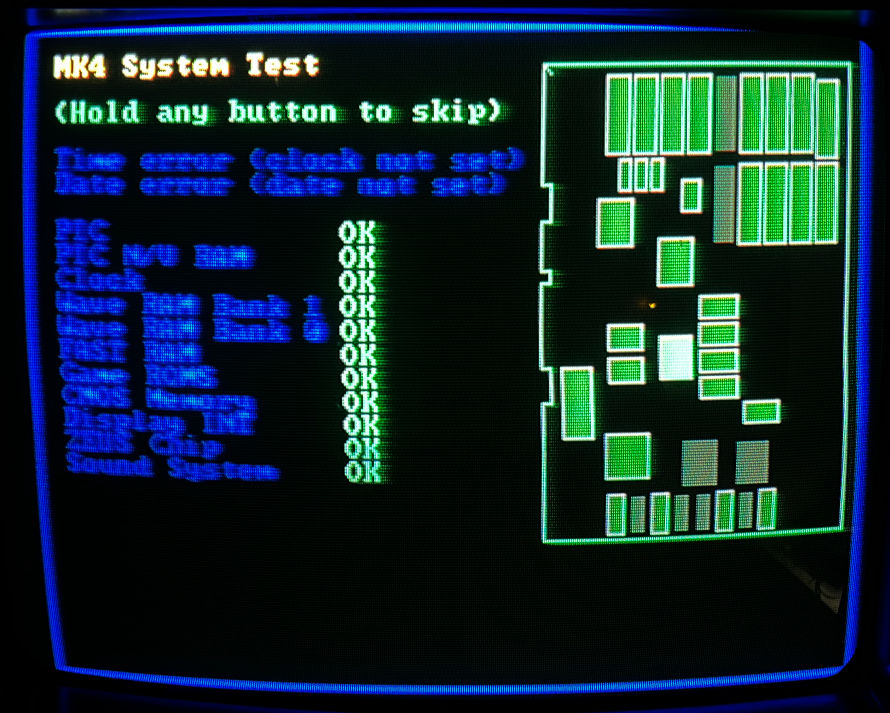

My solder paste application wasn't the best, and upon testing it didn't work. By checking each connection with the multimeter found some unsurprisingly unsoldered pins, soldered them manually with a fine tip. Checked again with the multimeter, and turned it up, initial diagnostics passed successfully (all green), and sound started coming out!, that was it. Repair done.
