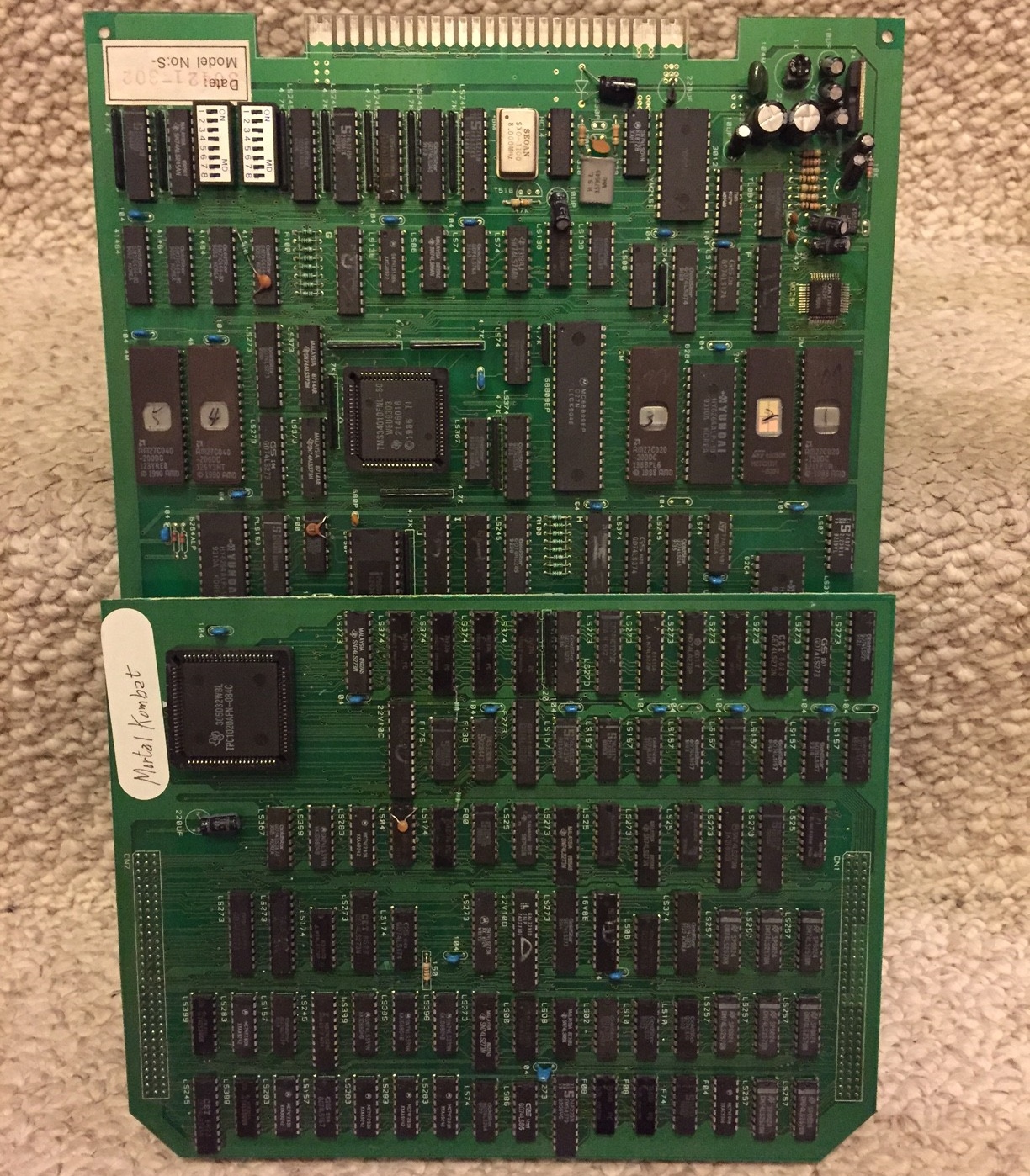

I picked this board up really cheap and it turned out to be a great bootleg (MK Revision 3.0 8/31/92, c-13234-40025). The seller listed it as for-repair because of a CMOS error at boot, but that was just the result of a dead battery.
I simply cleaned and recapped it (long-life 105C rated caps), added back the missing cap near the jamma edge, fixed botchy button wiring underneath, and added a coin cell battery socket w/rechargeable LIR2032. The nice thing about the bootleg is that it's Jamma+ so all buttons work perfectly with the HAS Supergun without a kick!

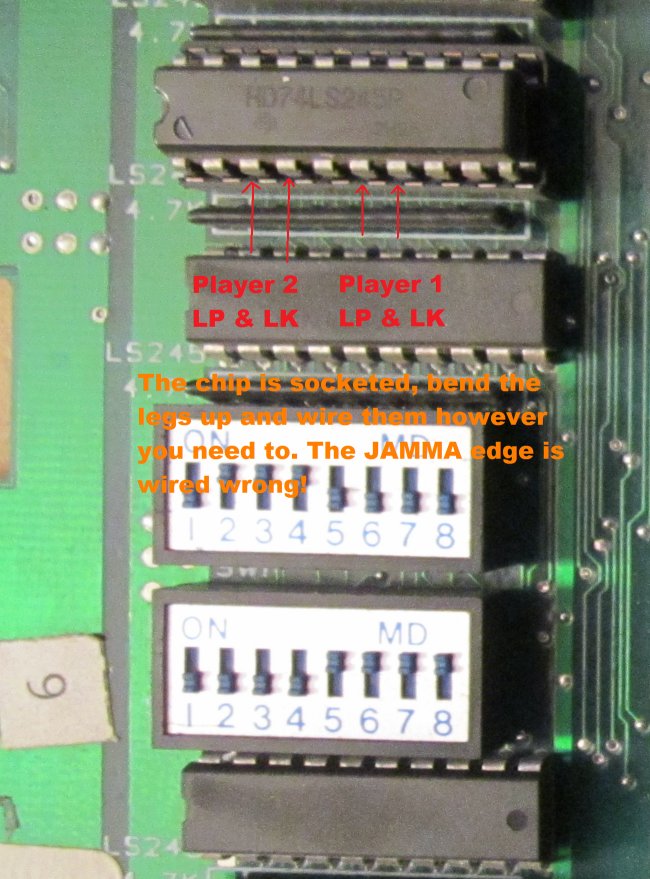

How did you get kicks for this? Through jamma I'm only getting 3 buttons. No 4th
Obviously no 5 either but right now I get 1 punch, 1 kick and block. Missing 1 punch and 1 kick.
Mine has a bodge wire or two underneath, but I don't have a picture. They connect these pins to the JAMMA edge.

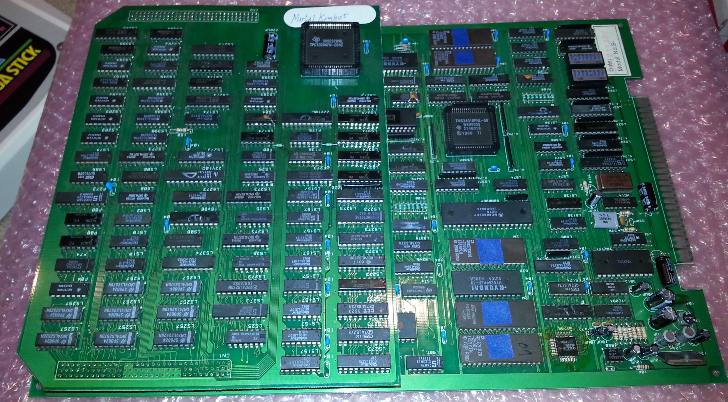

Have just bought this same bootleg based on the info in this thread, paid $US35
Will post results here when it arrives.
