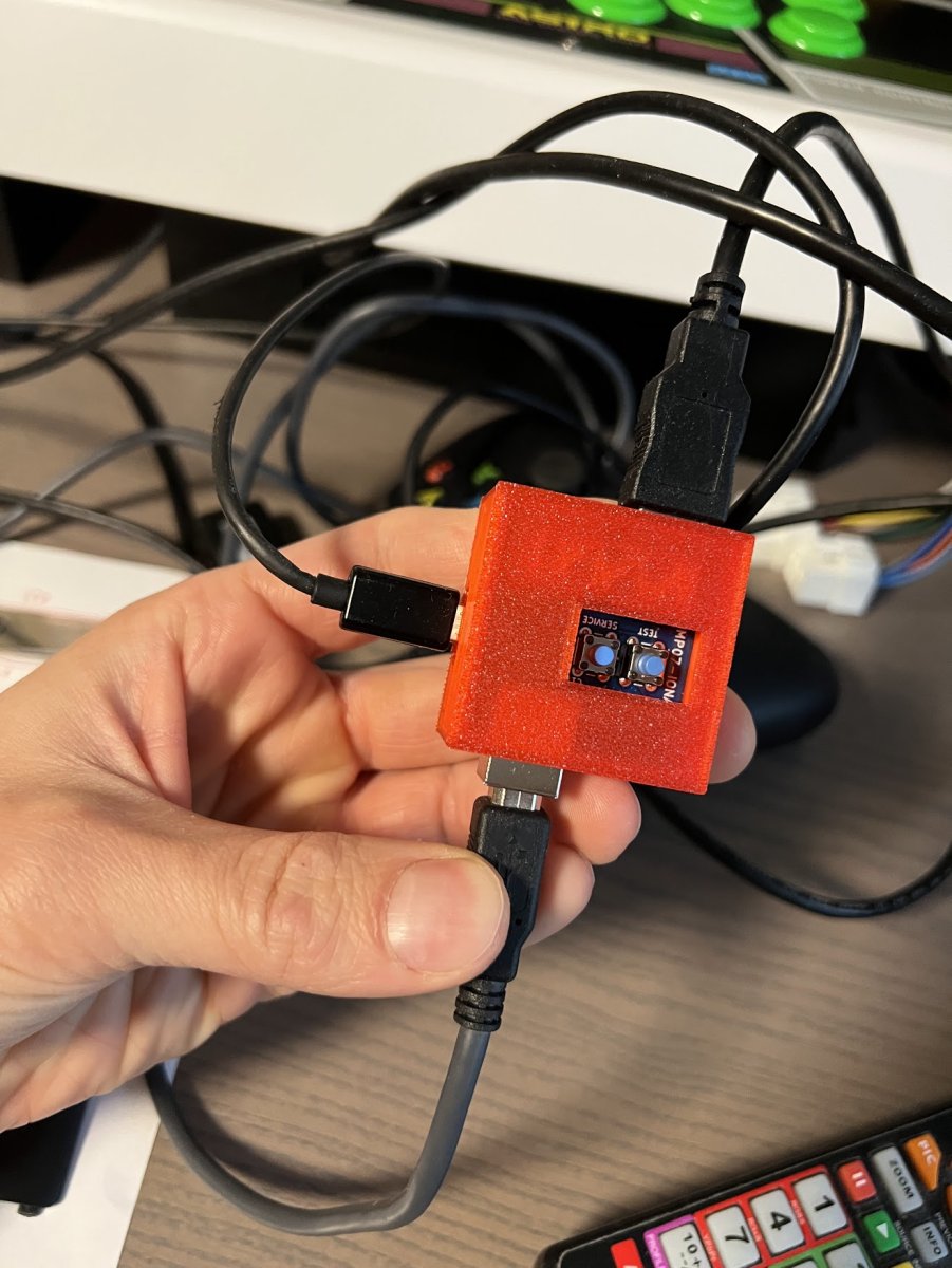

Props to @Zepherino for the case. Fits nice and snug.
BTW I was able to fix the prior issues I was experiencing. It turned out to be a faulty USB cable. I need to learn to remap. Anyone successfully do this?

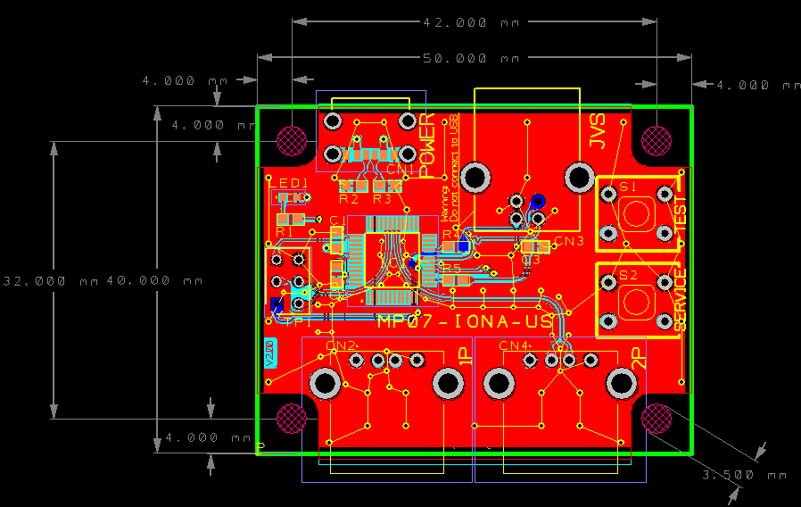

Zepherino
Mar 16, 2017
102
131
SoCal
I've had a few people offer to send me their PCB to borrow in order to make a V2 case, but what I didn't realize until just now is that toyoshim posted a detailed image on his manual page that shows the critical dimensions of the PCB. With these dimensions, and a more case friendly design due to space allowed for screw holes, I can probably just make the V2 case without needing it physically. That'll save the hassle and risk of shipping a somewhat expensive PCB back and forth. I don't think there's too many ways I can goof up the design and fit of the case, but then again... I tend to underestimate how many dumb screwups that I'm capable of.
I'll post the updated design on the 3D printing section of the forum when I finish it in order to avoid congesting this FS thread with posts.
^ This was the image on his manual page.

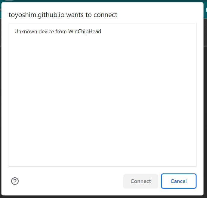

I finally got the firmware to update, although the process was a bit convouluted.
- On the computer with the "Device cannot start" message, I couldn't find a solution to make it work on that machine. I swapped over to a different Windows computer, installed the Microsoft WinUsb driver and got "This device is working properly" on the first try. So try another Windows computer if you can. Also try using a USB 2.0 port rather than a USB 3.0 port.
- After getting "This device is working properly" on the WinUsb driver, I went to the firmware update site, chose a Firmware version and clicked the Flash button. I got a "Unknown device from WinChipHead" message. It turns out that message is normal - you can click on the "Unknown device" message to highlight it, and then click "Connect" and it will finish flashing the firmware.
