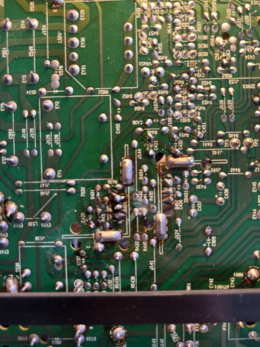

Here you go

Probably impossible to spot the fault from a picture.
Check the voltage regulator Q901.
Ideally you would have a working chassis and then you would start metering components methodically using the schematic that's available on the AO wiki, first on the faulty chassis and then on the working one. Eventually you should find the component that gives a different reading.
Since it was working before the recap, it's highly likely something that went wrong during that process. Make 100% sure that all the cap orientations are correct. I found it easy to lift pads when I recapped my MS9s, it looks soldered in but when I gently push down on a cap, one of the legs pushes through the joint and needs to be repaired.
Hopefully you took before and after pics, maybe a solder blob landed somewhere and made a bridge?
Is that a picture of before I did the clean up?
That was before your clean up.
