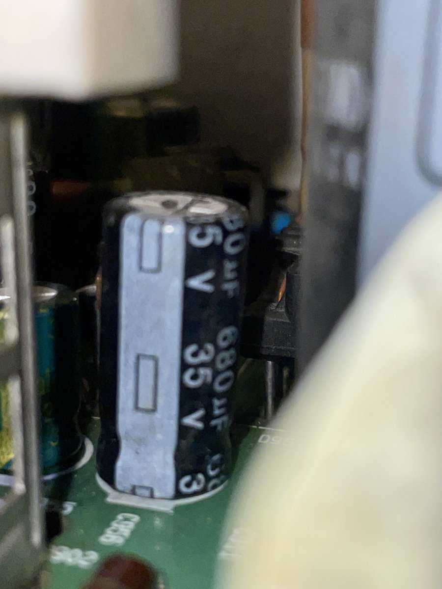

I recently got a MS9-29 15k/24k auto switch chassis, it works all good without issue except little bit typical jail bar on the left side due to old caps.
So I was planning to recap it, then I found out that there are two capacitors are different from other MS9-29 chassis I dealt with before.

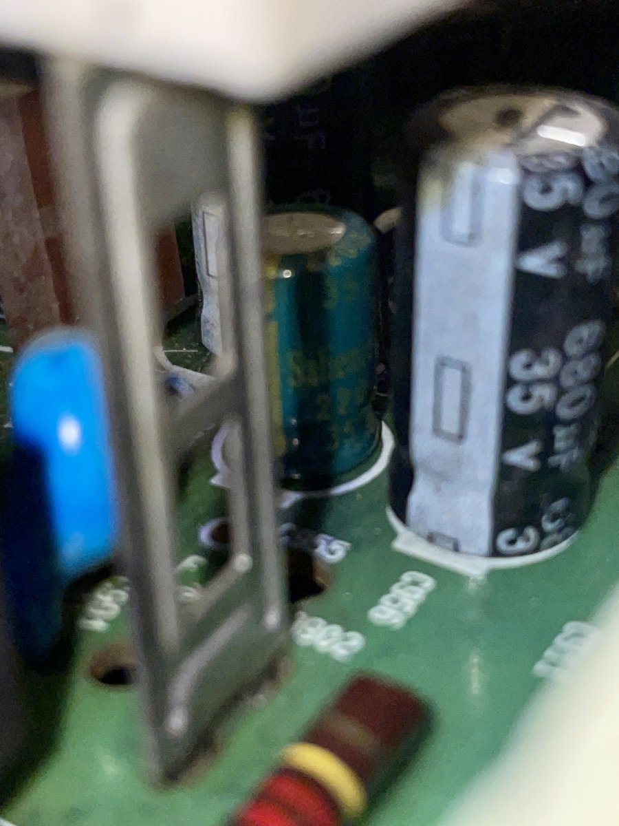

First one is C956, on other MS9-29 chassis I have it's a 680µF 10v, but on this auto switch chassis it's a 1000µF 25v(a nichicon vr series, seems untouched).
The other one is C955, on other MS9-29 chassis I have it's a 180µF 25v, on this auto switch chassis it's a 220µF 50v, when I soldered it off, I noticed the joint was more fresh than others, and the cap I can't tell its brand, also it's a 85c, so I believe it was replaced before.
Can anyone confirm what these two caps C955 and C956 should be on a MS9-29 15k/24k auto switch chassis? Thanks.
