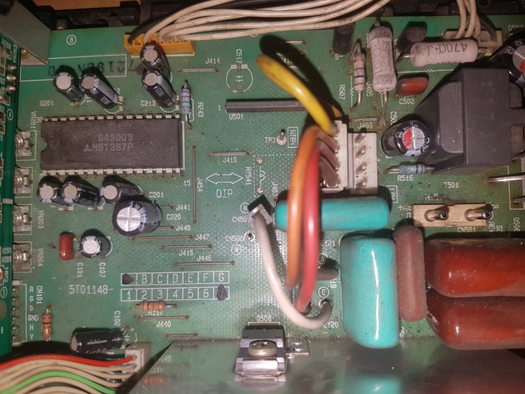

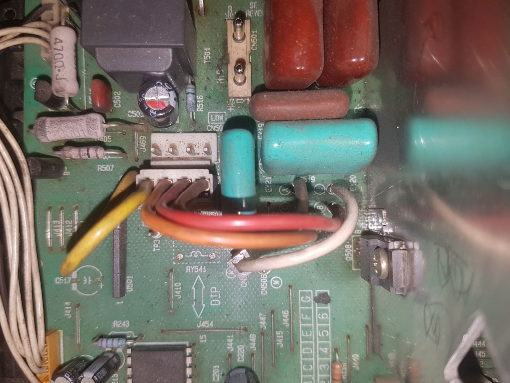

I have one MS9-29 in 25khz from a sega rally cab, and I would like to set it to 15 khz what's I must change here please?
THX

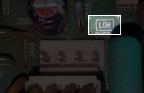

The above answer is correct, but just pointing out for reference that the correct connector actually says LOW next to it, for low resolution. You're on the HIGH one, which is actually medium, but hey, in this context it's good enough.

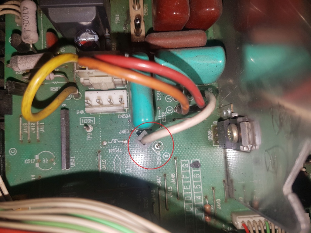

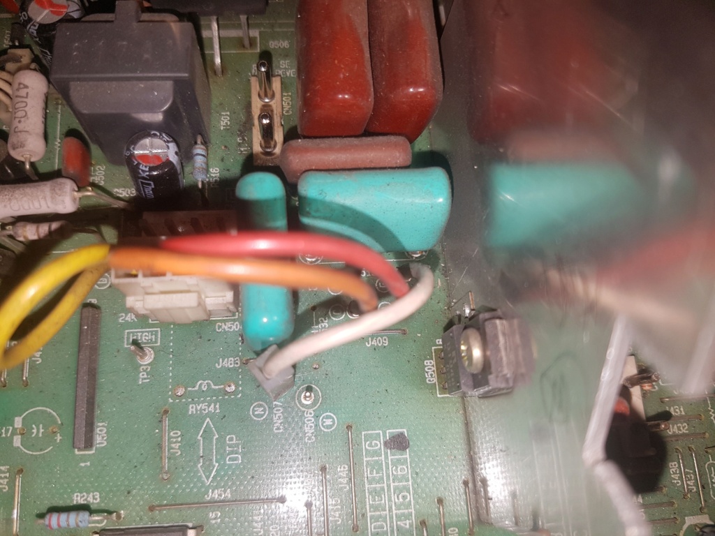

THX all could you just confirm if I am in good...could you confirm in my picture if the CN057/506 is good:
IIRC the circled letters next to each are for Normal and Wide, and for most things you just want it on normal. Or maybe the N is Narrow. Either way, if it looks fine you're good.
