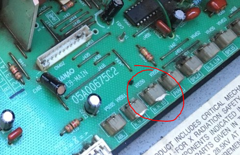

Ì have two New Astro City`s, that im about to restore. One of them had a broken Monitor, so i replaced it wit a MS9. No burn ins and in a good condition, but when i put in my MVS (you can see Sidekicks 2 on photo), i receive that bad picture. What do i need to do? Do i have to put a jumper or something? Sound from speakers is okay...

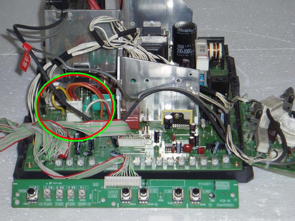

Without much info I would say double check you have the 15 khz jumper plugged in on the chassis and not the 24khz one. Could also be a sync issue which can be adjusted via the pots. But double check the jumper.
Yes, it really was on the false jumper. I wonder myself, for what cab the previos owner user the monitor for...
But unfortunately, picture is slightliy better, but still like spagehetti. What can i do now?
