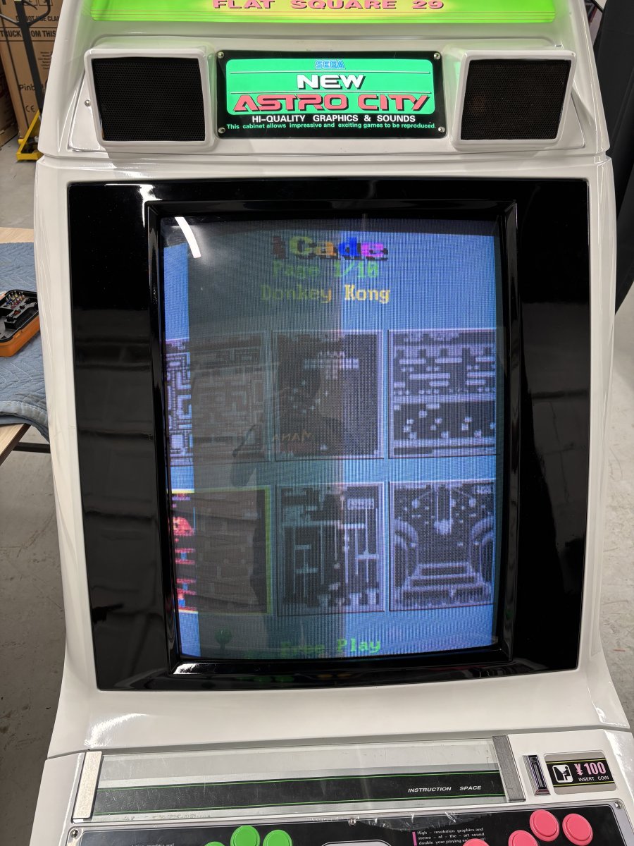

Our shop sold a NAC with an MS9 in it and the customer wanted it rotated to put a 60 in 1 for the time being. After I rotated it though, the monitor developed a large bend on the top right, is this interference with the speaker at the top? Or is there a way I can adjust this on the chassis? Thanks!
SPC15 on the chassis. It's easily adjusted now that the monitor is rotated. Just open the service door and look for the pots on the bottom side of the chassis.
Perfect I'll take a look next I'm in thanks!

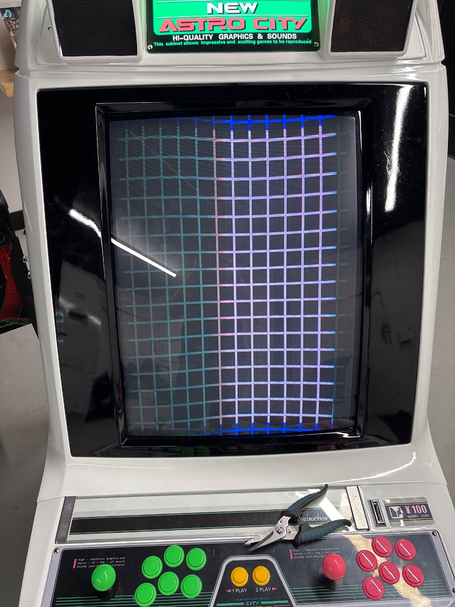

Perfect, that fixed that really bad curve on the edge, anyway I can fix the curves in the middle of the monitor (top and bottom)

You should also adjust the Trap pot. You can get the left and right side more uniform with each other.
As for the curve in the middle, the chassis probably hasn't been recapped?
I would also check that the B+ settings are correct. To low B+ will do that to your picture.
