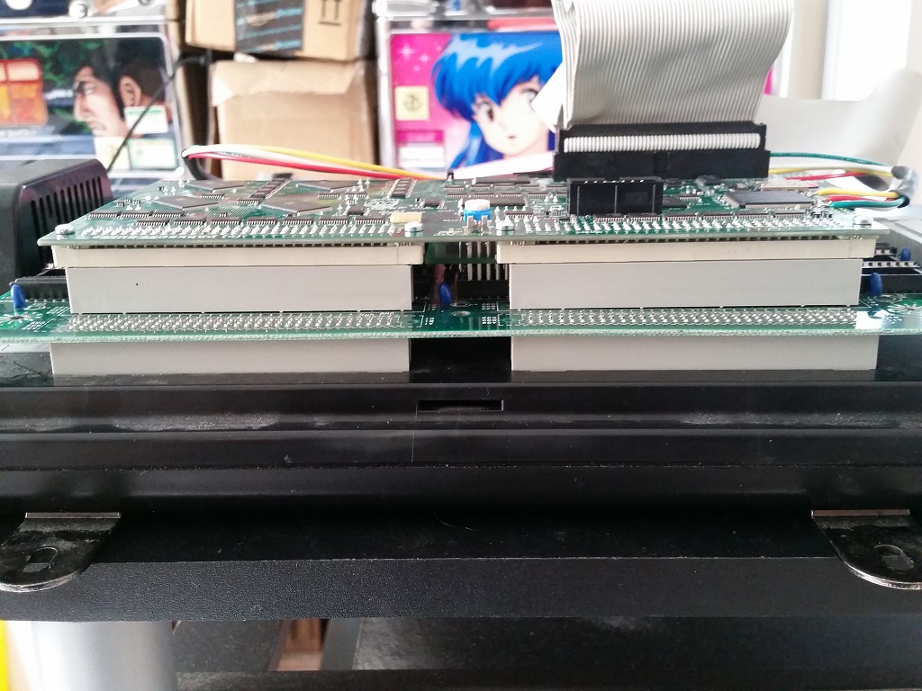

It was a little tricky seating the multi kit as the sockets were very tight, but everything lined up fine and did seat.

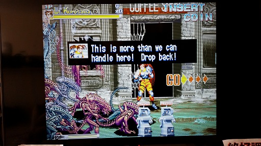

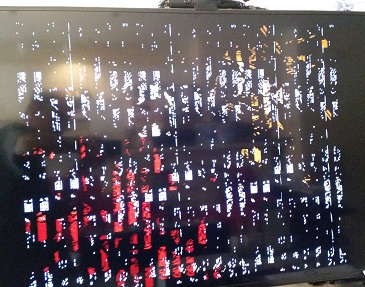

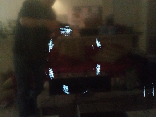

1944 shows mostly a black screen with traces of graphics,
but the sound and music seem to play clearly.
AVP which works natively, does not. I also tried an unencrypted version.

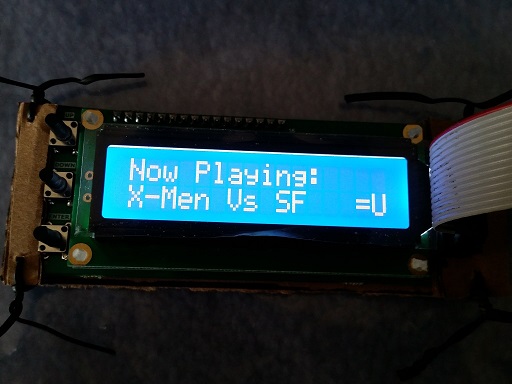

Xmen vs SF shows the most life but the graphics are all messed up. The text is unreadable, and each graphic plane is looks to be mostly single color.

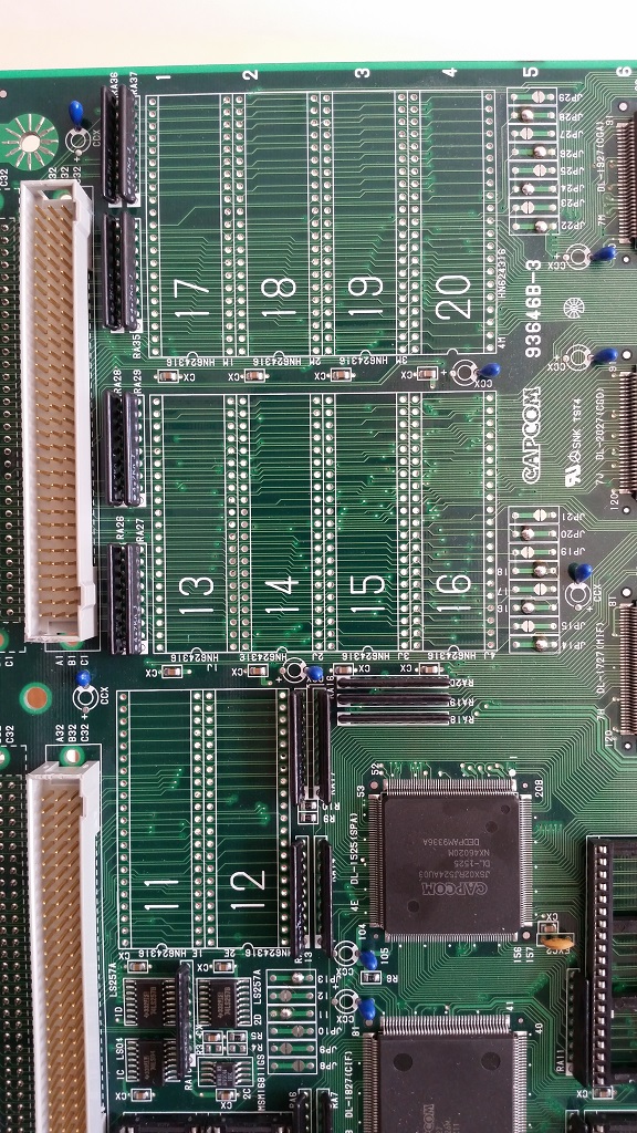

I am wondering if its worth replacing the program and graphic sockets.

Are those graphics kind of responsive or is something going on in the background?

Both those games are running and responsive. I have a video of Xmen vs SF showing it in motion, but am not sure how to post it.

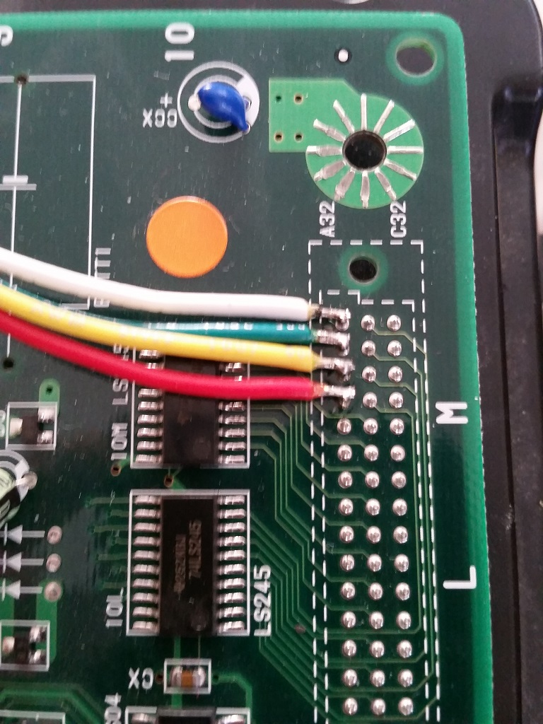

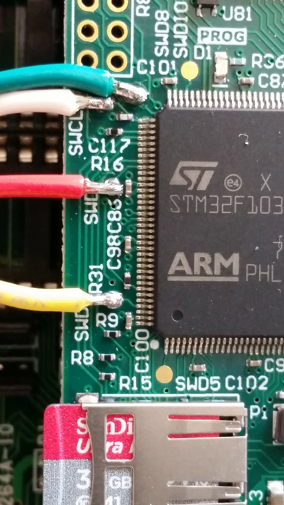

P.S. those cables for the key programming are a bit oversized IMHO. Are you confident that no solder blob has fallen somewhere in the PCB? Please double check.

The pins all aligned and are in the sockets. I will try to make a smaller gauge wiring for the key writing.
I used what I could easily disconnect, I know it was a bit big, and It soldered pretty clean crowded on the kit attachment point.

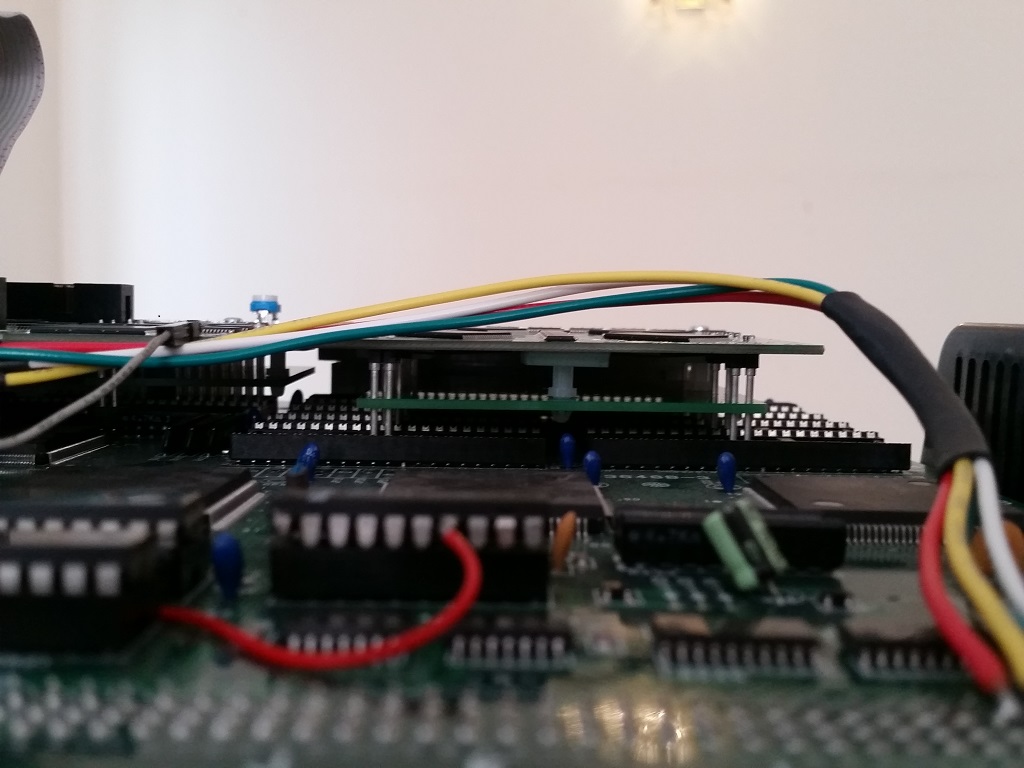

Check connection between A and B (bent pins) and failing that, I had one here with a similar issue.
I fixed that one by slightly pulling the IDC connectors on the multi kit away from the B board, it's still making a good connection and it's not going anywhere but I think pushed all the way in was causing enough flex on the board it was pushing the mask ROM pins out of whack.
The other solution is to replace all the sockets since they're likely worn and causing your problems, but this may work.

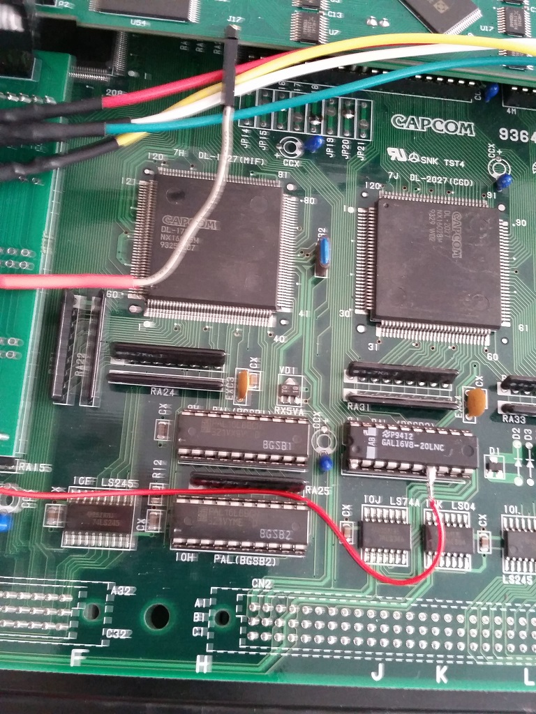

I see a red wire soldered to the gal chip but a grey wire connected to the j17 pin on the multi. Did you splice those together? You have a revision 3 pcb so check the bottom of your b-board. If there is a jumper wire underneath from a pal pin to the connector you need to remove it.
OK, I tried adjusting height on the main kit board from the B via the 2 3 row connectors and if anything it decreased the sound quality. I have mostly been trying the B with out the plastic shell, but the A has been cased/unopened.
@[u]@Mitsurugi-w[/u] The wire is spliced, there is no jumper under the b board.
After all this, I did replace sockets 11-20:
after replacement
To make sure I did not break anything, I put AVP back in afterwards to test:
When I reinstalled the multi kit, there was no change, it is behaving exactly the same as before the socket replacement.
That being said, the main board did seat very smoothly with the new sockets.
No, I programmed both the f/G and the B (for AVP). I can recycle the B or I have another unused Gal somewhere.
Sharp eyes, it lost the leg and was repaired. It was originally on a CPS1.
It has been reading and writing fine, and due to bending a leg up to solder I wanted to use it first. I'll prep an alternate then to rule it out.
