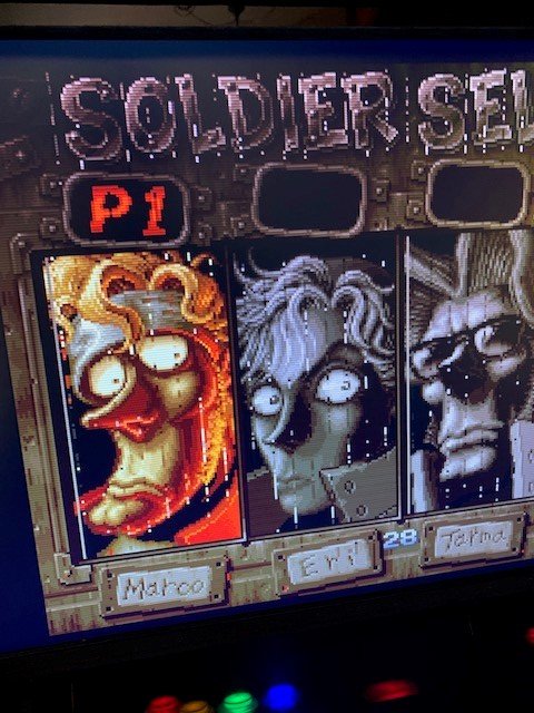

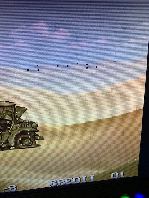

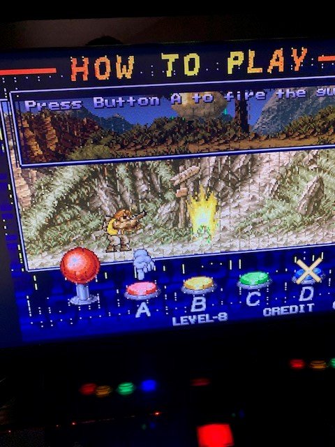

Hi All, my MV-2FS started recently displaying some issues, see below. It's not the game cart as it happens no matter what cart i put in,. Does anyone have any hints as to what might be going wrong with my board?
I took the multi out and tried a 161in 1 cart and it has the same issue. I’ll try cleaning the slot and carts and give it a try.Does cleaning the contacts on the multi, reseating it as well as the SD card fix the issue?
Thanks! i'll have a look and report backSince the issue is happening on both slots I would start by checking continuity between the 2x NEO-257 and the NEO-ZMC2 in the top left of the board near the battery.

The those NEO-257's take the CROM data lines from both slots as inputs and outputs the correct one to the NEO-ZMC2 depending on which slot is active.
