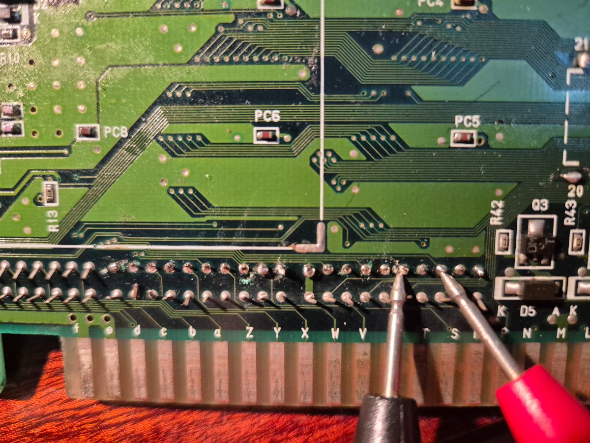

First watchdog’ fixed that with broken trace on bios pins. But still only boots on diag bios. Stock and unibios still watchdog.

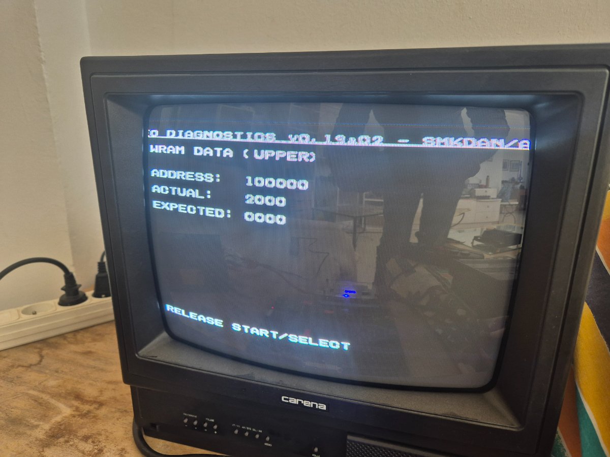

Now i have WRAM DATA error as follows, and tried replacing first Upper ram, than lower, than back up, than bunch of H32 in the pin path, but no improvement.
It's exactly the same error occuring.
Tried to track wram traces, seemed fine, but not sure if they might be going to more than one direction.
This is the data i could gather, hoping someone can figure out what to check next.

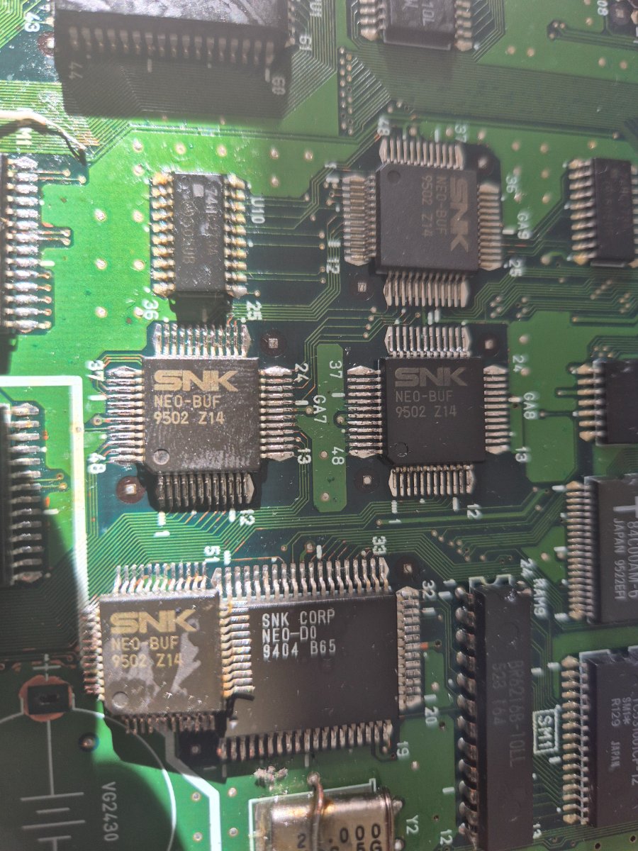

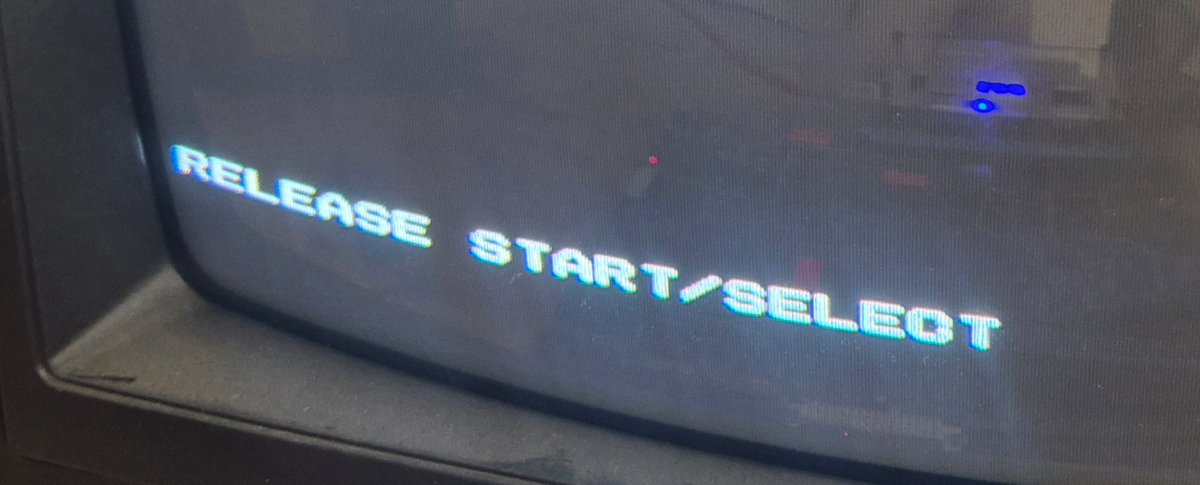

Didn't pay attention to the diag screen in the bottom, which start/select seem to be active, even i unplugged the controller.
So this led me (a blind shot to be honest) to one of the 3 Neo-buf on the audio section, which on or some of them handle too the controller input. After swapping one by one, i found out that WRAM error disappeared wih the one on position GA7.
Now the WRAM error disappeared thankfully. I can boot Unibios m also, no more watchdog. The BUFs are pain the A** to diagnose.

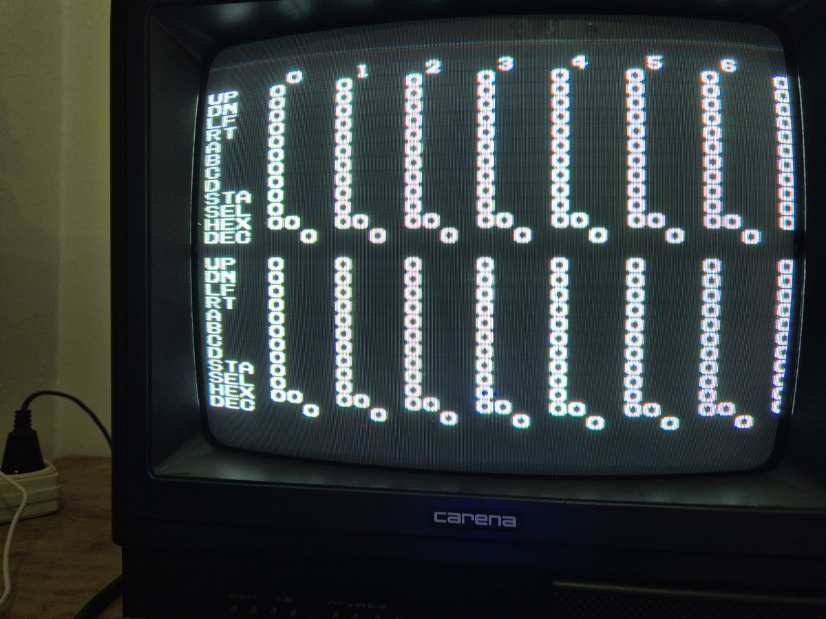

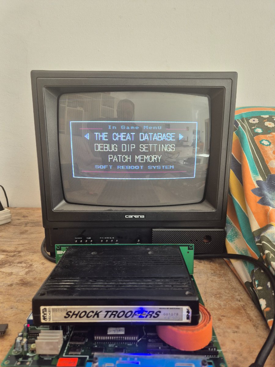

Two problem remain:
-Start/Select still permanently active, Game goes directly to Unibios Cheat screen, and other buttons dont work. Not even directions.

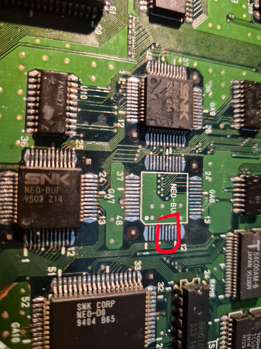

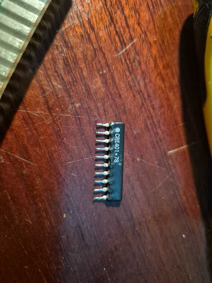

Checking out continuity, found that PINs 10 & 11 of NEOBuf in GA8 where shorted.
Tracked it back to Resistor pack in CR6.
Comparing to other pack, pin 3 & 5 are not supposed to be connected. Seems it suffered a damage or current load.
Anyways, swapped it, and Start/Select are finally released. One problem solved!

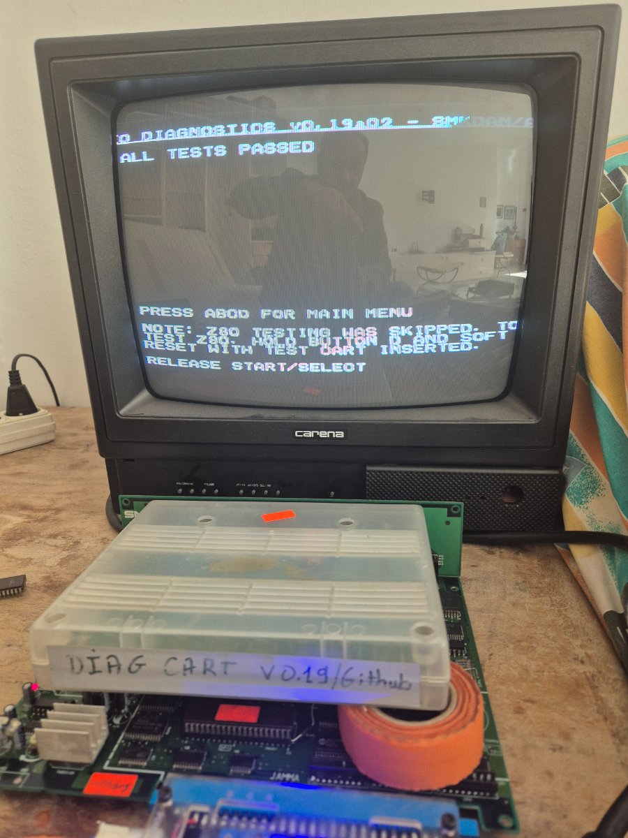

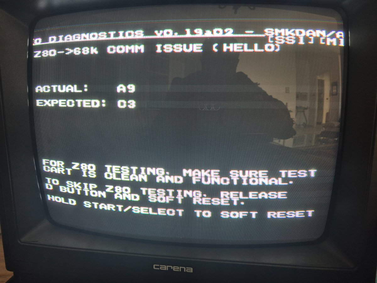

Now final issue, games boot fine, still without sound, and diag with cart gives me following error, along with 2 beeps 1,0.

Try the backup ram tests in the diag bios.
Getting only 2 beeps is weird, perhaps there is some issue talking to the ym2610.
If its easy for you to update your diag m1, you can try this version
https://www.mvs-scans.com/misc/neogeo-diag-master-next.zip
It adds error addresses to the diag m1. After playing a beep code it will jump to a specific address in the rom and loop. Using a logic probe you can probe the address lines of the z80 to determine where it stopped and from that the error code.
There is more info here (search for "Error address for Z80")
https://github.com/jwestfall69/neogeo-diag-bios/blob/master-next/docs/error_codes.md
I'm not sure, but it maybe impractical to probe the z80 on a MV1A while a cart is installed.

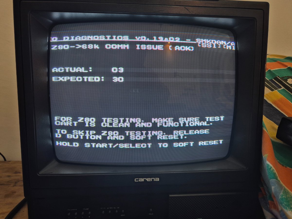

Z80 : half guilty
After replacing Z80, the anoying scratchy sound disappeared, and i got finally a new error and 001100 complete beep.
I think this gets to the starting point of @kissedin 's thread where he has exactly the same error on the same slot.
Damn what a coincidence..
