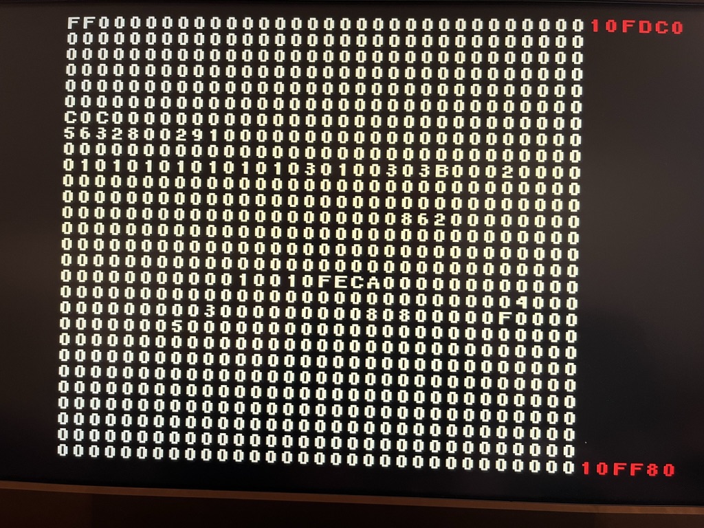

Kinda stumped. Everything seems fine other than this, and the calendar doesn't really matter. But this is super weird. It's not that it isn't keeping time, it's that the time isn't being stored. So an issue with the BIOS? Not sure how I would go about the calendar memory read/write diagnostics. Could go into the memory view of UniBIOS and check the relevant addresses... but don't know that it would tell me anything.
https://wiki.neogeodev.org/index.php?title=BIOS_RAM_locations#Calendar_Related
I guess that if I see the correct values there, it would tell me that it's a read not a write problem.
Edit: not seeing a reasonable way to scroll to those memory locations in the standard stack viewer. Will try the 240p test suite.
Need a sanity check... using the 240p test suite and a board that is working correctly (I can set the date/time) I'm looking for the 10FDD-- memory region for the date (set to today). But I'm not seeing it. 10FDD2 should be set to the two digit year '23' (17 in HEX). But not seeing anything like that. Need to figure out how to read this before trying on the board with the problem.
