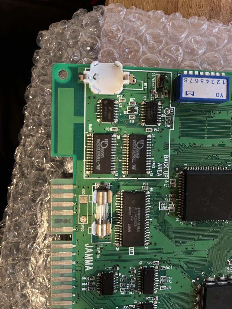

I use these in the OMVS builds I made, they work well but will require shaving off the mask to expose the ground plane:
Dahszhi Button Cell Battery Holder for CR2032-10pcs https://a.co/d/5Eoxdpo
So you're going to a secondary pad for the positive connection? Interesting, hand't considered that. My only concern here would be the extra width this ads for systems going into a consolized case. Not found a good fit for those. Wracking my limited knowledge on the subject re: supercapacitors since that's such an easy solution.

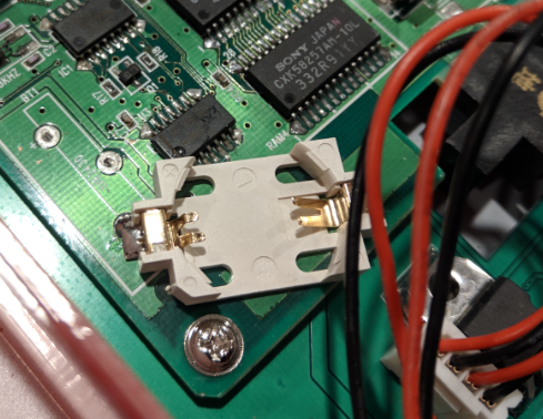

Looking at an old school aliexpress "CBOX", things are pretty tight. But one option would be to go somthing like this.
For what it's worth, I've battery modded multiple boards, and the ones JNX recommends always worked out fine for me, and even fit just fine in a case without much clearance.
Question, checking a MV1C that via you show connecting to (-) on the battery isn't used by anything. Did you run a wire on the underside? Or did you scrape away the ground pane next to it. Still exploring options...
