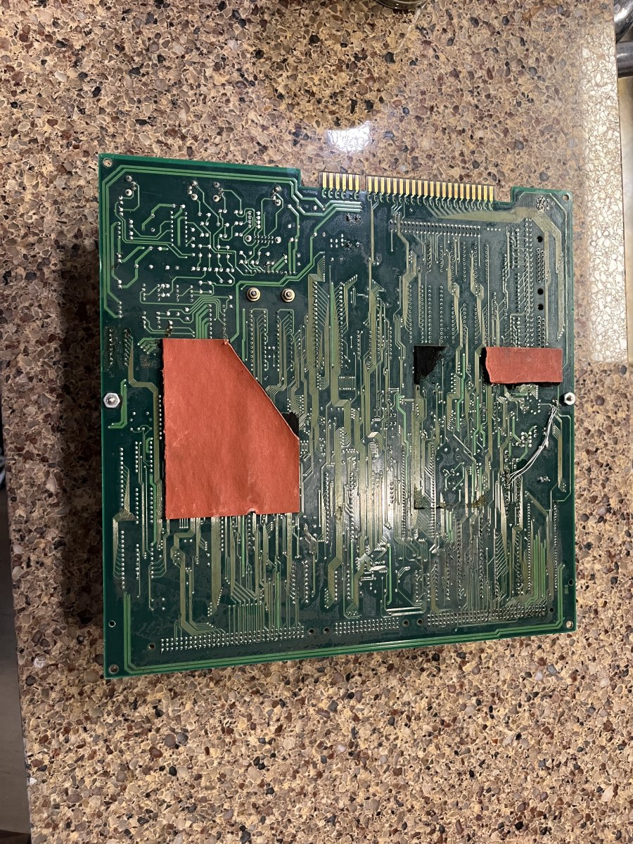

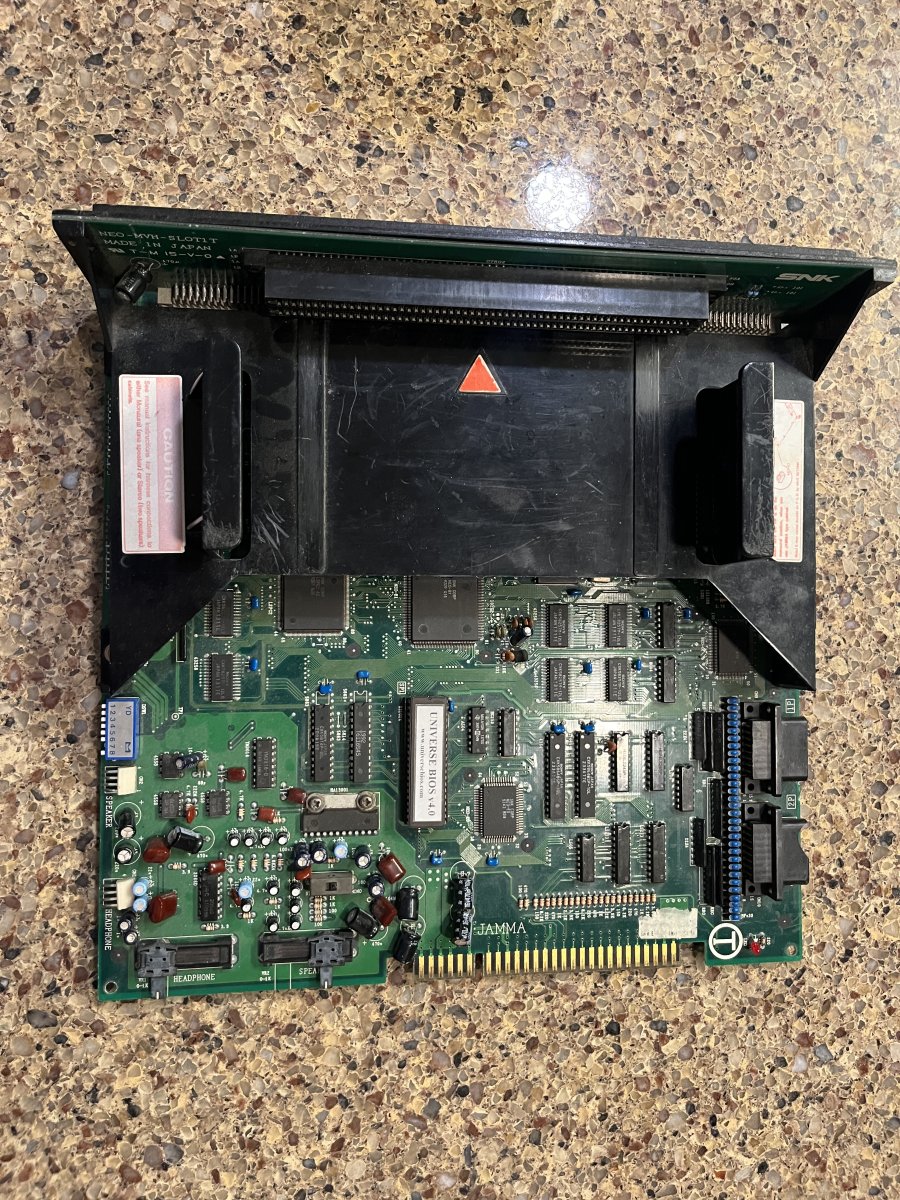

Yesterday I accidentally left my MVS on over night. It was still running when I checked it but it crashed as soon as I touched the cart. I reset the board but now I am getting a watchdog error. Attached is a video. Anyone have any ideas on where to start looking?

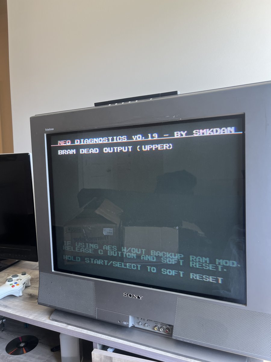

Finally used the diag bios today and got this error. Any ideas?
