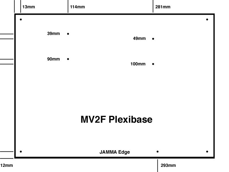

I could never find a guide for the top plate. I grabbed the MV2F base plate guide from Jamma Nation X, but it doesn't match up with my MV2FS so I couldn't use it. Wound up custom marking mounts locations with a pencil while laying the board down on a sheet of MDF.
seems not match also my MV2F

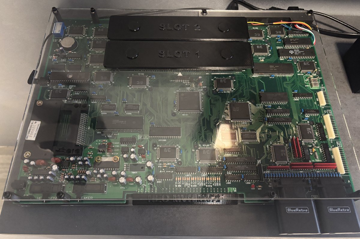

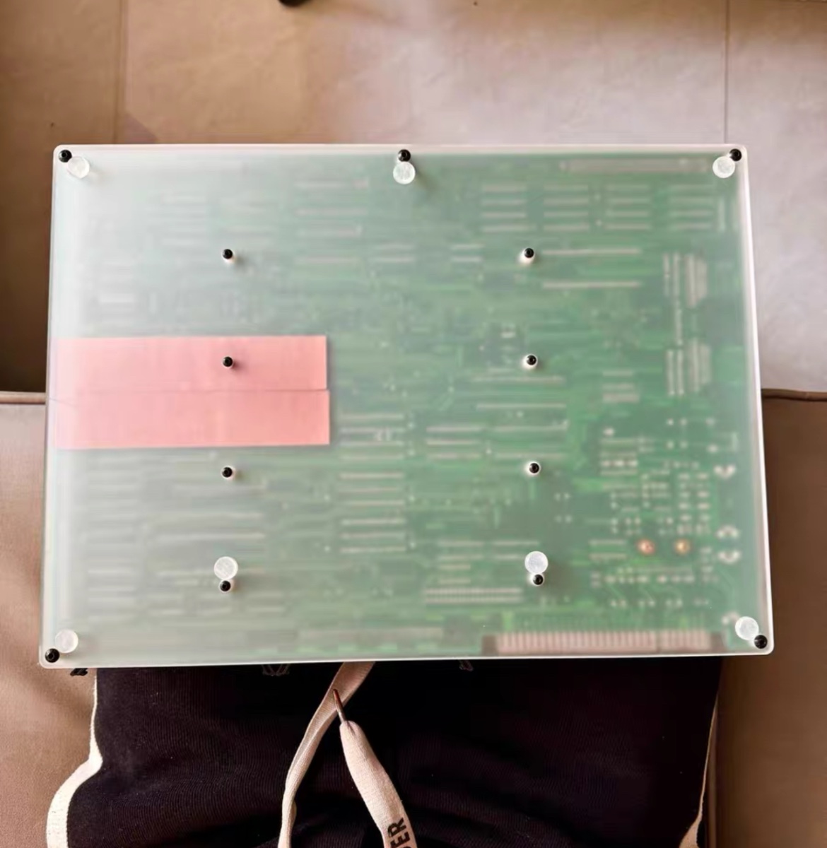

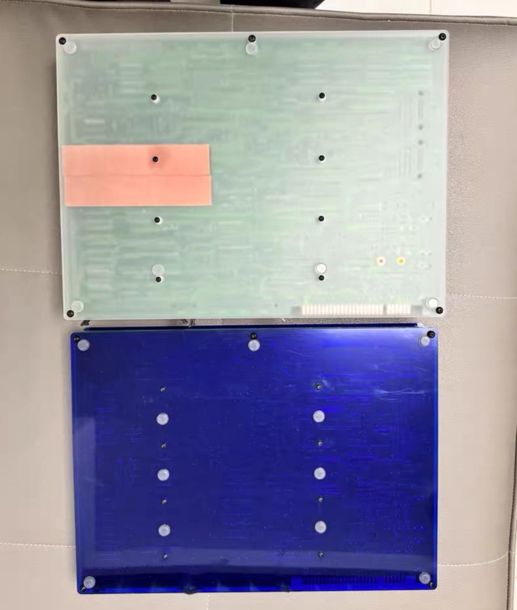

Hello Guys,
One more mission is over for me, i'm happy to confirm you all the plate dimension.
I have tested it and its correct !
Now look at my last MVS consolized. :love:

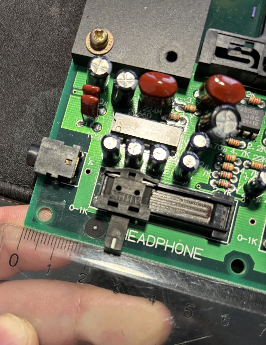

( USB ((Video)) - Coin botton - Power botton - 5V in )
