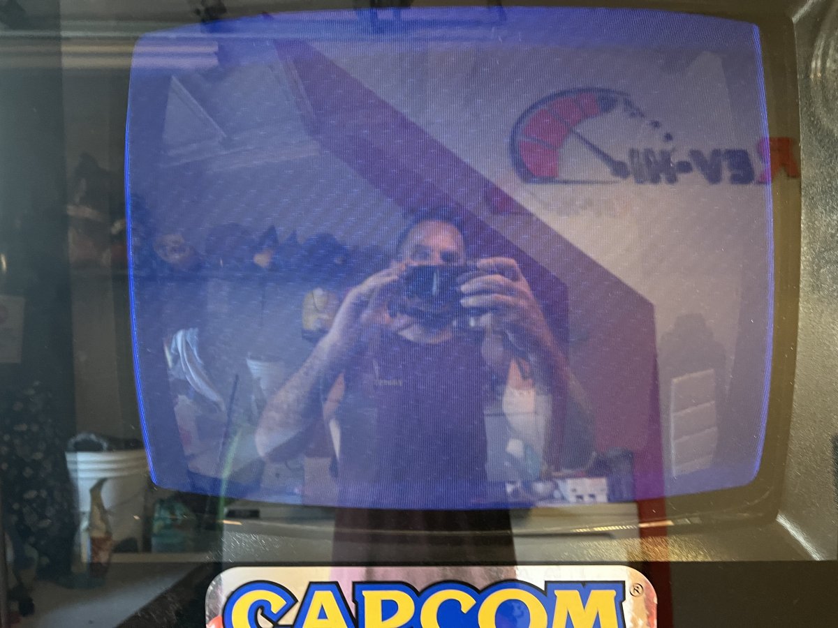

I’m hoping this is the right area to post. I have a MVC2 cab, some days the game works fine, but today about 10 seconds into the first fight the game freezes. If I power cycle I get about the same freeze. Any tips on where to start ?
Also the CRT has a lot of lines in it, I adjusted the pots as best as I could but wondering if there is a specific one to focus on to minimize these.
Any help is appreciated, Aloha

The voltage was a bit high, I lowered it to spec and it seems to be working now. Any idea how to clean up the CRT? wondering if its interference
