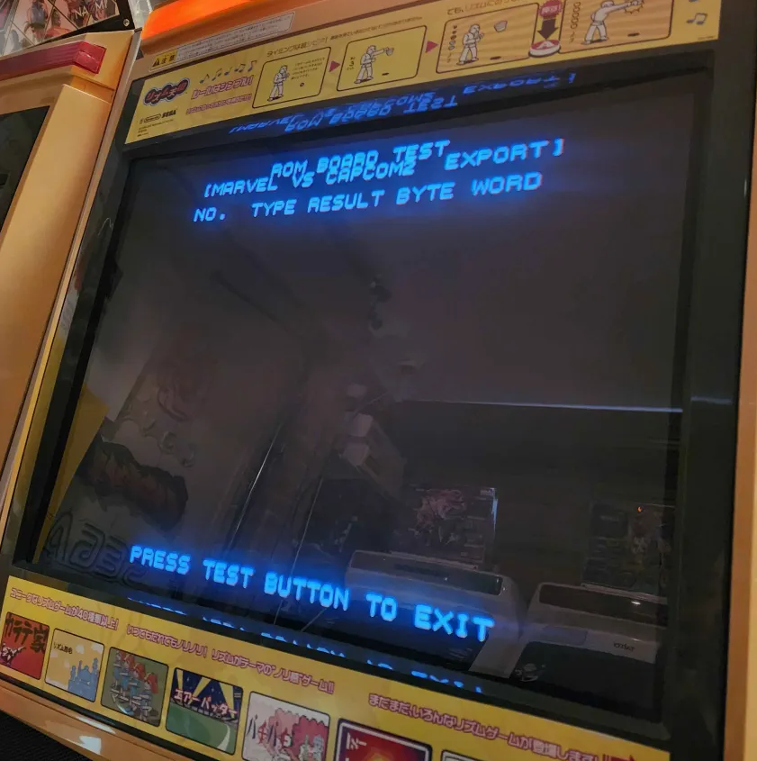

Hey guys,
Just a quick question.

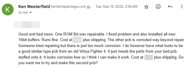

I've got a couple of MVC2 carts that Ken fixed for me a couple of years back
I'm looking at selling one now (the one that wasn't a transplant). As I went into the ROM test, I just get a blank screen like below, no matter which BIOS I use.

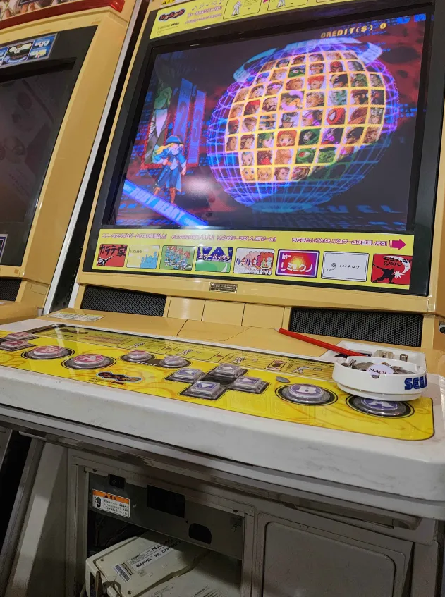

The game works perfectly fine
Could it be because I have the "unlocked characters" EPROM on IC22? I don't have the original EPROM so I'm not sure if that's the issue. This happens on both carts that Ken fixed for me.
For my cart, I couldn't care less as I know it works, I just know there might be some concerns with others that may want to purchase the cart.
Anyone ever come across this before on their MVC2 cart?

which type is your MvC2 cart(s) ? there exists 2 PCB types. it would be nice to see PCB photo
does your games have "rom board test" option in game test mode?
which BIOS version is in your Naomi ?
in general, I'd imagine your cart is 171-7978B (Actel) type, but currently it have program EEPROM from 171-7919A cart version. or something like that.
I would've thought this could've happened with the cart Ken "transplanted" but he only did one as he was able to fix the other cart, but since both carts exhibit the same issue, I thought it may have been the eprom. I mean I've played the game through and it all works as expected, I just think potential buyers would want to see the rom test board screen be "OK" if I was to sell the carts.
thanks, this is indeed original MvC2 PCB, Actel type, with original for this game Actel FPGA
no, I meant go to GAME TEST MODE at your photo, and check if it have "ROM BOARD TEST" option
The only thing in the GAME TEST MODE is
INPUT TEST
GAME DATA
GAME CONFIGURATION
EXIT
@mR_CaESaR then my 1st guess was right - program EEPROM in your cart programmed with MvC2 version for 171-7919A type cartridges, which don't have ROMs checksums for Actel-type cart in game header (as result you see empty ROM TEST screen in BIOS) and missing "ROM BOARD TEST" option in game test mode.
I'd say it may be ignored, if your game works fine
it may not work after this. I suppose there was a reason why cart was programmed with this ROM (something broken in protection/decryption part?)
however it may be not bad idea to read program EPROM, "paste" to game header checksums for Actel-type carts and program it back.
I may provide checksums and instructions for you, or paste them by myself if you'll dump your ROM and share data.
PS: strictly speaking, I suppose it's kind of my fault :D I've did protection hack of MvC2 171-7919A type couple years ago, mainly to help "fix" cartridges with something broken in protection part, but I've not expected it may be used in Actel-type carts :)
