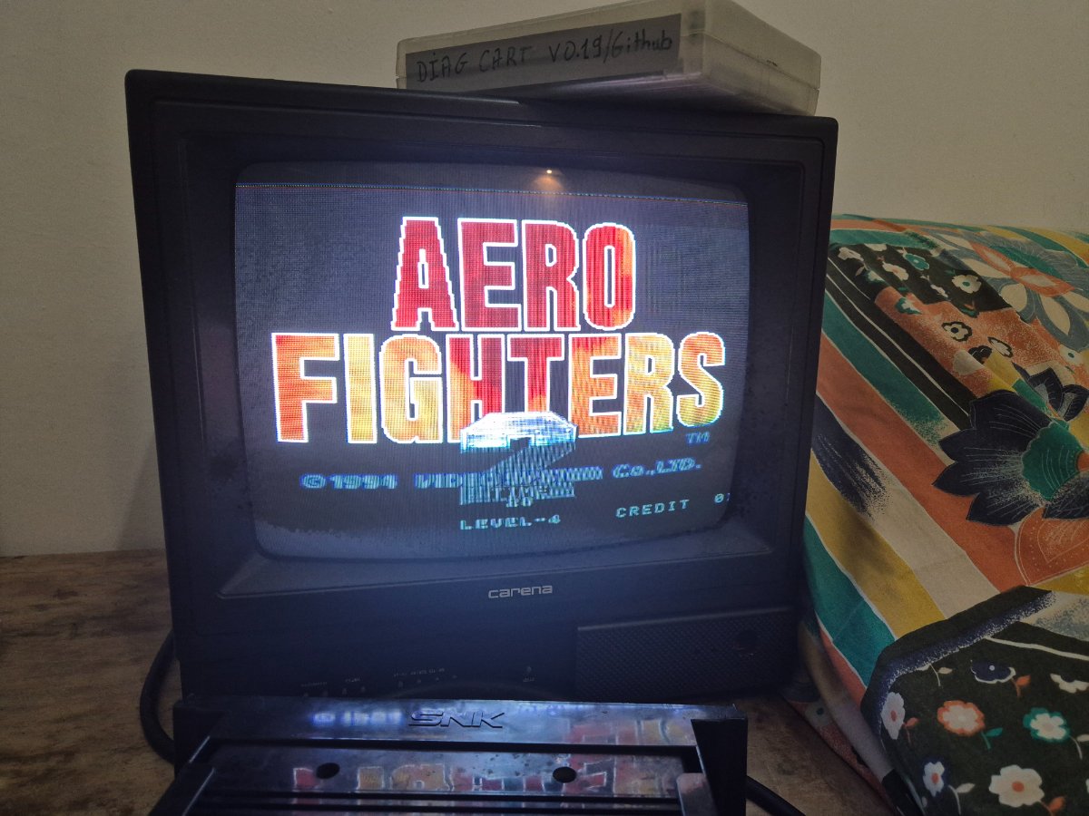

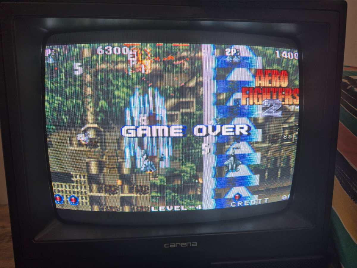

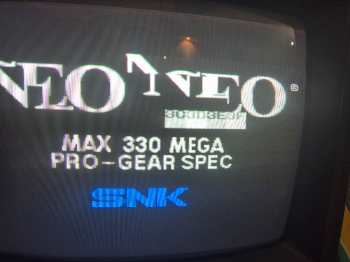

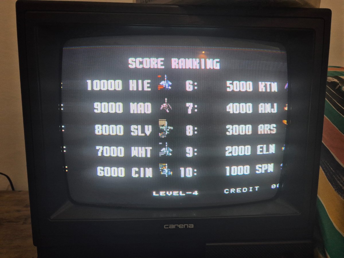

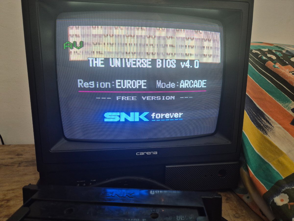

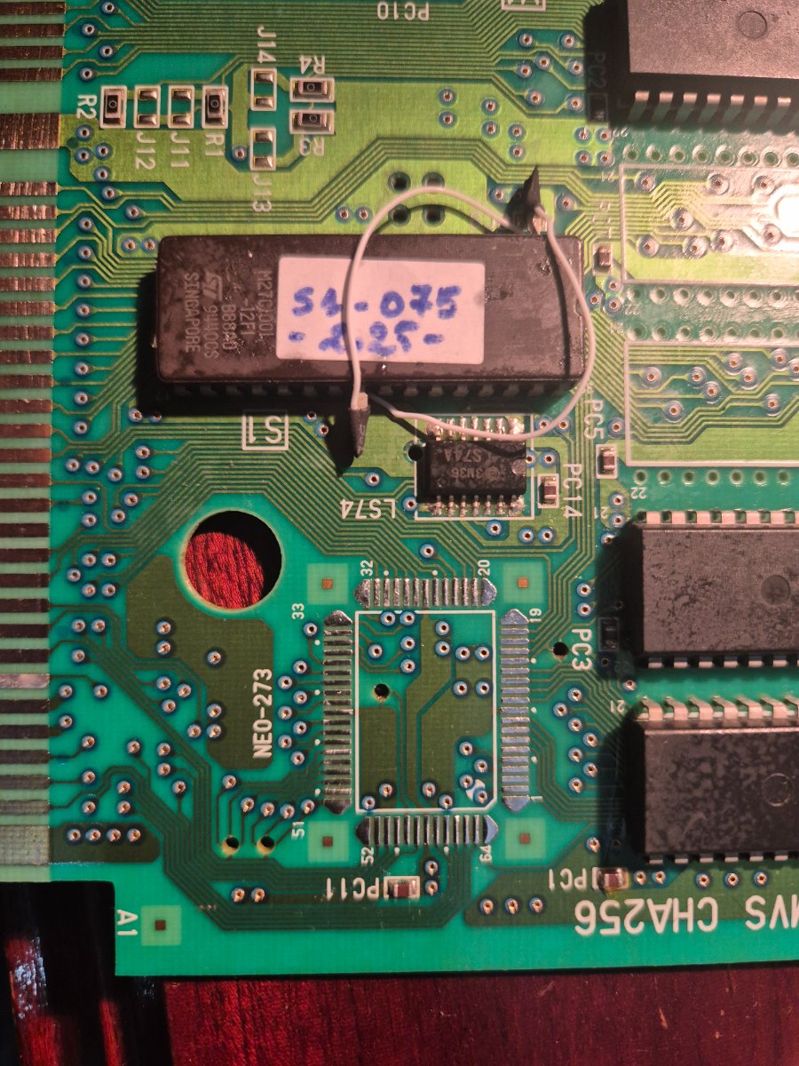

This one is driving me crazy.
The exact same glitch is present whaterver i do.
What i did so far:

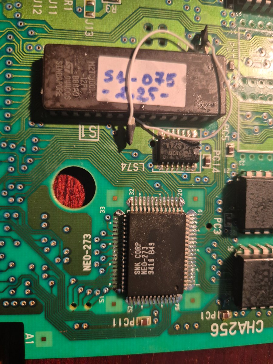

- Both PROG and CHA borad cleaned and checked for brocken traces. Found 2 and patched them.
- Checked PRom CRC in Unibios and it matches OK.
- S1 ROM does not match CRC in Mame so burnt a replacement eprom
- C1 to C4 match fine with Mame.
So after all this, text no shows fine in unibios, but the exact same glitch is there, no improvement.
To be honest i'am lost..
UPDATE AND FIXED.
That b**ch costed me few hours testing continuity to deduce that Neo-273 was dead. Replaced with the first, seemed f*** up also, so before shooting the mf i gambled and changed 2nd time the 273. And it's alive!
I never saw before graphic glitches due to defective neo-273.
Well let's keep this for the record, if anyone needs it.
