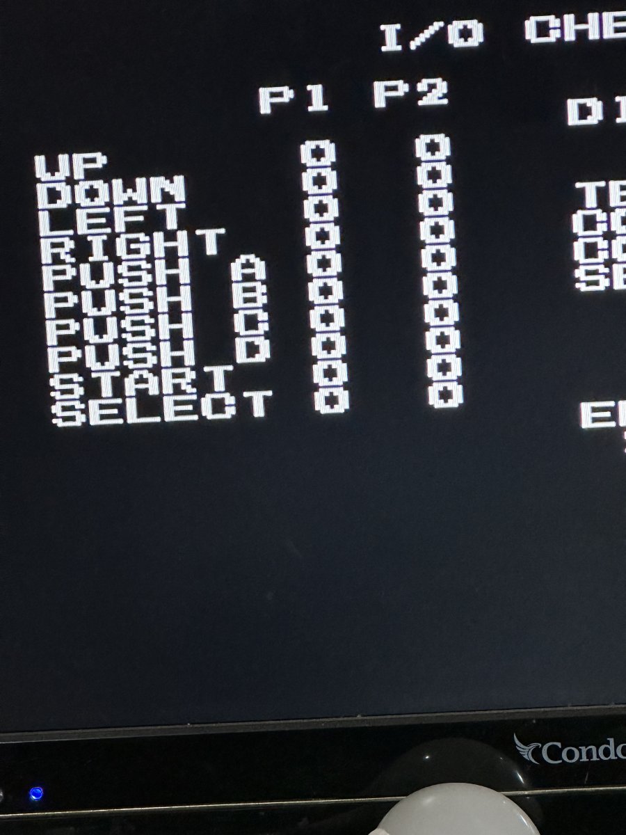

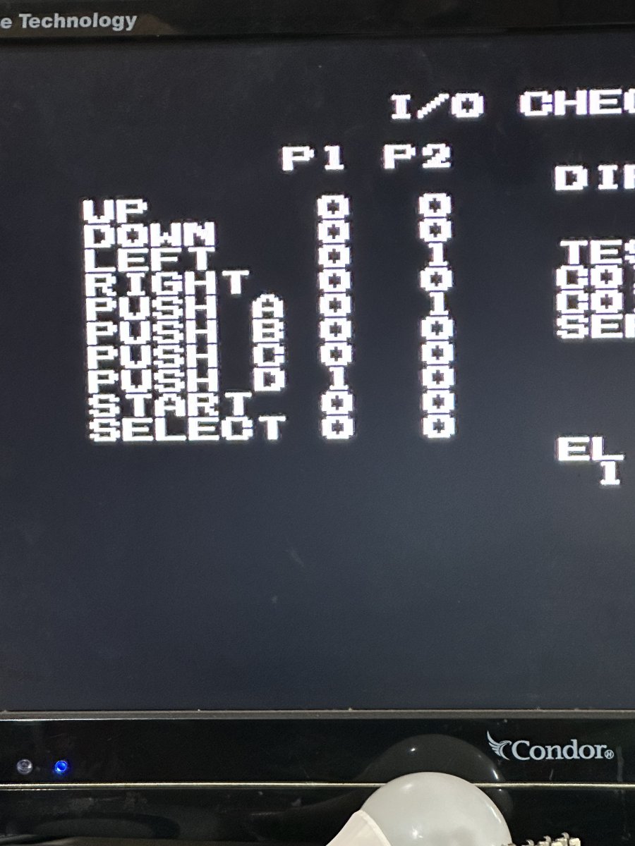

quick repair log about how to fix stuck inputs on mv1fz, this one had 3 stuck inputs.

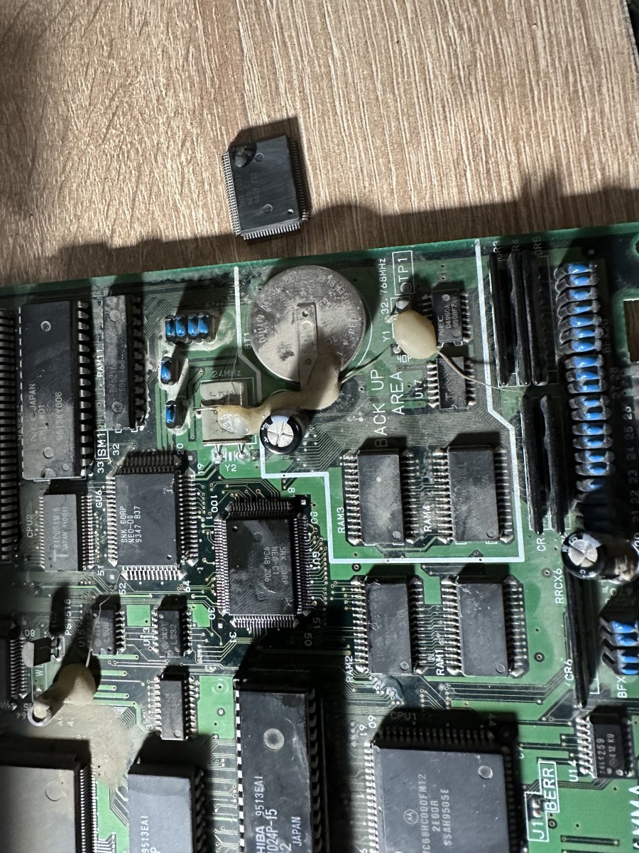

First : gave the board a visual inspection for any broken traces and there weren’t any.
Second : tested the arrays and they gave good readings
Third : traced the arrays to where they go to and they go to the NEO-C1 chip
Fourth : replaced that chip with one from a donner board
and that seem to fix the problem , all the inputs are back to normal.
