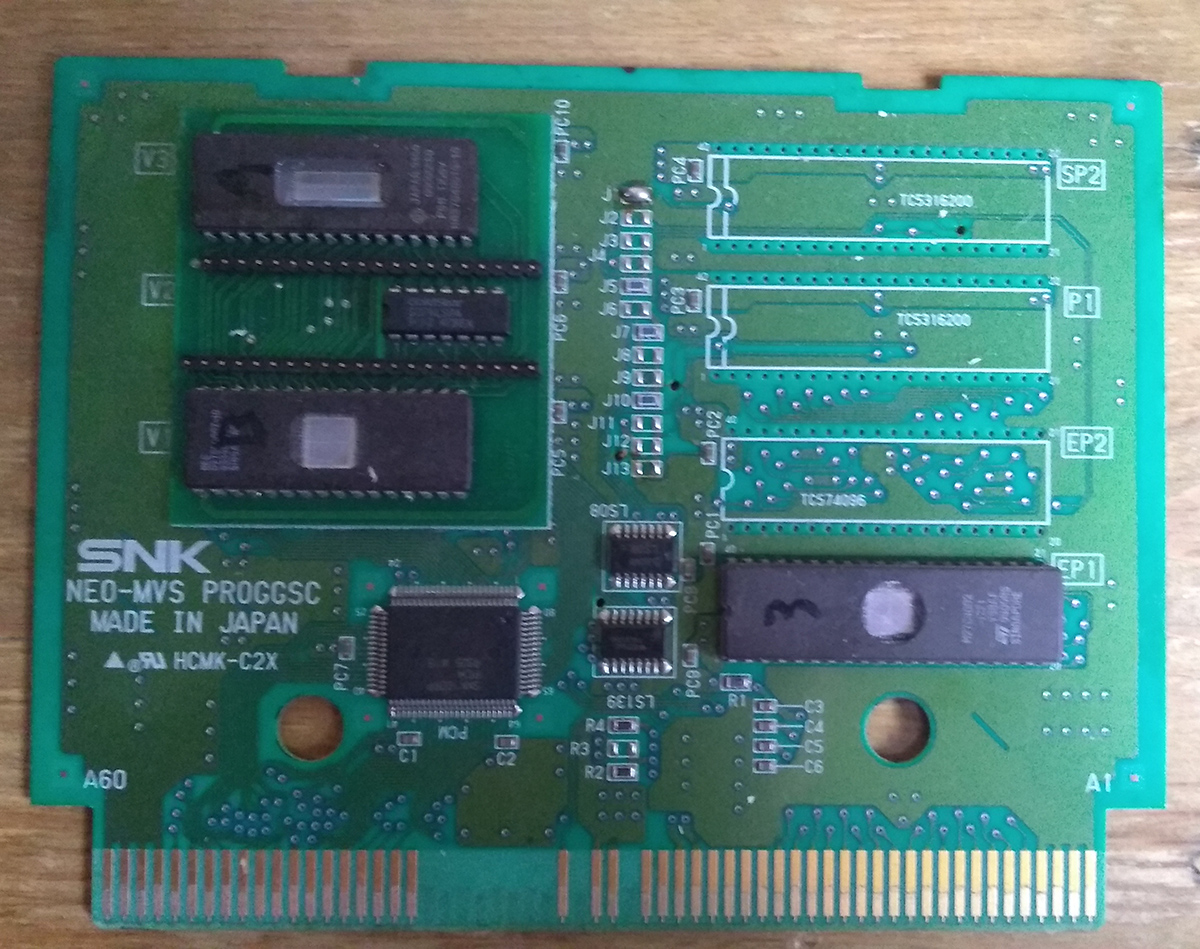

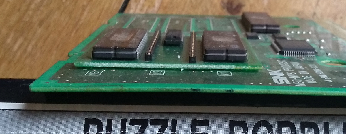

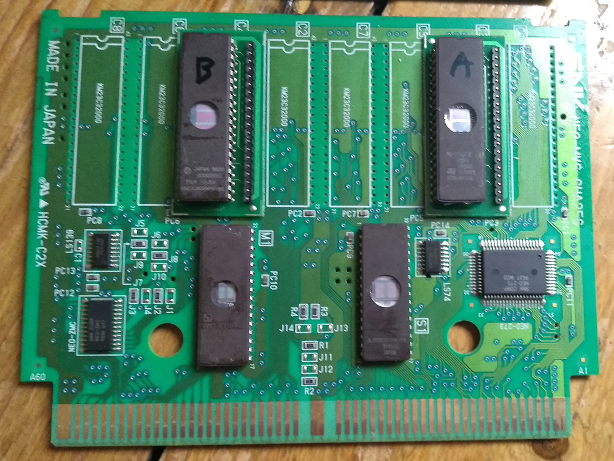

As mentioned in my other post I received a Puzzle Bobble cart as part of a job lot purchase and I'm sure this is a bootleg as you will see why in the pics below.
I tried searching for a thread here on bootlegs but couldn't find anything – does one exist?
Anyway, would somebody be kind enough to confirm this as a boot as the seller says he is "Very surprised at the dodgy cartridge as they would all have come from the same supplier."
Ha ha!

The EPROMs with a window are a dead giveaway. Originals will be Mask ROMs. There’s lots of bootleg MVS out there.

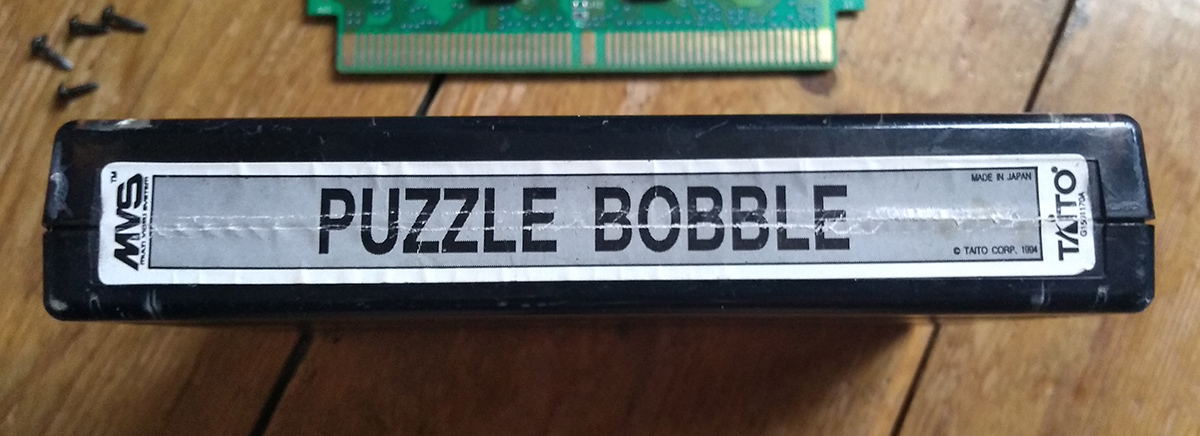

Unscrewing the thing was a dead giveaway as the screws were black and two short, two long – ha ha!
Just needed confirmation – I looked the boards up on MVS Scans. The other two in the purchase were legit.

Pretty sure a Puzzle Bobble with all mask roms doesn’t exist, Would love to see a pic of one.
I haven't personally seen one either, all mine have had at least one EPROM among the mask roms.
OP, You look to have a boot, but IMO more accurately a conversion, given it's on SNK PCBs. If you didn't pay a lot for it and it plays fine I honestly wouldn't sweat it much.

Yeah, doesn't bother me it's a boot – was kinda expecting it. I'm sure I read a while back that Puzzle Bobble is one of the most bootlegged MVS carts out there. Happy that the Metal Slug cart was legit :)
