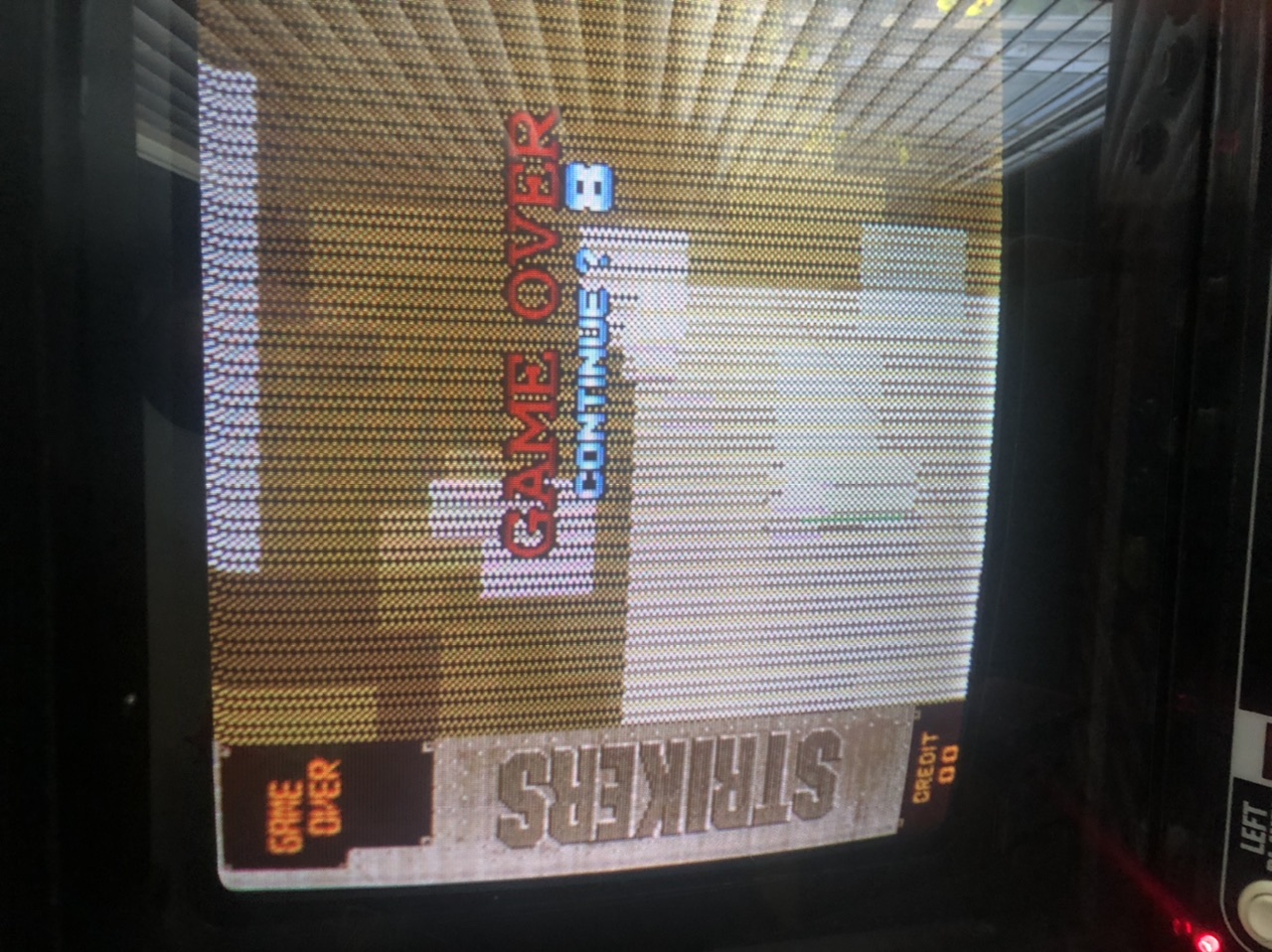

Strikers boots with garbled graphics sound and gameplay seem to work fine but moving sprites are bad. Reflowed all c rom pins per some fb advice, next step? Anyone willing to fix?

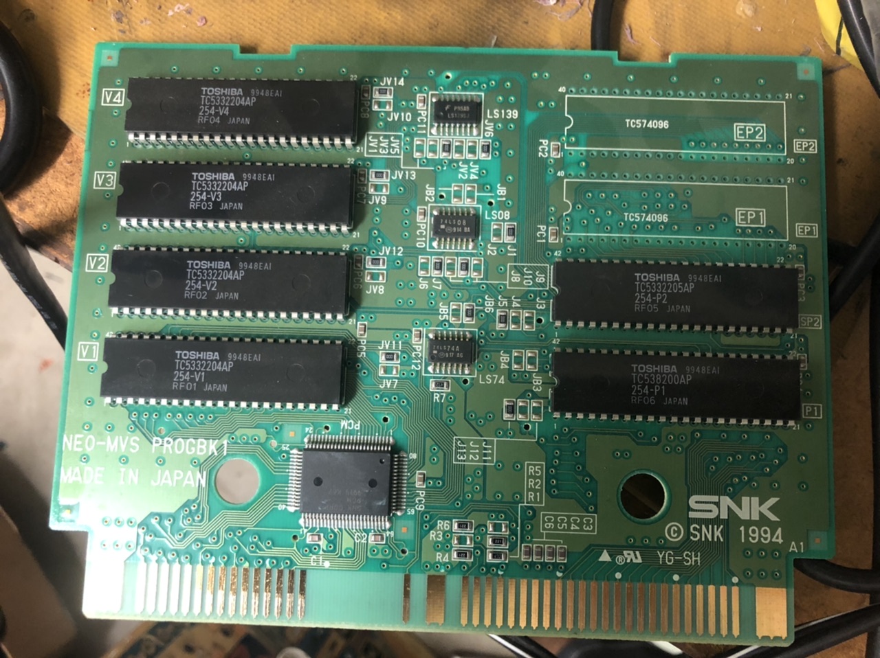

I can't see anything that is glaringly wrong. The worst case scenario is that you'll need to transplant the roms onto another CHA board.
Have you tried pushing the cartridge into the slot and then pulling it out for a couple of mm to make better contact? I have a Metal Slug X cartridge which only work this way.
If the edge connector is clean and undamaged, and the PCB traces are undamaged, and the solder connections are good and the ROMs are good then the only thing left that could cause a problem is the CMC... and if that's bad the only way to fix it is with another CMC from another Strikers cart.
I gotta say though, that edge connector LOOKs dirty, and I've had edge connectors that look clean end up being dirty enough to cause problems.
