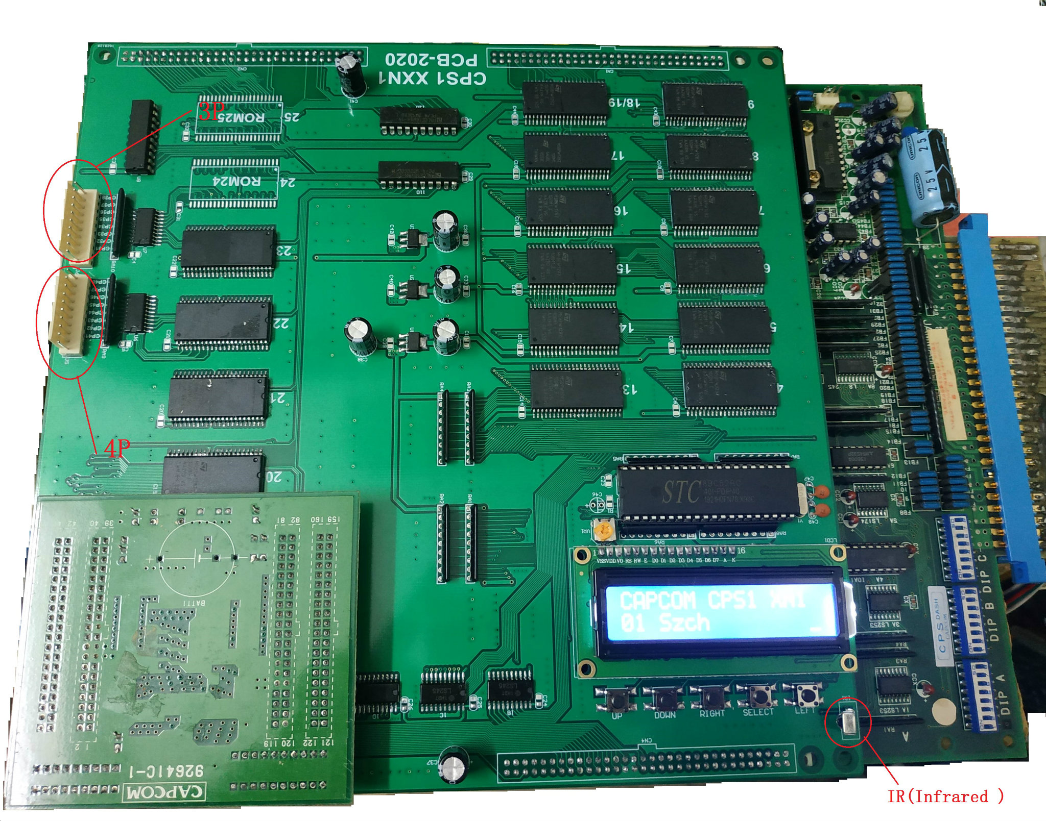

Not sure how the Lydz multi handles kicks, I assume on these 2 connections labeled P3 and P4

Street Fighter 2 games use P3. I tried all the pins on P3 and P4 on alpha/zero and they didn't seem to do anything.
