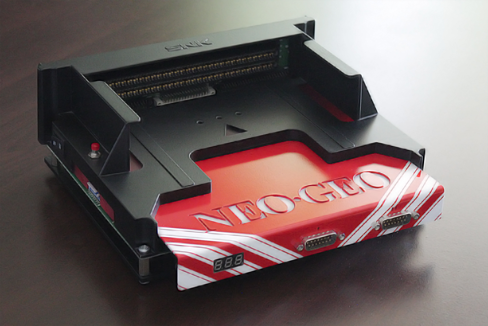

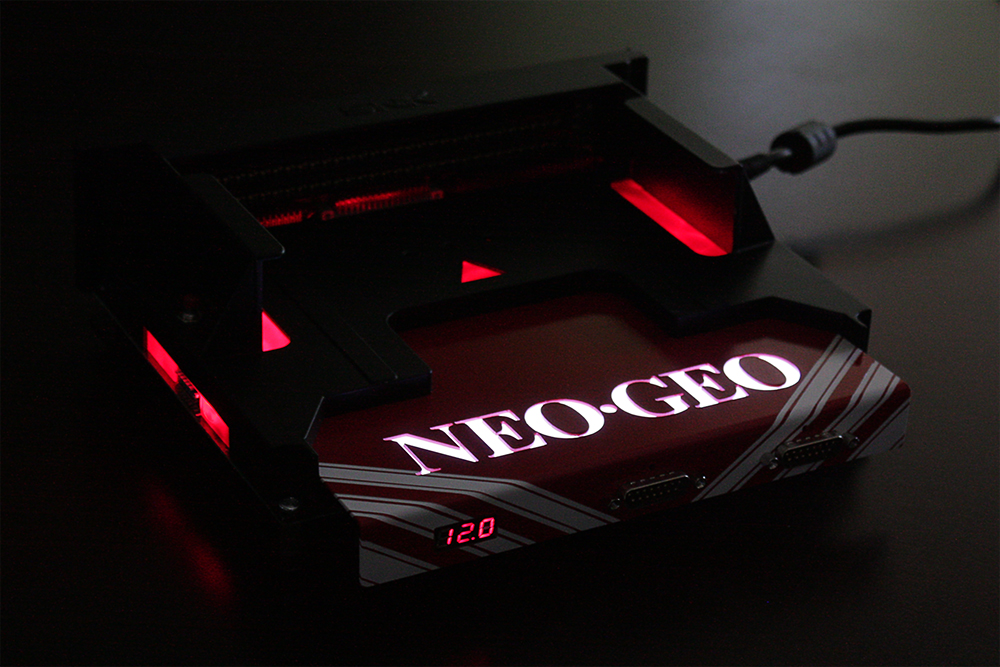

Here's my revised CMVS.
Now the question is: Gaming machine or nice bedside lamp. :D
I hope you like it... ;)

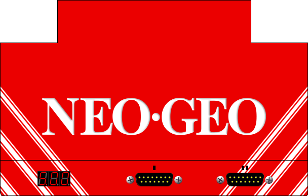

A new one was designed by using Adobe Illustrator:
Afterwards, the file was exported to AutoCAD by using the dxf export option (note: for future projects I recommend to realize the design straight from the beginning with AutoCAD because there are some compatibility issuses between Ai dxf an the 'real' dxf).

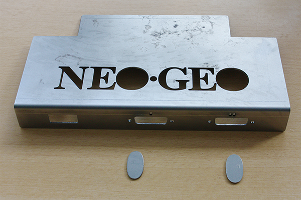

The new steel sheet was cutted (waterjet) and bended by a local metal construction company. I decided to go for 1.5mm thickness, because the original sheet metal (made of the housing of an old VHS recorder) was too flimsy (approx. 1mm thickness) and bended when a controller was pluged in.
Picture of the bare steel sheet:

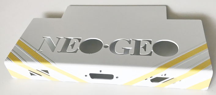

When it comes to painting, I'm relatively untalented. :) Therefore, I decided to ship the steel sheet to a member of the german circuit board forum and let him do the paint job.
WIP picture (no decals - only paint & duct tape):

If you own a MV-1FZ(S), you will recognize that there isn't much space between the PCB and the steel sheet when everything is put together. That's why I needed a very thin backlight solution for the Neo Geo logo.
First, I tried using an EL-foil with an inverter, but the results were not satisfying (the light output was too weak, the light was more blue than white, the inverter had the typical high-frequency humming noise). But luck was on my side and another member of the circuit board commuinty (he runs an online shop for LED backlights) sold me a prototype of a very thin and cuttable backlight (1.5mm thickness) that only needs 5V DC for operation (yeah, no additional inverter etc. was needed anymore!).
To protect the backlight from possible damage, I placed a 2mm thick milk white plexiglass between the backlight and the steel sheet.
BTW: The backlight possesses very uniform illumination, can be equipped with different LED colors and might also fit for mini marquees. ;)
The red backlight is made of common cuttable LED stripes offered on ebay etc. They need 12V DC and therfore I decided against a 5V only mod for the console. But I replaced the table power pack (5V DC 2A / 12V DC 2A) by a better one from wattac with more amps (5V DC 4.2A / 12V DC 3A). Just in case...
That's also why I installed a LED voltage display with a hidden On/On switch to toggle between the 12V and the 5V (yes, I know, actually it's useless on a CMVS but it's still a nice gadget ^^ ).

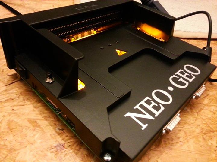

The 3 upper holes of the plastic enclosure (triangle etc.) are covered by red plexiglass (diffuse, 5mm thickness).
For the 2 holes on the side I had to 'get creative' (the space between the plastic and the electronic parts on the PCB is approx. 1mm). I took a translucent box of Mon Chérie (chocolate candy), trimmed the 2 parts to fit and sanded them to get the diffuse look.

The red momentary push button is for entering the test mode.

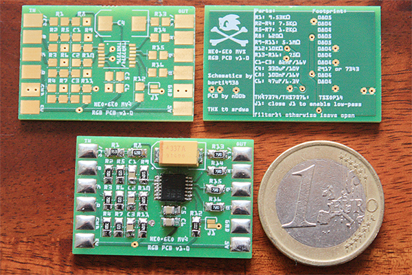

The MV-1FZ(S) doesn't output stereo sound. I decided to install a stereo mod (the MKL one) but I found no suitable small PCB designs on the net. Therefore, I decided to design my own PCB with SMD parts instead of THT (PCB files are public - OSHPARK.com or AISLER.net):
The CMVS outputs RGB via SCART connector with impedance matching RGB & Sync by using the following PCB (files are public - OSHPARK.com or AISLER.net):

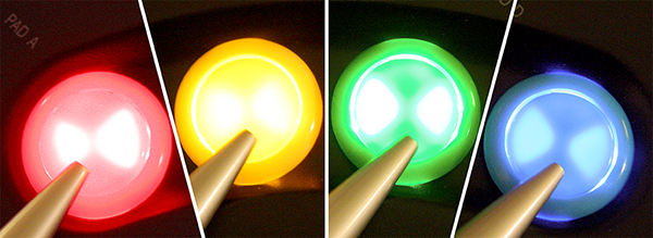

I modded my controllers, too. :) I use 2 identical Neo Geo sticks (the 'classic ones') with SANWA sticks and buttons. The buttons are equipped with LEDs (only visible when the buttons are pressed):
